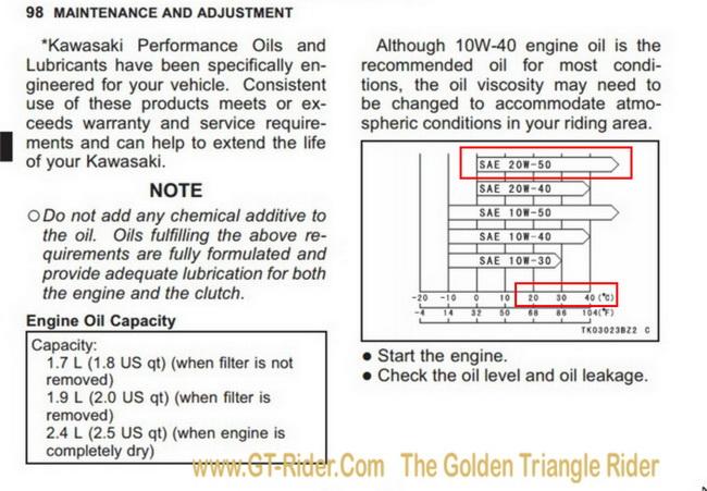

One of the problems with the Versys I found is the clunky gearbox when it gets hot.
6 weeks ago I swapped over to Mobil 20-50 motorcycle oil & I can say that there is a huge change - for the better.
Give it a go - the way to go in the heat here.

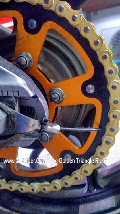

Davidfl;287686 wrote:
I've had two rubbish Thai DID chains on the bike
one was on there when I got the bike, wore out, & then I tried a 2nd Thai DID (because that's all I could get on the day) which only lasted 6,000 kms = 2 months.
But of importance was how quickly the chains literally seized up & "fell apart."
Both times I was in Nan coming back to Chiang Mai. I checked the chain in the morning in Nan & it looked ok - plenty of play & the Scott Oiler working.
The first time when I got back to Cnx the chain was as tight as a piano wire. Links seized & O-rings missing - all in a few hundred kms; & I just thought it was a hooked sprocket, never bothering to look at the chain as I never ever imagine a chain could shit itself so quickly!
Two months later, the same, leaving Nan in the morning I thought oops this chain too looks as if it could on the way out. Better take it easy on the way home. 100 kms down the road in Phrae I stopped for an inspection & sure enough some links had already seized up & some O-rings were missing. Unbelievable I thought. Shocked - twice now! Fortunately in Phrae I was able to source a 2,000 baht EK chain get it put on & carry on home to Cnx. The EK seemed to be quite ok, but I ordered in an RK chain from Japan to be safe & not get caught out again.
August 2013 I fitted an Ek Chain sourced from
Sangchai Panich
100/9 Kaew Nawarat Rd
the Honda Dealer opposite Prince Royal College
The cost 2,100 baht.
11 months & 25,000 kms later it has been replaced.
Now that's value for money guys.
Stay away from the Thai made DID chains, although the Thai DID box still says Made in Japan, thieving cheats!
The new chain is an RK RX Ring Gold chain.
Plus a Supersprox Rear Sprocket
Hopefully I'm good for at least another 18 months with this set.

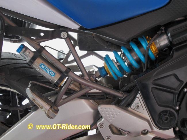

Davidfl;292736 wrote:
Well first trip away on the Versys with the new shock & what a ride it was.
The Nitron shock has transformed the bike. It now rides like it is on rails, firmly planted to the road, no wallowing or bouncing around.
Bumps & ripples it now just swallows up effortlessly, giving a plush ride.
R118 Chiang Mai - Chiang Rai is a road that's pretty ratty at the southern Doi Saket end, that has lots of patchy asphalt. With the Nitron shock on the Versys you hardly feel any of these.
The bike sticks to the road, just eating up any of those annoying bumps. I never thought I'd say what a good ride R118 is - but it is with decent suspension.
Even that nasty dip in the road on that big left hander, on the uphill, heading south of Mae Kachan - the Nitron shock just ate it up. Not even any wallowing.
Loaded up with cargo on the super sitting on 160 kph the bike again ran like it was on rails - absolute rock steady, giving a plush ride.
Yes sir the Nitron shock is an absolute winner.
Should anyone be considering a new rear shock for their Versys look no further than a Nitron from the guys at Nitron Malaysia.
Nitron is a UK company, specializing in suspension. The parts are engineered in the UK.
They have a plant in Malaysia where they assemble shocks for the Asian market. There's also another plant in Japan for assembling shocks for Japan.
The shocks come with a 2 year warranty.
By buying a "local" shock you only need to send the shock next door to Malaysia for a service / rebuild. I've had warranty shocks before that needed rebuild & had to go to Europe for free service - but sometimes took 3 months before I could get the shock back & I had to pay the shipping both ways. This won't be a problem if you are using Nitron Malaysia.
I ordered & paid for my shock from Malaysia, then got a Malaysian rider to pick it up, carry it to Hatyai & post it from there.
Another plus using Nitron Malaysia is that you will get a shock built to your specification. You won't be buying an off the shelf shock that "fits all."
Nitron Malaysia ask for your body weight & riding kit.

Continued...rebuilding my Nitron shock at Nitron Asia in Kuala Lumpur, Malaysia.
The shock ready for the treatment
First up then is to check it on the computer & see how it is performing.
The shock is connected up & way it goes getting a full work over
The graphs showing how it is under-performing
The shock is then disassembled, basically into 3 sections
Re-gassed & oiled + in my case new shims + seals.
The comment from Wei the engineer was that he had never seen a shock with such bad oil - your bike has done a lot of heavy work.
The shock is reassembled, then re-tested back on the computer to see if the performance is correct & up to spec.
First class service & every Nitron shock rebuilt in KL is tested before & after to make sure it is perfect!
Yoong the engineer who rebuilt my shock, has graduated from a Coventry Motosport University in the UK & genuinely knows his stuff as an engineer. Whilst in the UK studying he also worked part time with Nitron UK.
Thiam Long who was my original Nitron contact in KL is now back at the same Coventry Motorsport University & working part time with Nitron UK; & he too will eventually come back to Nitron Malaysia.
A couple of other guys from GTR have been in touch with Nitron Asia (Malaysia) for shocks.
I cannot fault their service & product.
Tay Long Wey is the director in KL & will look after all your enquiries.
Another Nitron shock for bikes.

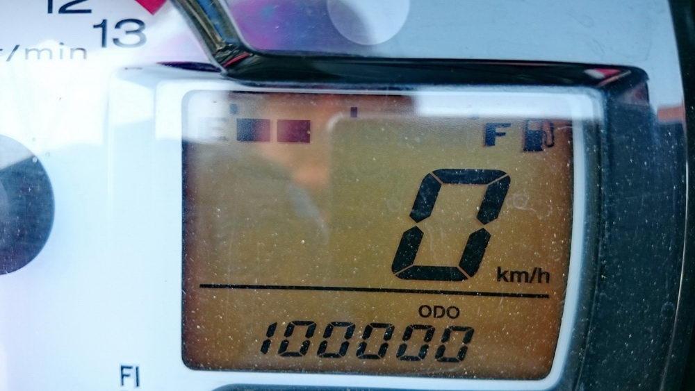

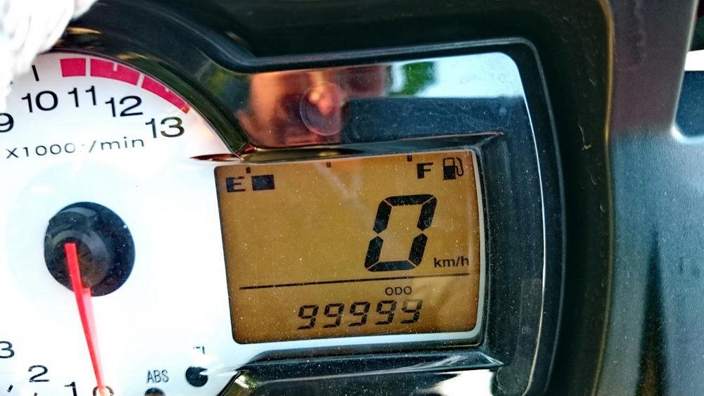

99,994 kms replaced the stator...so on the way home finally done it, clocked the Versys
AND now the bike is for sale.

Set up for touring.
Driving Lights. Nitron shock for a 100kg rider + 15 kgs of riding gear & luggage. Givi E21 luggage boxes. Sensational 5 tone electric horns. Scott oiler.
