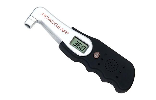

Oh yeah a tyre gauge. The best I've ever seen & used.
http://roadgear.com/digital-tire-gauge-p-40.html
Motorcycle useable functionality—90° valve head design fits even in the tightest spots, well clear of brake rotors
Functions through a 'double-bridge' smart-chip microprocessor—controls accuracy-compensating for ambient temperatures, humidity and altitude variations
Accurate to within ± 1% and measures 5.0-99.5 psi in half-pound increments
Pleasant voice reads the pressure out loud—audible reading can be repeated
Large digital display—easy-to-read—ultimate no-fuss tool
Replaceable lithium battery
Auto on/off
Five-Year Warranty
Yep it talks to you! Tells you what the pressure is. :p :thumbup:
But unfortunately I lost mine last trip, when I did not securely fasten the top of the Givi Side boxes.
And that is a slight complaint with the Givi E21s, you do need to double check that you have locked them securely.
Otherwise hit a bump & the top bounces open & out flies your gear if you're traveling at speed. Ive been caught out more than once.
I have now ordered two more of the above tyre gauge.

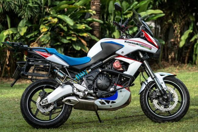

Well first trip away on the Versys with the new shock & what a ride it was.
The Nitron shock has transformed the bike. It now rides like it is on rails, firmly planted to the road, no wallowing or bouncing around.
Bumps & ripples it now just swallows up effortlessly, giving a plush ride.
R118 Chiang Mai - Chiang Rai is a road that's pretty ratty at the southern Doi Saket end, that has lots of patchy asphalt. With the Nitron shock on the Versys you hardly feel any of these.
The bike sticks to the road, just eating up any of those annoying bumps. I never thought I'd say what a good ride R118 is - but it is with decent suspension.
Even that nasty dip in the road on that big left hander, on the uphill, heading south of Mae Kachan - the Nitron shock just ate it up. Not even any wallowing.
Loaded up with cargo on the super sitting on 160 kph the bike again ran like it was on rails - absolute rock steady, giving a plush ride.
Yes sir the Nitron shock is an absolute winner.
Should anyone be considering a new rear shock for their Versys look no further than a Nitron from the guys at Nitron Malaysia.
Nitron is a UK company, specializing in suspension. The parts are engineered in the UK.
They have a plant in Malaysia where they assemble shocks for the Asian market. There's also another plant in Japan for assembling shocks for Japan.
The shocks come with a 2 year warranty.
By buying a "local" shock you only need to send the shock next door to Malaysia for a service / rebuild. I've had warranty shocks before that needed rebuild & had to go to Europe for free service - but sometimes took 3 months before I could get the shock back & I had to pay the shipping both ways. This won't be a problem if you are using Nitron Malaysia.
I ordered & paid for my shock from Malaysia, then got a Malaysian rider to pick it up, carry it to Hatyai & post it from there.
Another plus using Nitron Malaysia is that you will get a shock built to your specification. You won't be buying an off the shelf shock that "fits all."
Nitron Malaysia ask for your body weight & riding kit.
"Would it be possible for you to provide me your weight and any pillion weight (if applicable) or luggage?
The hydraulic preload adjuster (HPA) is an optional choice for customer. It allows for simple and immediate adjustment of preload without the need for any tools.
This system eliminates the time and effort usually associated with dynamic changes in the motorcycles attitude when adapting to ride with a pillion or luggage. It features 50 clicks of fine adjustment and cost only MYR 750. If you would like your shock to comes with the HPA, please let me know."

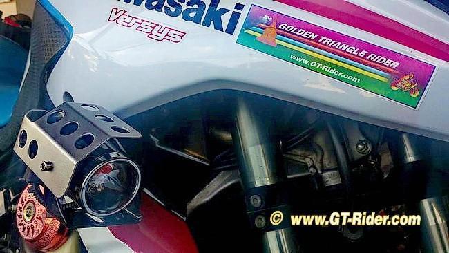

Davidfl;294072 wrote: a bit more again...getting ready for high season, cool weather & clear blue skies.
Extra driving lights
3,500 baht fitted at Cnx Moto Gear.
Those look good!
I manage to find Samji SJ-602 what are 6 tone and SJ-302 what are 3 tone horns.. but.. they are HUGE!! are your current horn same size as these Samji horns?

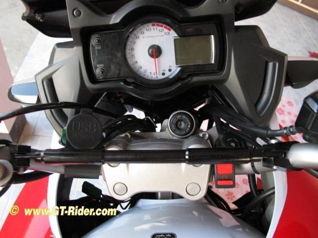

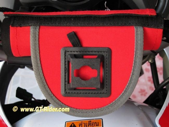

Another couple of bits for riding season.....
1. A small cross support bar on the handle bars
fitted so I could add a Rough & Road Handle Bar Pouch.
a bit of a "dolly bag" I'd say, but very handy for phone & camera easy access.
The bag clips on & off the velcroe-ed handle bar mount.

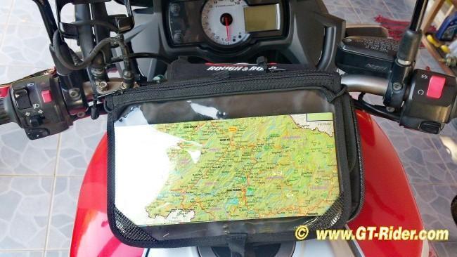

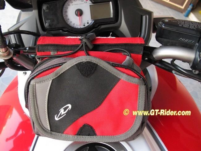

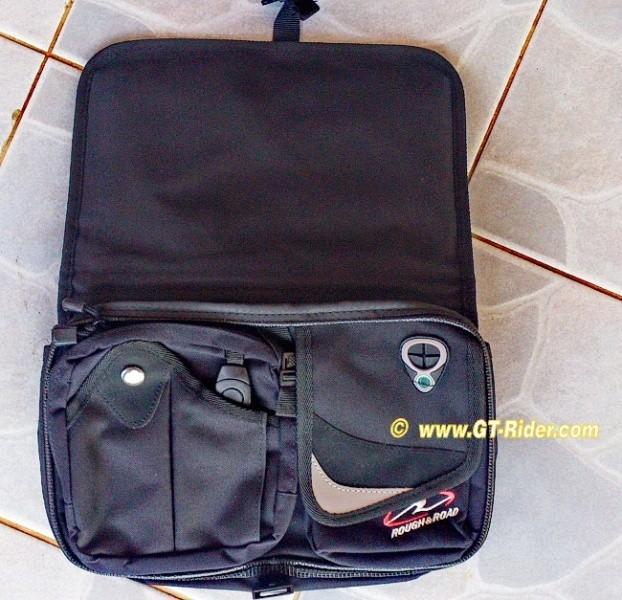

800 baht poorer & Ive picked up a Rough and Road handle bar map pouch 'n bag.
a trick little piece of luggage I thought
can double as a carry bag
enough pockets for any amount of make-up & gadgets.
Hopefully a worthwhile investment.
Lets see how it performs in the coming weeks.

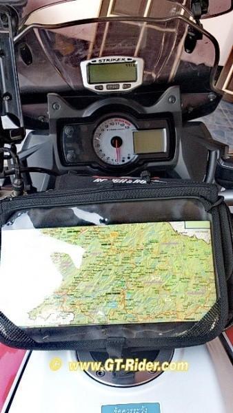

brake034;297689 wrote: David, e-mail send for the bigger handlebar bag.
Marcel
Reply sent. I can EMS to you. Happy to get my money back. 800 baht.
It's a real trick bag, but too big for me. Tried it once, but love the smaller one.

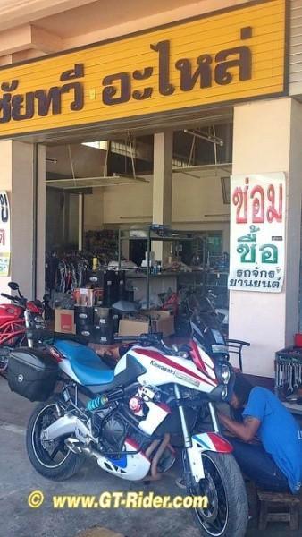

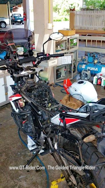

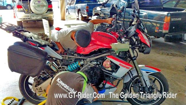

Recently in Nan for an overnighter to catch up to friends.
Business done & after brekky at my favourite Hot Bread hopped on the bike, fully kitted up to head to Pua & it would not start.
Damn. An electrical short I thought - possibly in the emergency kill switch as there was plenty of electrical power & the starter was turning over well, but nothing was happening.
I sat down, took a break read the paper & tried again several times - hoping for the best.
The previous night here had been a huge storm with torrential rain whilst dining at the Sanian Riverside restaurant & the bike was well & truly waterlogged out in the rain.
After numerous starting attempts the battery was starting to tire.
Next step for me then off to the Kawa dealer just down a km the road, but before I push the bike there better to check that the mechanic will work on the bike for me straight away.
I borrow Hot Breads scooter & pop over to Kawa - the mechanic is at lunch. Please come back after lunch.
Back to Hot Bread, return the scooter & I saunter off to check out a couple of temples to kill time.
1.15Pm borrow Hot Bread's scooter & back to Kawa - the mechanic has gone out on an emergency call, please come back again later. Hhmmh - it could be one of those days coming up.
Back to Hot Bread & for something to do I hit the Versys starter once again & it fires up like new & idles perfectly.
Good luck - must have been water in somewhere just as I thought?
So kit back up & head over to Kawa to pick up a can of WD40 & let the mechanic know - never mind.
Back on the bike to head to Pua & the bike won't start.
Oh shit. But perfect I thought; just how I needed it right at the Kawa shop & in the workshop.
20 minutes later Kawa drop me & my luggage back at the Dheveraj hotel to check again & let the mechanic do his thing at his own pace.
to be continued..

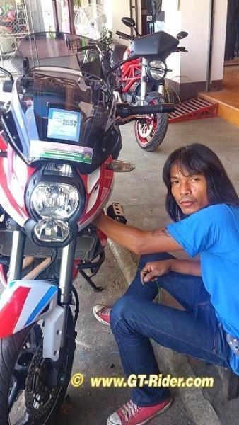

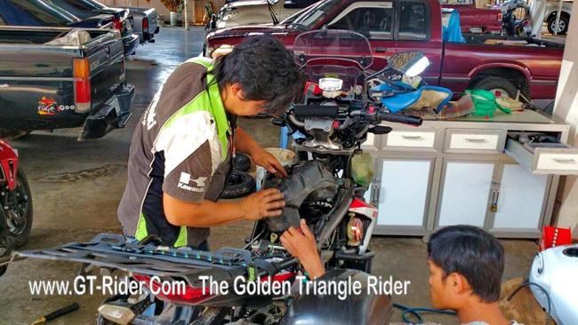

4.30Pm & I popped back along to Kawa hoping for some good news.
I was somewhat surprised then when I saw the fuel tank from another bike on my Versys.
The mechanics looked up & said petrol no good.
They fiddled a bit longer & connected a few hoses & lines & hit the starter button & she fired up perfectly.
Your petrol no good - very very dirty. Fuel line blocked + one dodgy sensor connector.
Who was I to argue, the bike was running beautifully.
I was shown a bowl of black sludge that came from my tank & fuel lines & asked where did I fuel up last - well it was at the Shell on the Lampang bypass road. Petrol no good was the reply.
What the heck it got me that far I thought - Lampang - Phrae.
But now I remember that in the last couple of months I have fueled up twice in Thoed Thai, plus once at Lisu Lao Ta's drug financed petrol station north of Tha Ton; & that my friends is where I suspect the problem comes from - two low class petrol stations.
As the time was close to closing the mechanics asked me if I wanted the bike that night or tomorrow. I said I preferred that evening, to which they complained it would be a rush job to get it all back together in 45 minutes, so they could go home on time. OK I relented take your time & do it properly - see you at 9Am tomorrow morning. And so it was. The old Versys is running perfect yet again.
The moral of the story for me
1. Take care where you fuel up.
2. Don't run your fuel tank all the way down close to empty, like I have been doing - sucking all the crap & dregs through.
19
^ Ha! I didn't even know there's a Kwacka dealer in Nan! And that's an EX650 tank they've got on your Versys, but I guess the plugs are the same, so why not!
Like you say, it's not a bad idea to fill up often- at least this way, when you do get some dodgy gas you don't have a full tank of it and you are soon diluting it with good. The Pollution Dilution Solution! :mrgreen:
Ride on!!
