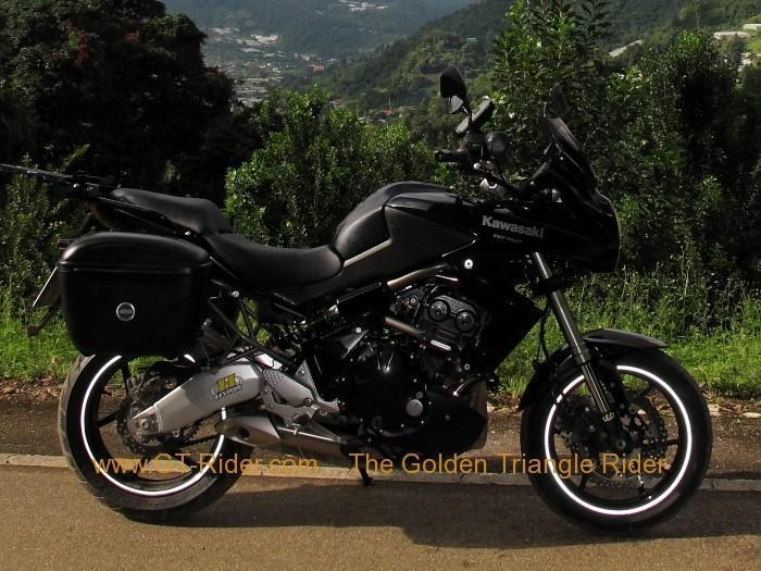

The bike started off like this

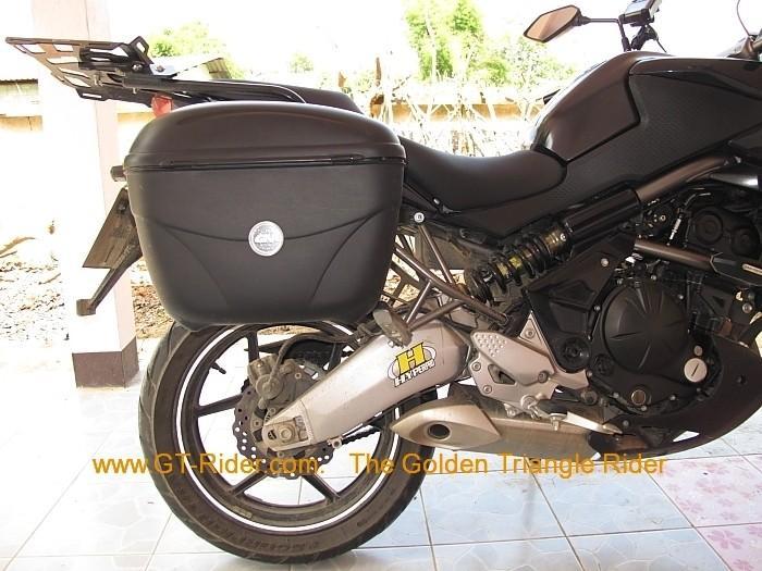

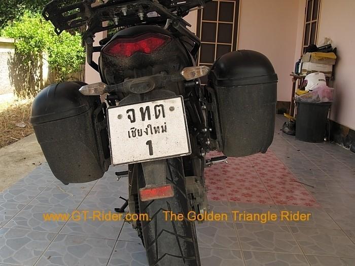

The first extras were the Givi E21 side boxes
to end up looking like this
looking terrifically black, which does not appeal to me or IMHO look good in photos.

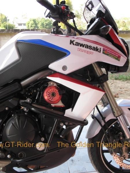

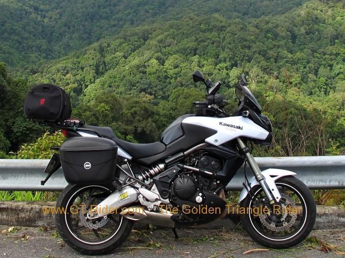

So next up was some white plastic
plus Motech rack & soft bag on the back.
still not colourful enough for photos it was time to add some stickers
plus super duper loud 5-tone horns from Vietnam

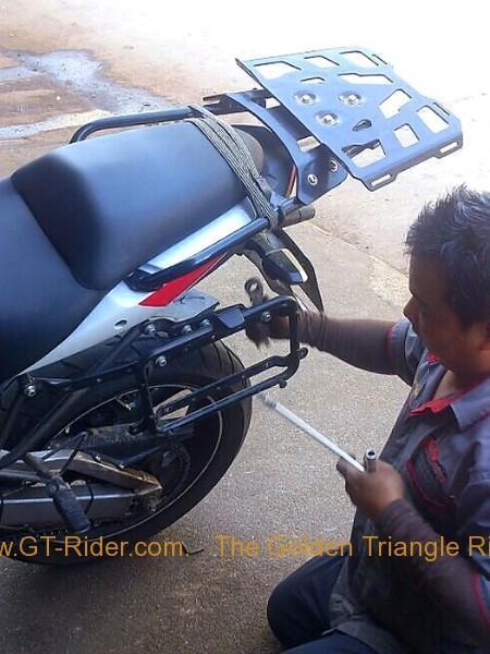

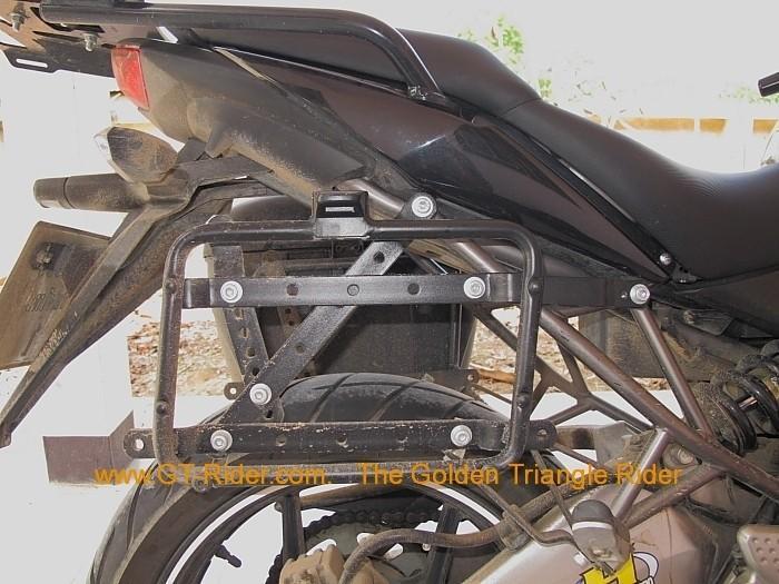

Then I decided that the side boxes were mounted a little too far forward , so had them mounted a little (too) further back.
I actually want to move them forward a bit now.
And none of this experimenting is a problem in Chiang Mai / Thailand, just pop along to your local bike engineering shop (Somchit's - Dang Glong Pratu) & its generally done on the spot & cheaply.
You couldn't do this in the west without it costing you an arm & a leg!

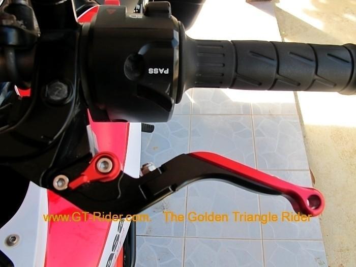

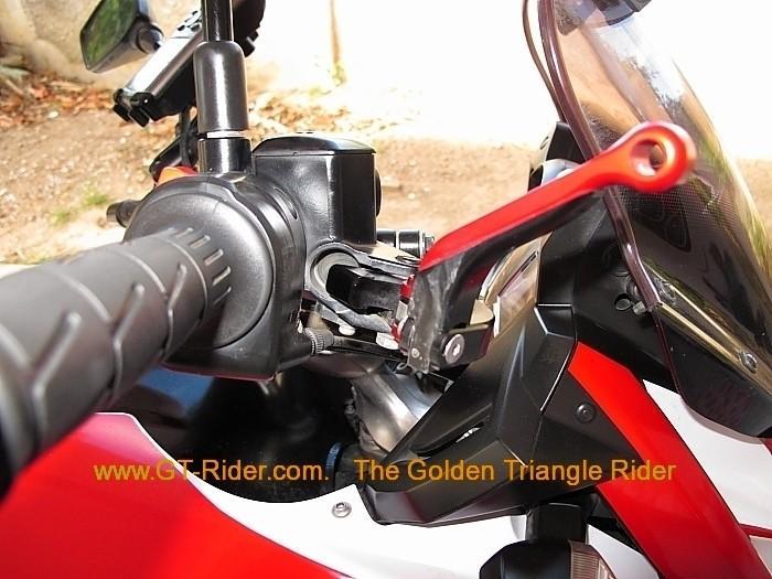

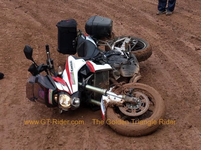

a backwards spill / slide in the mud-clay on Doi Phukha brought me down & broke off the end of the front brake lever.

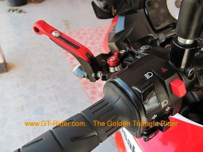

new trick folding / flick up levers went on next
these levers feel so good in your hands, that I wonder how I ever rode the AT for 320,000 kms with standard levers, although I only went down once with the AT.
They are highly recommended.

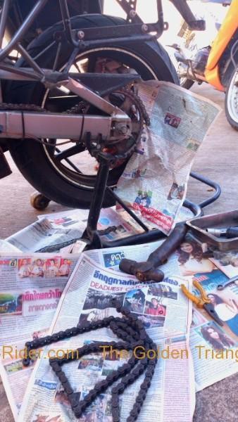

I've had two rubbish Thai DID chains on the bike
one was on there when I got the bike, wore out, & then I tried a 2nd Thai DID (because that's all I could get on the day) which only lasted 6,000 kms = 2 months.
But of importance was how quickly the chains literally seized up & "fell apart."
Both times I was in Nan coming back to Chiang Mai. I checked the chain in the morning in Nan & it looked ok - plenty of play & the Scott Oiler working.
The first time when I got back to Cnx the chain was as tight as a piano wire. Links seized & O-rings missing - all in a few hundred kms; & I just thought it was a hooked sprocket, never bothering to look at the chain as I never ever imagine a chain could shit itself so quickly!
Two months later, the same, leaving Nan in the morning I thought oops this chain too looks as if it could on the way out. Better take it easy on the way home. 100 kms down the road in Phrae I stopped for an inspection & sure enough some links had already seized up & some O-rings were missing. Unbelievable I thought. Shocked - twice now! Fortunately in Phrae I was able to source a 2,000 baht EK chain get it put on & carry on home to Cnx. The EK seemed to be quite ok, but I ordered in an RK chain from Japan to be safe & not get caught out again.

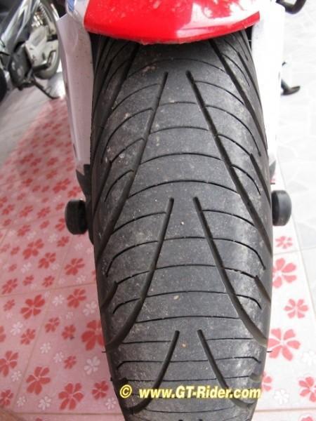

TYRES
I've had Pirelli Scorpion Trails, Michelin Pilot 3s & now Avon Distanzia tyres on the bike.

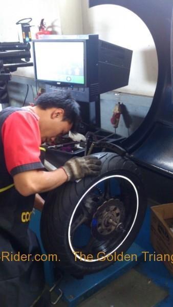

I try to get all my tyres from Cockpit Sai Neua, on R108, past the airport & just after Tesco Lotus.
Their service is first class, plus they will balance your wheels for you at the same time.
Plus free aircon, coffee . TV & wifi while you wait.
I've been highly impressed with the Pirellis on the AT & the Versys - excellent mileage, road holding, feel in the dry & WET.
BUT you can never get them when you need them - appalling importer service!
So I thought give the Pilot3s a go, why? Because my plan was to ride the Versys on the asphalt. However after just one short dirt excursion on easy gravel I felt as if I was just riding on marbles. No thanks.
Back to Cockpit & asked for some other tyres.
Avon Distanzias were available & 1,500 baht cheaper than unavailable Scorpions.
Right now the Avons are only 1,000 kms old, but I do like them - lots of feel, road holding, good cornering & quick steering. Plus no complaints on any loose surface. How long they last & go in the wet remains to be seen.
Just a note on the Pilot3s, I thought around town they felt very neutral with little feeling, however the faster & harder you went the better they felt & performed. But the extra performance only seems to kick in at approx 115kph+ & for me most of my riding in the mountains is not at that speed. You just need to ride faster & harder to really get the most value out of the Pilot3s.
The Pikot3s will go back on at the start of the wet season & a big thanks go to Cockpit for holding the tyres in their shop for me. Cant ever complain about their service!

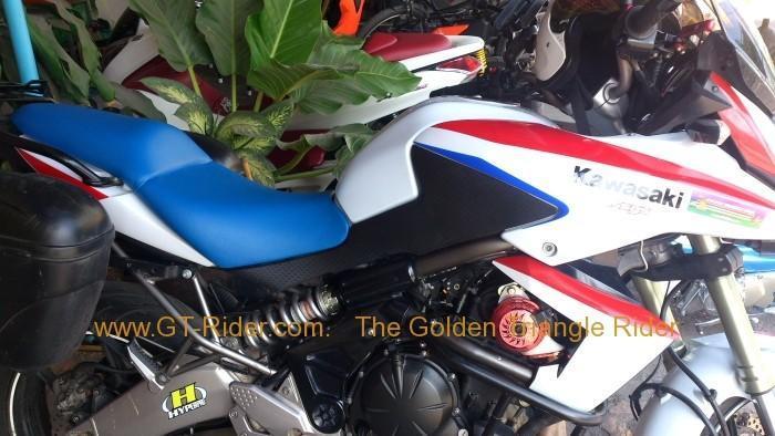

Next step was a bit more bling, & a bit over the top some of you are saying.

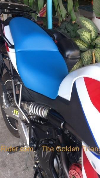

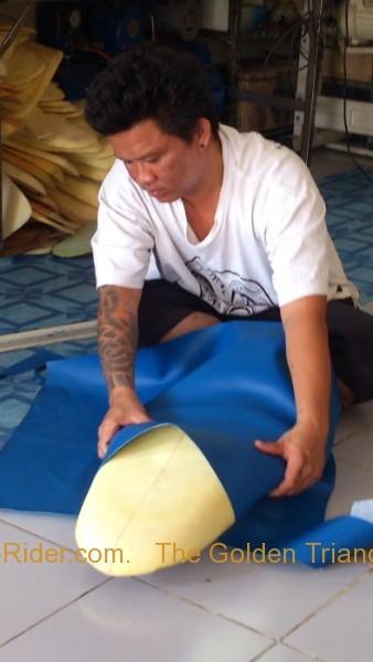

THE SEAT
a new cover
the seat has not yet bothered me enough to warrant repacking, so it was only a new cover.
650 baht at Sompong's on Chotana Road.
the colour was supposed to be a dark navy blue to march the dark blue stickers on the bike, but this colour was as close as we could get.
A bit too bright perhaps..
but for me it's better than dull black.

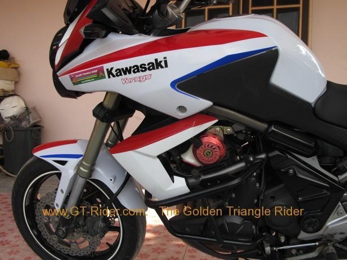

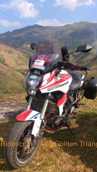

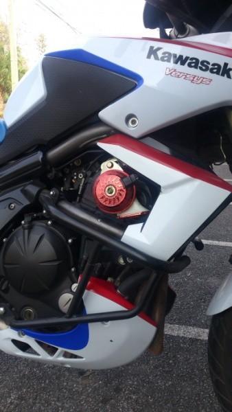

and today was perhaps the last little colour tweak
replace the black plastic belly pans with white stickered ones
I let the sticker guy please himself what he did.
It's not quite how I would do it, but go with the flow is the easiest way.
The MarkII version will be better.

My favorite thing about your bike are those amazing Vietnamese air horns! I'm going to have to ask VietHorse if he can mail me a set!

You can see the Vietnamese air horns in David's pictures:
attachment.php
attachment.php
They are quite loud make an indescribable warbling sound- definitely will catch the attention of anyone within earshot!

When riding with David last weekend.. Amazing how people and animals get out the way..
Also have the levers as well.. Much nicer feel than the original.

Thks David.will b checking out on samjihorn. Also one more thing to ask if u don't mind.the clutch lever looks n useful in case the bike topples over. Where do u get those? M not using those as I have a pair or zeta hand guards and proved its worthiness in Khao sok national park when my bike topples over. Also the hb engine guards does it job well.the lever comes in handy n the colors are nice.
14,753
5,585
tehsk30;287727 wrote: Thks David.will b checking out on samjihorn. Also one more thing to ask if u don't mind.the clutch lever looks n useful in case the bike topples over. Where do u get those? M not using those as I have a pair or zeta hand guards and proved its worthiness in Khao sok national park when my bike topples over. Also the hb engine guards does it job well.the lever comes in handy n the colors are nice.
Levers came from Piston Shop in Chiang Mai.
But just google "folding motorcycle levers."
Here's the 1st website that comes up
http://www.tobefast.com/fp-racing-m-2866727.html
Aug 25, 2012
96
I've dropped my bike a couple of times (alright, 3 to be exact) and no damage whatsoever to levers (Ascerbis hand guards). Admittedly, all the drops were pretty much 0 kmh drops but aren't handguards supposed to protect the levers? Apart from aesthetics, what other advantage of changing from the stock levers?

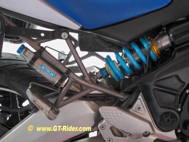

Finally fitted the Nitron Rear shock
The final price ex Malaysia: RM2,660 = approx 25,700 Thai baht.

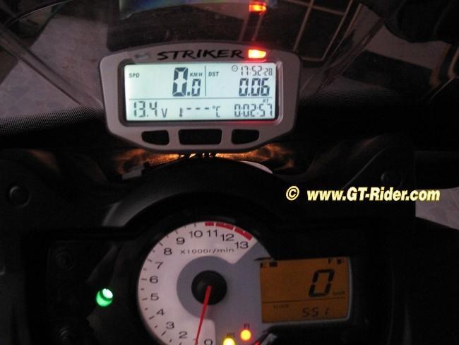

The Trail Tech Striker gauge is also fitted, but appears to be faulty
I will buy & fit another one. I like the temperature gauge & voltmeter to monitor what is going on.

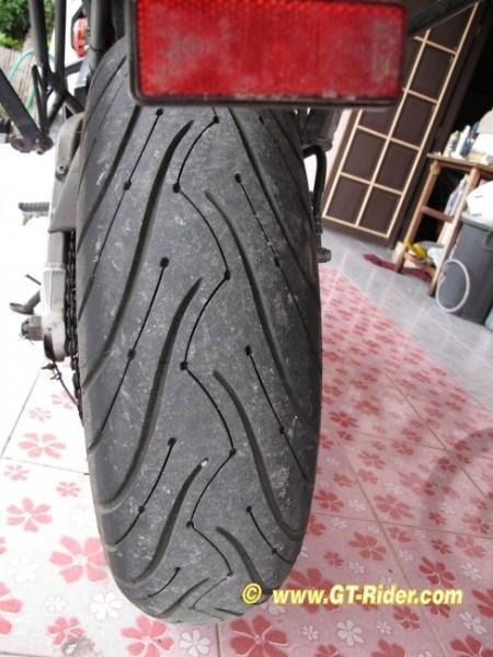

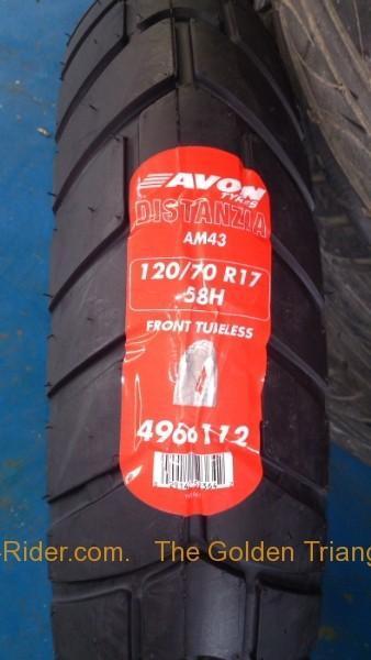

The Avon Distanzia tyres that I liked so much only lasted 10,500 kms.
Last trip in Laos just completed, I checked my tyres before I left & considered there was a third left - ok for a 2,000 kms run through southern Laos, so I thought.
But it seemed as if the last third wears out a lot faster & I needed a new rear tyre to get back to Cnx.

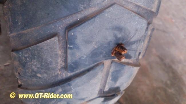

In Savannakhet I noticed what looked like a nail in the rear tyre, popped into a car tyre shop & asked them to pull it out to be safe & they said NO its not leaking. You can go 400 kms to Vientiane. NO I insisted pull it out. So they did - & - WHOOSH out came the air & down it went immediately.
The culprit.
The tyre lasted to Vte & in Udon Thani I got a new Scorpion trail rear from the Kawasaki dealer.
Back in Chiang Mai I popped along to Cockpit & swapped back to the set of Michelin Pilot 3s I had stored.
these will do me for the wet season & then it is back to the Pirelli Scorpion Trails.
I've since decided that Pilot 3s are not what you need for touring North Thai & Laos, where you often get kms of greasy road works.
IMHO Pilot 3s suck on any dirt, let alone snot. You guys in Bkk can ride with them, but not me up here.
Pirelli Scorpions or Avon Disatanzias are the way to go.
The Avons are approx 1500 baht cheaper than the Pirellis but the rear only lasts 10,500 kms as opposed to 15,000 + for the Pirelli Scorpons.
The only problem with Pirelli is stock / supply.They are nearly always out of stock, which is very disappointing - poor importer service - especially considering the scores of Versys that must be on the road.
