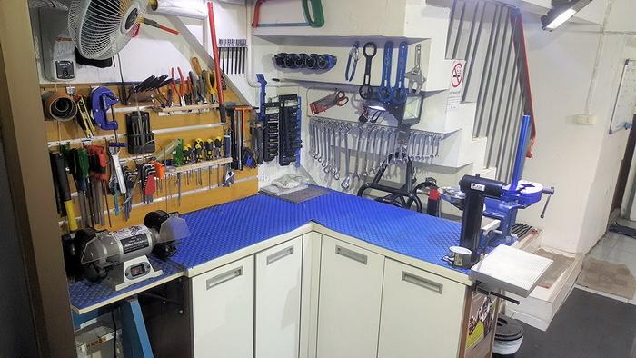

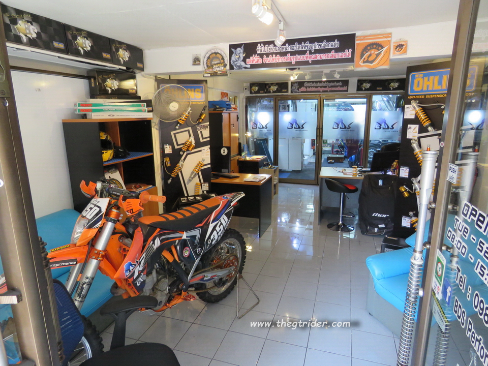

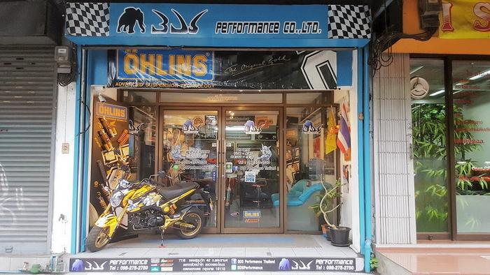

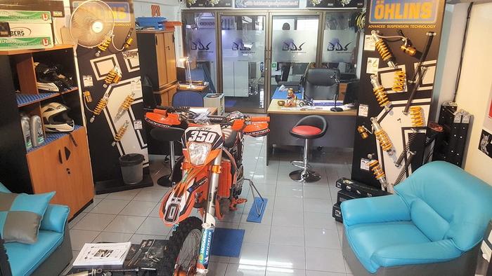

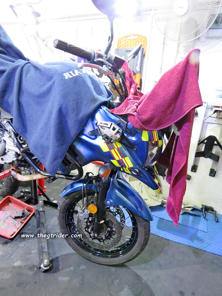

Updated BDS Performance photos
Spotlessly clean
Organized
Check em out for setting up your bikes suspension.
I can't recommend BDS Performance enough for rebuilding & setting up your suspension.
Brad at BDS is a genius & 5-star professional who will find multiple errors in your set up, linkage & then fix it all.
Absolutely top-notch service & full-on professional advice.
They have a nice comfy aircon shop for you to sit & relax
Check em out

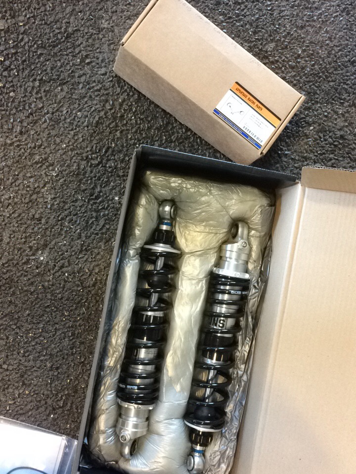

Installed Ohlins suspension yesterday - CRF250L 2017 - FSK123 front and HO729 rear.
Amazing difference.
Setting the sag a major PITA - removal of subframe and airbox fixed that.
Ohlins has a neat app for your fone - dials in the sag and compression and rebound damping.
Will ride a couple thousand K and get 'er broken in.
Amazing difference.

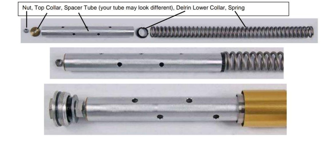

The Sags are dictated by the front, often times on the CRF models....

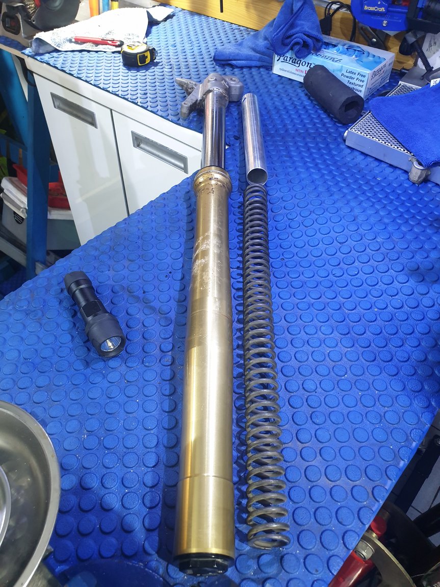

For many customers the 8.5n/mm single spring is just not enough for the upgrade or the Riders Weight.
BDS Performance has the kits' to ADD a spring to the other Fork Side, to increase the spring rates and overall responsiveness and added dampening/ response.
You can always send us your forks, as many customers are in your same predicament, and can't get to the shop or have it squated properly.
Cheers, and Happy Trails.
My Staff just found the Pictures and a Similar Kit to our own Modification Kit and Spring that works in conjunction with the Ohlins FSK123 for all the CRF250 series, that have only single springs.
Thanks Brad
