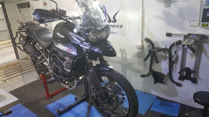

Ok. I couldn't find anyone to fully service my WP suspension on my Triumph Tiger 800 XCx after 40,000km. The rear shock had gone weak and was not very fun 2 up with the cases load. Britbike can service the forks (by service I mean change the oil and seals) but not the shock. Basically have to send the shock back to the mother ship and park the bike forever for it to return. Not possible for me in peak riding season...
I contacted Brad at BDS Performance in BKK. After lengthy discussions via email, phone and in person we decided Wilbers was the best option for my situation. Wilbers shock with full adjustability and Wilbers springs in the WP forks keeping the WP cartridges as Brad recommended that they are top quality already. Brad custom ordered the springs and shock to suit my requirements and Wilbers custom built the shock as specified. Brad did his magic and the first time I sat on the bike I could feel the bike was totally different.
I now have 2,400km on the bike with the new suspension and I'm tickled pink with it. I normally ride with a fairly heavy load solo and the bike feels incredible. I ride about 50% of the time 2 up with the wife and cases loaded and it's amazing now. I asked my wife if it felt any better and she said 10,000 times better. Happy wife makes my life easy. I think having a hydraulic preload option if you change loads often is the best thing since sliced bread.
Great service from BDS Performance.

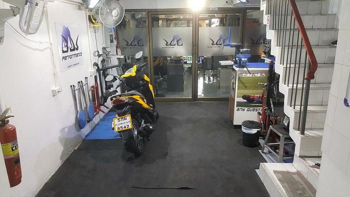

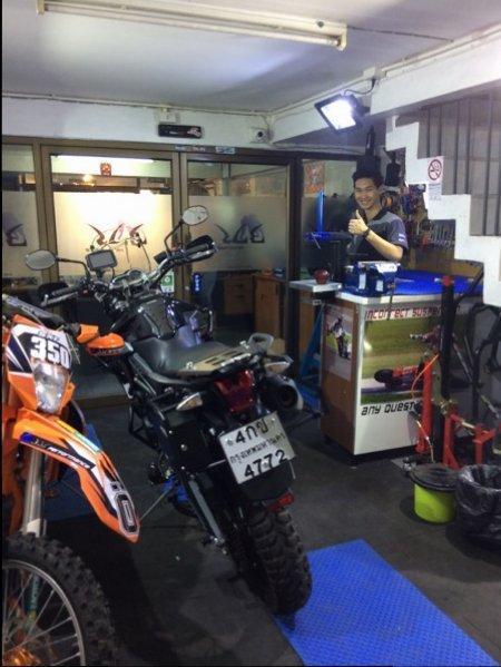

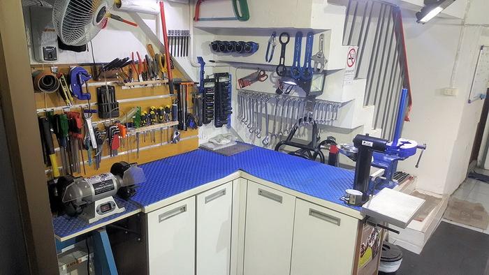

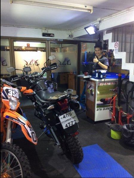

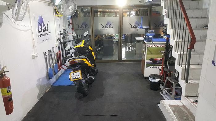

Updated BDS Performance photos
Spotlessly clean
Organized
Check em out for setting up your bikes suspension.

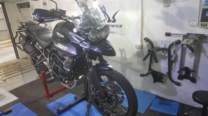

The Triumph Tiger was a great build! We thank our fellow GT Rider for the opportunity to provide the service he needed! Wilkbers was a bit (at first) argumentive with the Spring Rate and for a Dual or Progressive Rate: but when it was finally agreed upon and delievered..... it came together, beautifully!
It was everything we wanted and more..... We also changed the front fork WP cartridge springs and mixed our own Synthetic Ohlins Racing Oil which came out to the proper Viscosity (another discussion with a manufacturer) to produce the Ultimate Single and 2up tourer for our happy Veteran Rider!
The Wilbers custom Made Shock, we hit the Sweet Spot with very little Pre-load tweeking on our part. The Remotes installed fairly effortlessly and we established a good Static and Dynamic Sag with our rider within an hour or so......
Kudos to Our Rider for helping us, help him, design his Signature Series Suspension for The Tiger XCX now shredding up the motorways and paths, here in Thailand Riding!

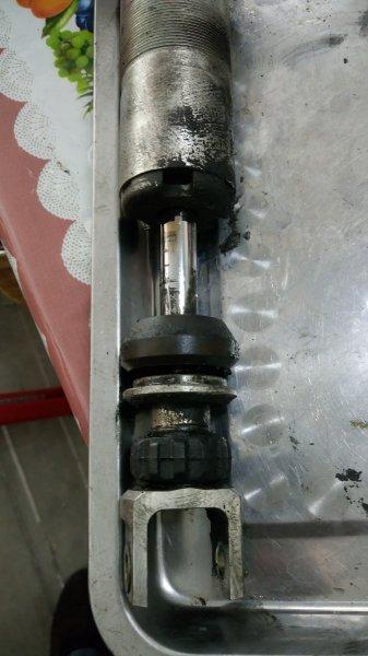

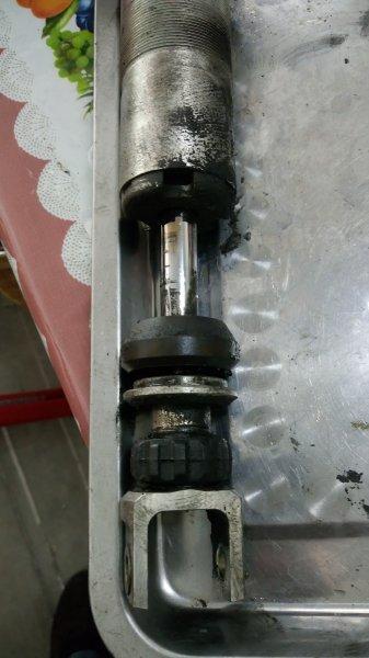

Some progress...after a phone call from Ohlins Bangkok advising the shock wsa knackered in an unusual way they suggested my bike was out of alignment
Tweaking my Suzuki V Strom 650
An interesting development
55 the Ohlins shock is totally knackered.
64,135 kms on the Vstrom & 24,000 kms up with the Ohlins rear shock.
I got a polite informative phone call from Paul at Ohlins in Bangkok this morning.
He said the shock is all worn on one side.
The bike must be out of alignment – bent, the linkage, or wheel alignment; perhaps just a washer or spacer wrong or missing.
In Thailand they have only ever seen 3 shocks like this.
Two from RTW BMW 1200GS riders on over loaded bikes & me, the first local rider.
The shock will be rebuilt under warranty, but if we don’t check the bikes alignment the same thing will happen in a relatively short time.
So now to find out exactly what the problem is with the bike.
Originally it was perfect, but somewhere along the way it was not handling like it should.
In April @ 60,000 kms I dropped the bike in the mud in first gear at 10kph coming out of the long necks in MHS. This was a gentle slide & I don’t think there was anything wrong or bent on the bike then; but it needs to be checked.
