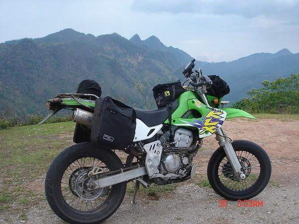

Johnny,
When I moved to Thailand about 5 years ago my first bike was a carbed KLX 250. I bolted on a 331 big bore, pumper carb, and WebCams high lift cam. That motor was thrashed across three countries for a few years and was as reliable as a top. The big bore really gave the KLX some mid range poke which as most KLX owners are familiar, stock there is a severe shortage. Just a data point to say that I never had issues with any of Bill Blues work.
That ole KLX is still running around with the new owner and he's thrashed through various countries as well.
One downside that Ian touched on was gas mileage. Duking it out with Luke and his DRZ on the 1148 had me wringing its neck and gas efficiency suffers a bit.
Luckily I had a larger 2.8 U.S. gallon plastic tank mounted that gave still gave me a 200km range.
I know the stock tank on the fuel injected KLX sold here in Thailand is tiny and might not give you the same range if you're hammering it with the larger bore.
