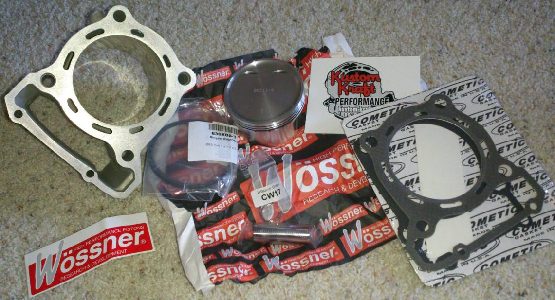

19
I was unable to get the Bill Blue 351 Big Bore while I was back in the US last summer. Bill was on holiday for a good chunk of the summer and when I did finally track him down he was out of cylinders for the 351, so I ended up ordering a 331 big bore from Kustom Kraft:
I haven't chased up Jim to see if he wants it. (My bad).
I believe Bill has the 351 kits back in stock now, but with shipping, duty and VAT it would be a pretty expensive proposition to have one mailed to Thailand, but it's certainly an option.
:happy1:
19
Dunno what happened to Jim, never heard back from him, so if anyone else is interested in this Kustom Kraft 331 kit I'm going to list it in the classifieds now. :happy1:

heilong;296210 wrote: Hey Tony have you sold your 331 Kustom Kraft kit?
Hi Gene,
Yes, sold already, will install it upon receipt of Jim's bike and the powercommader i've ordered for him from the States and will post a detailed installation guide and fuel map once it's done :thumbup:
