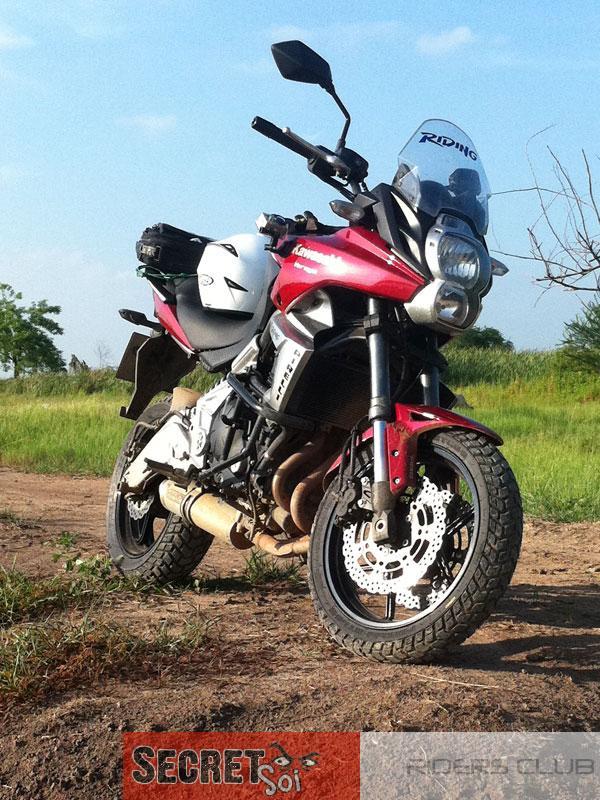

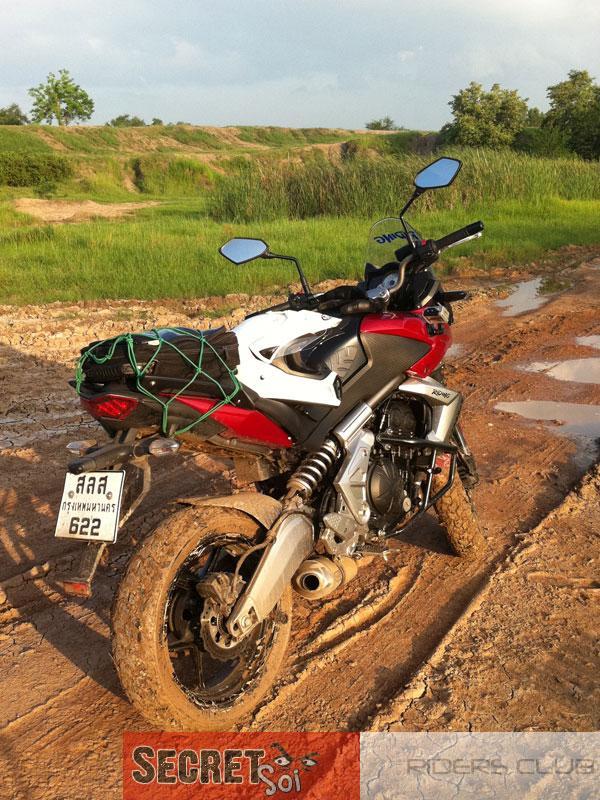

Love this bike! Thursday was dirt, Saturday was track, and Sunday was a mix of pavement and dirt. Here's a fun section through Sai Tong National Park-
Did this while wearing the Diablo Supercorsas and suspension settings from Saturday's track day :thumbup:

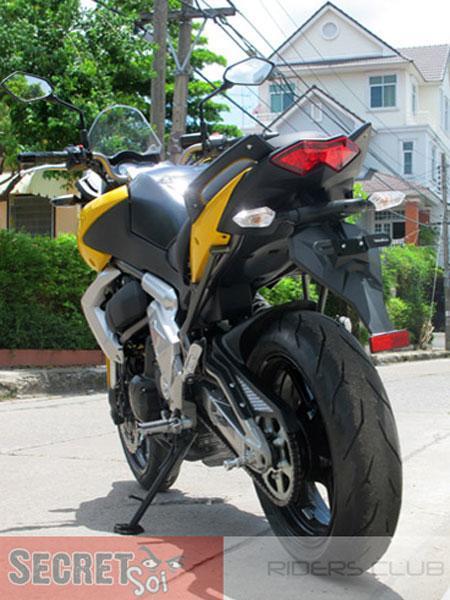

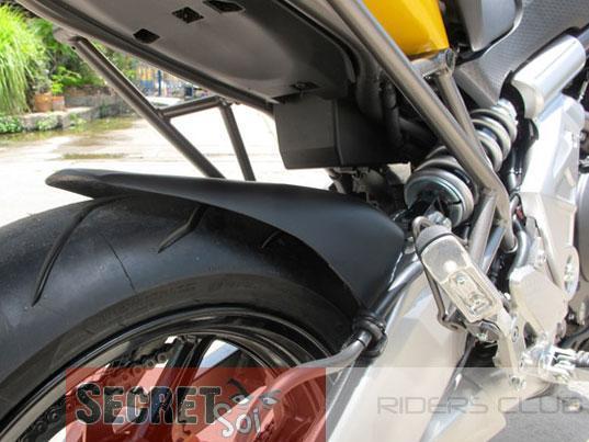

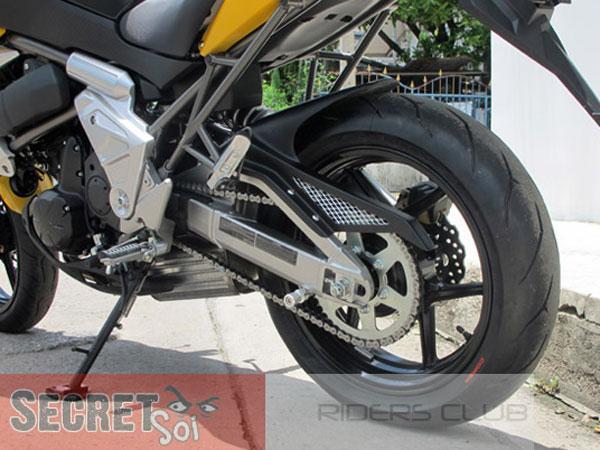

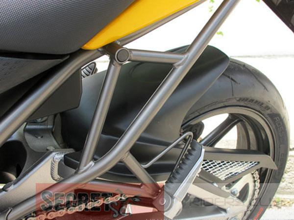

I've been testing this locally produced hugger / chain guard and find that it's fine for road use, but not strong enough for off road use...
The first sample didn't clear the battery box and got smashed when I hit a big bump...
New version clears the battery box fine-
Looks great and really cuts down on the amount of crud that gets thrown by the tire.
It's fiberglass and very light weight. Suitable for road use, but the first time I went off roading with it, it cracked...
I think fiberglass just isn't strong enough for off road use and am thinking about trying to find a supplier that can produce them in ABS plastic. Will keep you posted!

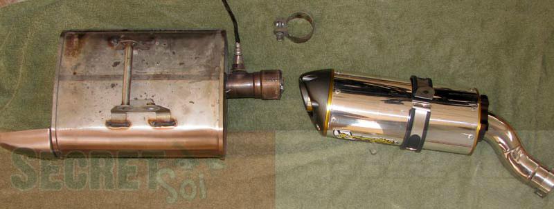

TonyBKK;261828 wrote: The primary purpose of modern motorcycle exhausts is to cut emissions and noise as required by law. More stringent regulations are the reason why bikes are getting HEAVIER year after year.
The Versys is built to pass Thailand's extremely strict emissions requirements. The Thai emissions standards for motorcycles are extremely strict and are in some ways MORE strict than EURO III emission regulations. It's also the reason why Yamaha only sells California CARB spec bikes in Thailand.
The stock exhaust on your Versys weighs about 20 pounds. :shock: Not only is it very HEAVY, it also restricts the power of your bike. Most aftermarket manufacturers publish dyno charts showing the increase in power and torque that you can achieve by using their product. Most aftermarket exhausts have been shown to give the EX650 a modest 2-3 Hp gain. Opening up the airbox, adding a fuel injection module and ignition booster are all effective ways of gaining more power as well.
In addition to an increase in power and torque, aftermarket cans cut SIGNIFICANT weight.
Cutting weight improves performance. Most aftermarket cans weigh about 3-5 pounds.
Sure, imported exhausts often do retail for as much as 18-20k Baht here in Thailand thanks to the hefty import duties, but you can buy a decent aftermarket can from abroad for a whole lot less and carry it over in your suitcase. Or if you have it shipped even with the cost of shipping and duty you'll likely still come out well below Thai retail.
There are some Thai brands now available for the EX650 as well that are a lot cheaper than import brands. DBS, Tyga and Tsukigi are a few of the cheap locally manufactured brands I can think of. I also know some shops in Bangkok that are selling knock-off Leo Vince's and Yoshimura pipes but no idea about what kind of quality you might expect from the knock-offs...

Hi Tony, Any updates on the rear huggers? Do you know where I can get hold of them in Thailand? Cheers Dave
19
stubzi;280236 wrote: Hi Tony, Any updates on the rear huggers? Do you know where I can get hold of them in Thailand? Cheers Dave
Afraid the one I got from Kittisak Racing did not last... It was fiberglass and just not strong enough.
I've seen some plastic huggers that look more solid but can't remember who is making them.
There's an ad somewhere in the ClubVersysThailand classified section but I'm not finding it at the moment- http://www.clubversysthailand.com/index.php/board,9.0.html

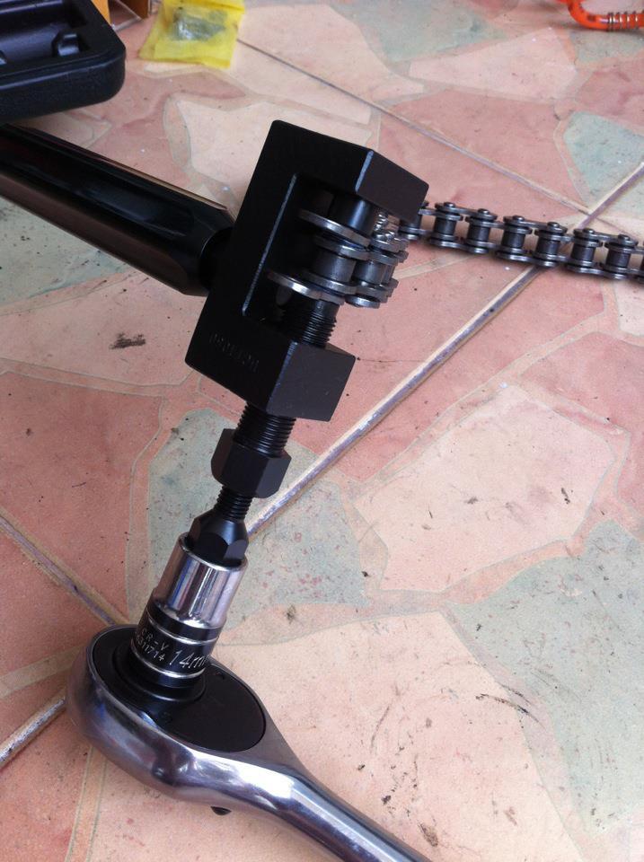

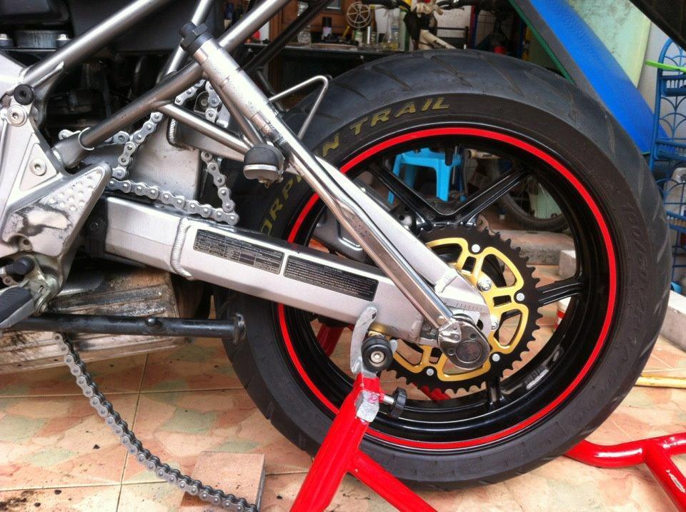

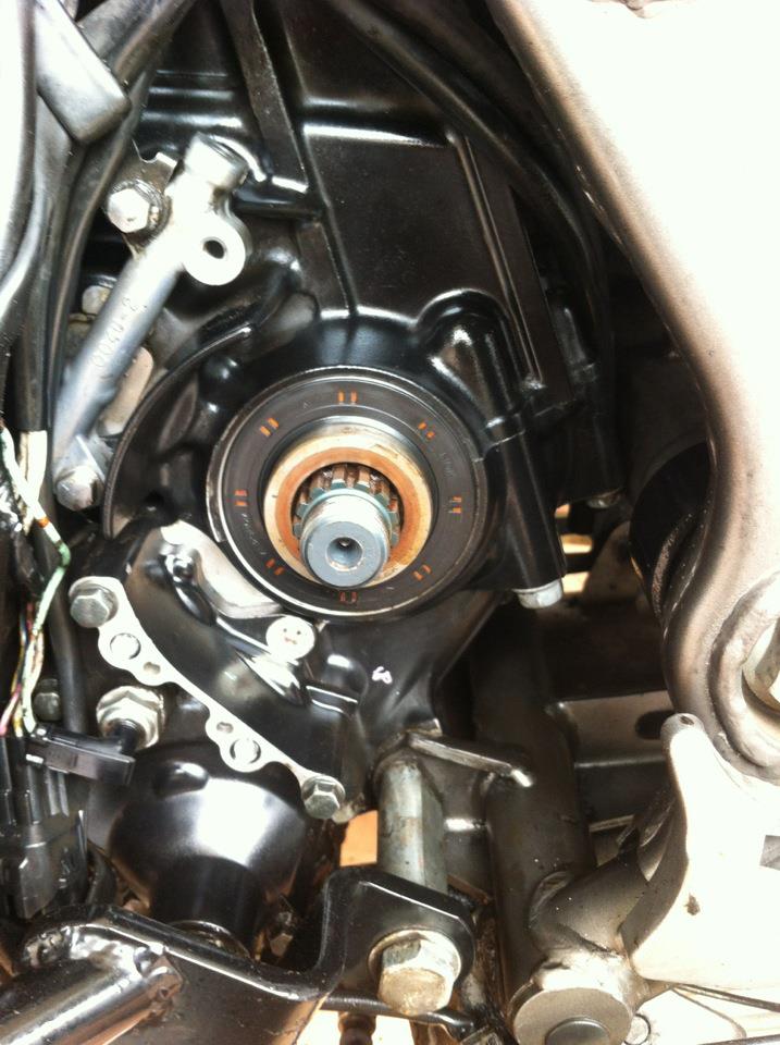

Cooked another chain on the Versys... Have to book in advance for service at Kawasaki Rama 9 so decided to swap chain and sprockets myself :)

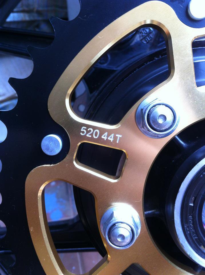

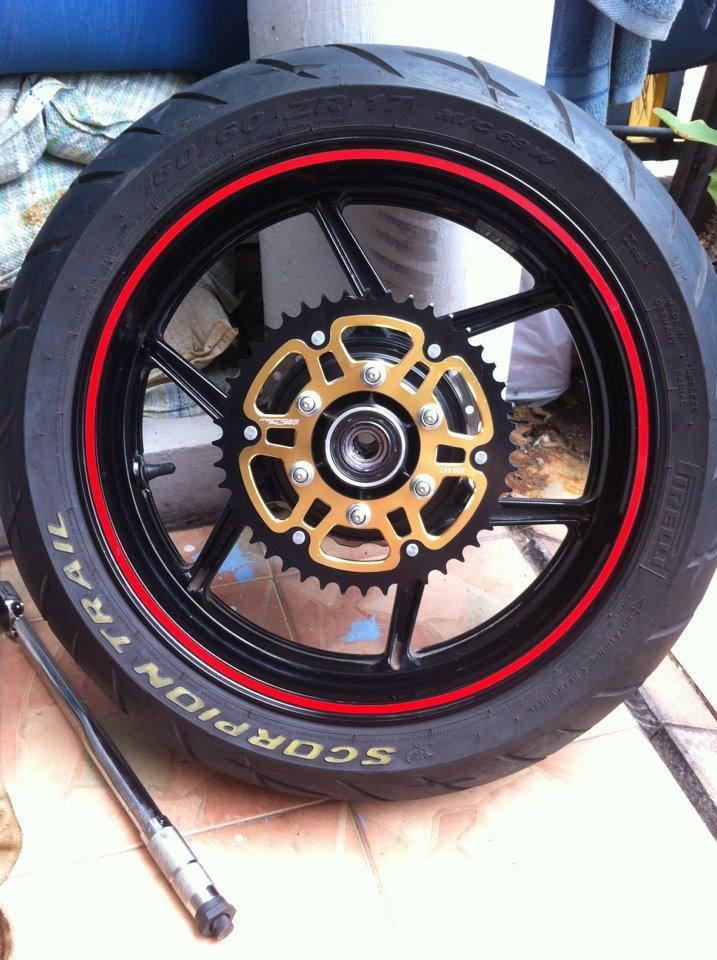

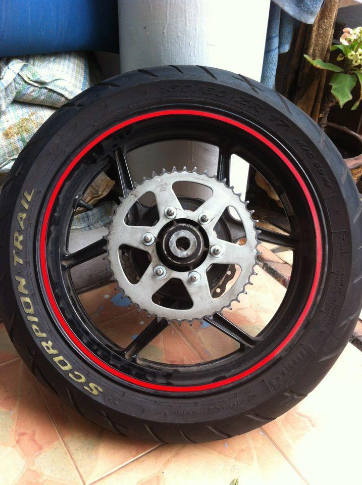

Going down 2 teeth in the back with a MotoPlay 44T sprocket.

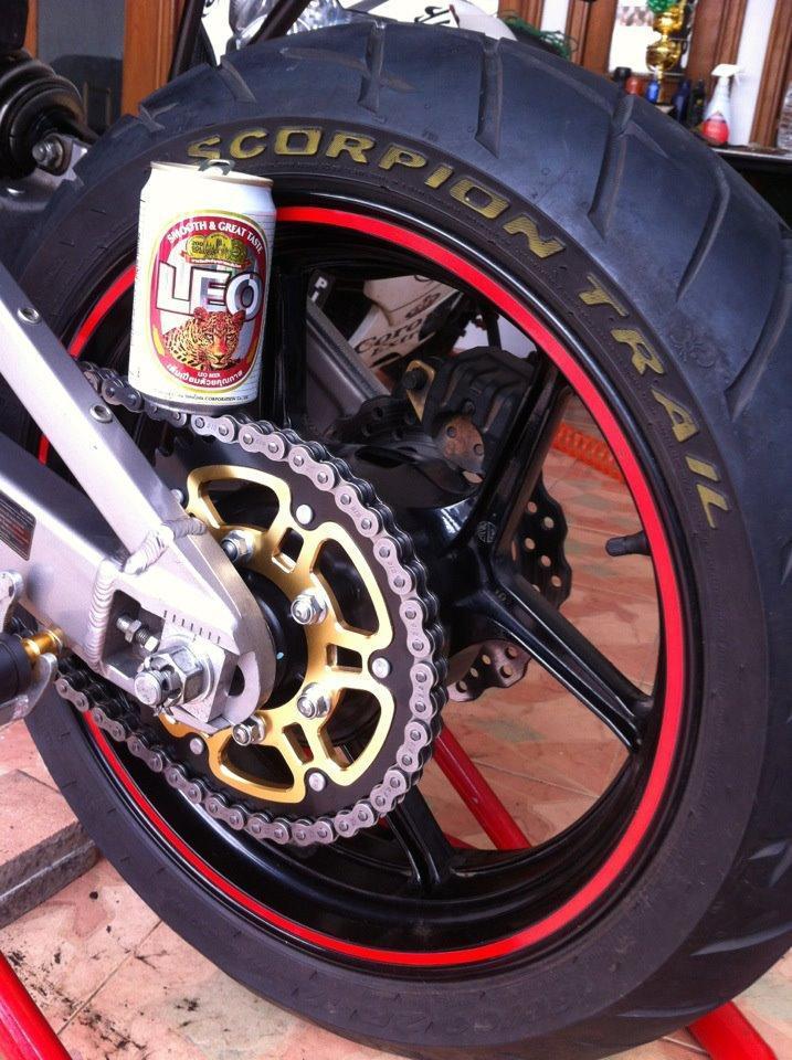

Out with the old...
.... and in with the new! ^_^v
44T 520 for the Versys. Will lower the revs a bit on the highway :)

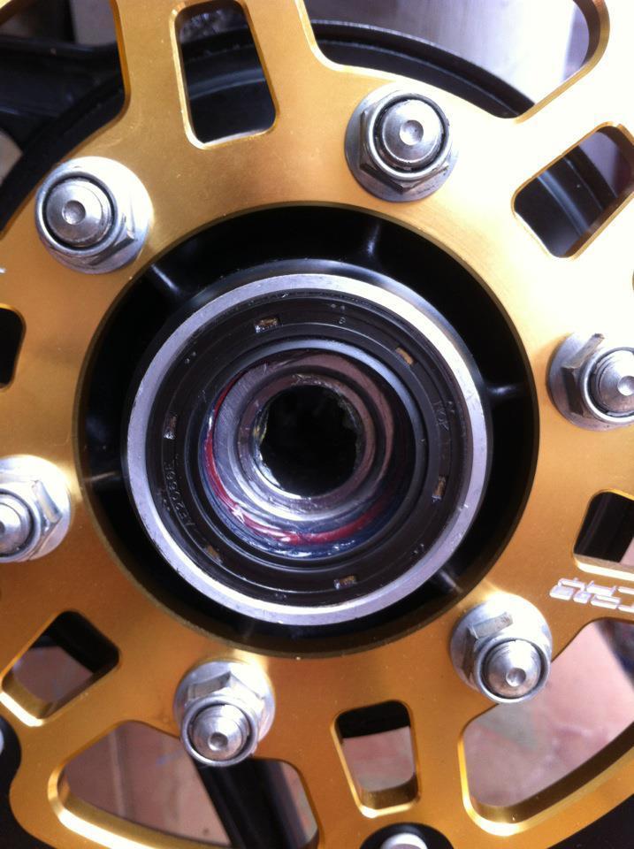

Clean and grease the wheel bearings :)

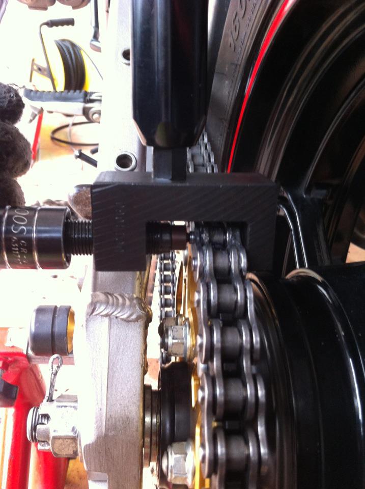

Cut the old chain

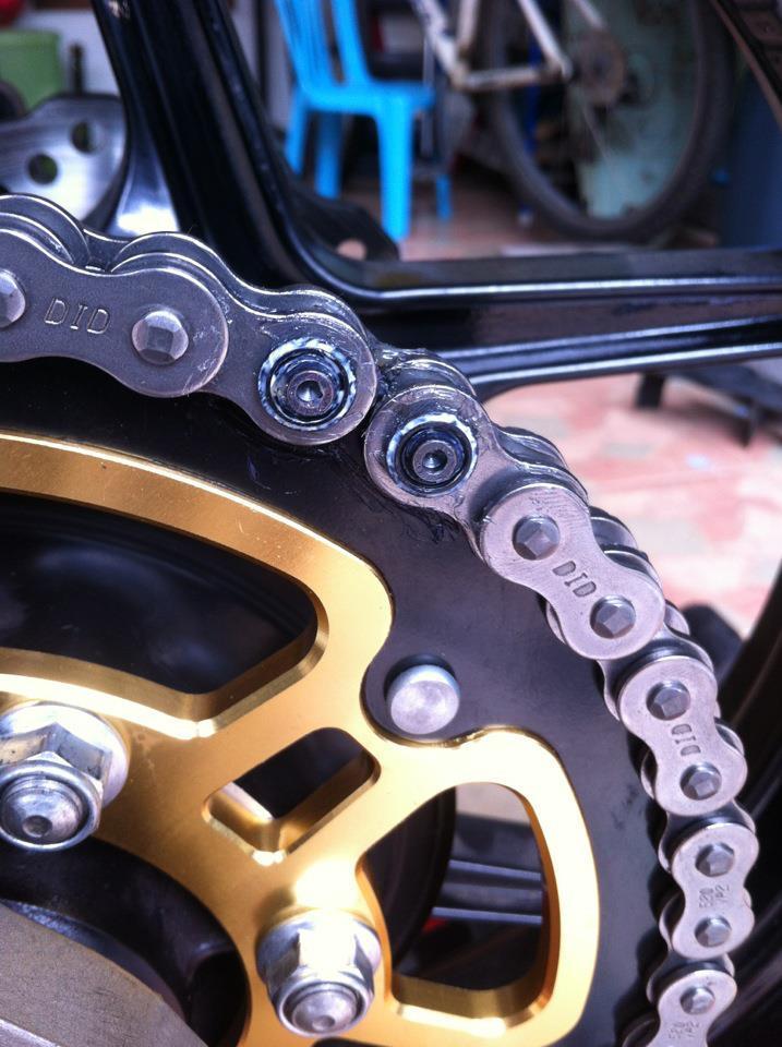

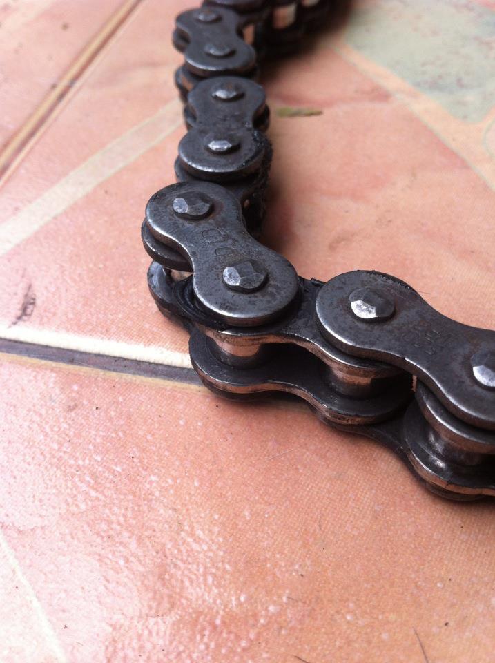

Only 12,000km and this chain is toast... Note failed o-ring... :/

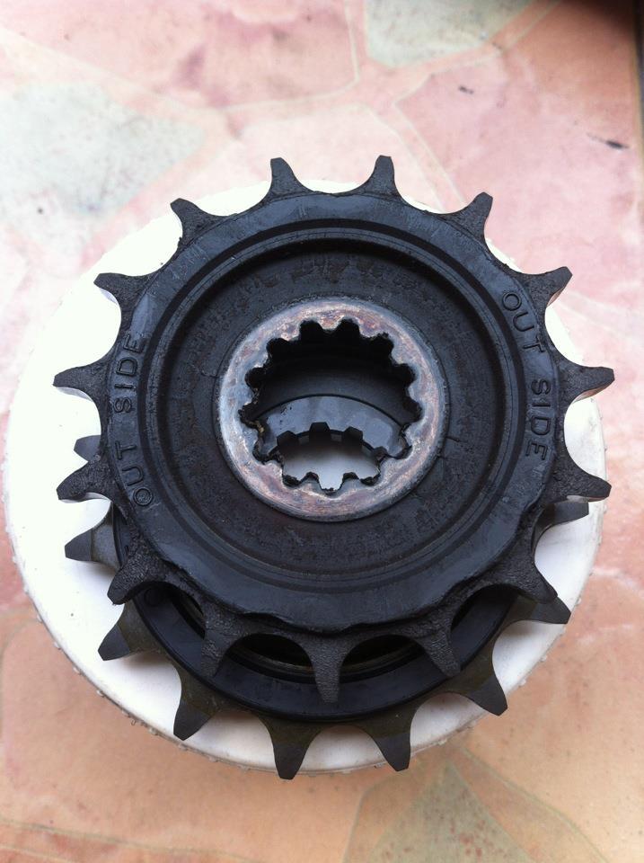

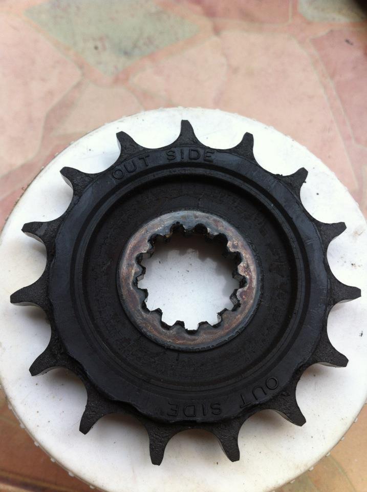

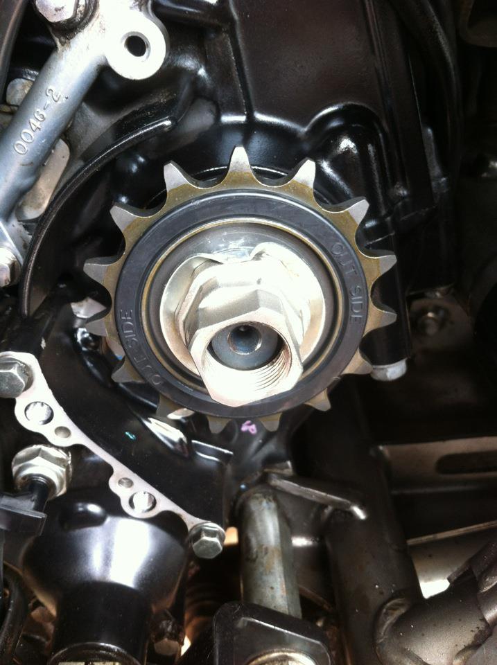

Yikes! Severely worn front sprocket... Is this kind of wear possible in just 12,000 km? Did Kawasaki replace it when I last changed chain and sprockets?
I had asked Kawasaki to change the sprockets along with the chain at ~12,000 km, but there may have been a "misunderstanding", and I must confess, I didn't look closely at the bill... One more reason to do it myself!
Old on new :)
Countershaft clean. It was seriously dirty!
Front sprocket done. Mangled the lock washer a bit ;)
Smaller sprocket means shorter chain- removing a link :)
80 ft/lbs to keep GT-Rider "Monsterman" happy ^_*
(Turns out 80 ft/lbs is EXACTLY "torque it's **** off" on my elbow gauge) ;)
Installing the master link
Master link side plate on :)
Flaring the pins. So easy when you have the right tool! ^_^
Job done! TGIF! Have a great weekend everyone!!! ^_^v
May 10, 2011
14
Hi! Tony,
I believe the original rear sprocket is 46 teeth. The newly replaced one on your bike is 44T. What's the major difference? Can you notice it instantly? Did you gain more in top speed? Thanks.
19
Silverliner;280351 wrote: Hi! Tony,
Yes, that's correct the stock rear sprocket is 46T. I wanted to try the 44 to bring the revs down a bit on the highway. Of course, now my speedo is off since the speed is measured at the front sprocket. I'll have to check with a GPS to see exactly what the speedo drift is. As far as how it rides, no, I can't feel a noticeable difference. :)

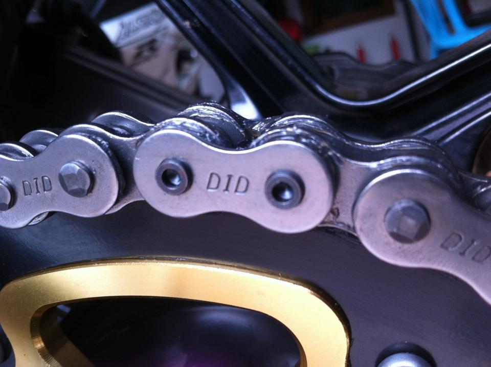

I also see you put back on the standard DID chain I had always spoke highly of DID chains until I wore the one out on my Ninja in no time at all may be they just use a really cheap DID for our models so I have tried a different chain this time but its not been on long enough to know if its any better.

I agree 100% that the DID chains that come on the Kawasaki 650's in Thailand are crap- they are Made In Thailand DID chains and don't come close to matching the quality of Made in Japan DID chains. Interestingly, the DID chain on the KLX 250 is a Made in Japan DID...
Once this free chain wears out I'll replace with quality. :)
