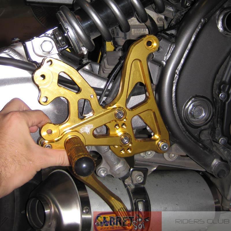

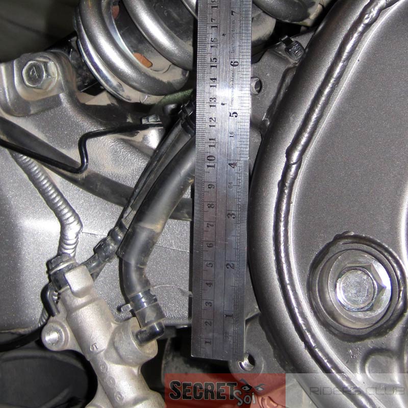

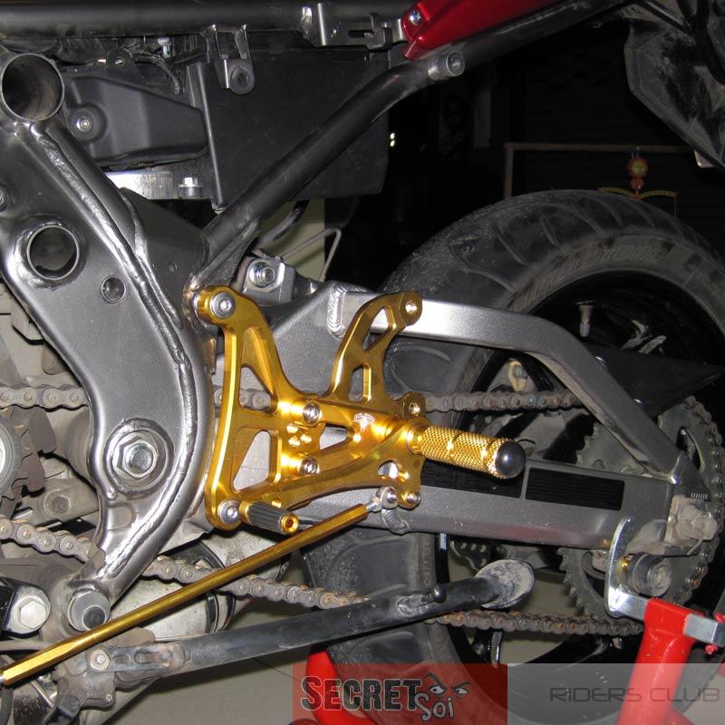

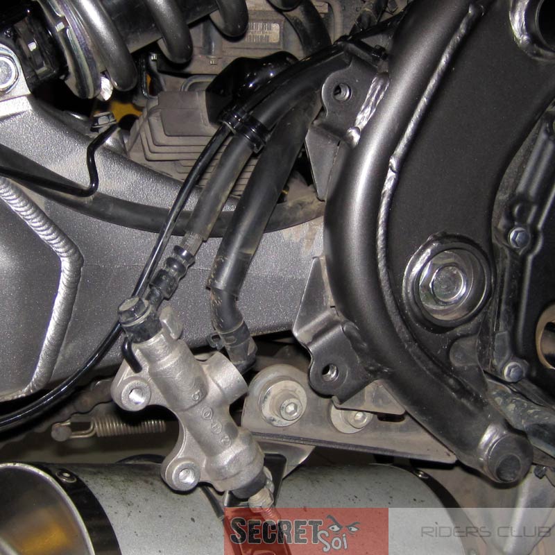

Hey, so I've had a couple inquiries about whether the Ninja 650R / ER6n race rearsets will fit on the Versys, so finally made some time to check it out-
Sorry to report that the RH mounting points on the Versys are NOT the same as on the 2009+ Ninja 650R / ER6n.
Left side bolts on no problem:
(Rainy season here in Thailand- please forgive the filthy bike :mrgreen:)
Right side with stock stay removed:
The distance between mounting points on the Versys is 5 1/2 inches:
The distance between the mounting points on the 2009+ Ninja 650R / ER6n is 5 7/8 inch.
So it's close, but won't fit:
I believe the older generation 650R / ER6n shares the same right side mounting points with the Versys. If they do, then one could use older generation rearsets on their Versys.
I may see if I can have a set custom made for my bike, just for fun. (don't worry- they will NOT be GOLD! :lol:) Will post pics if/when I get them done.

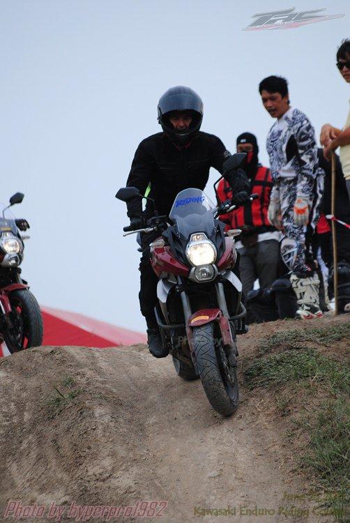

Kawasaki yesterday put on a fantastic off road clinic for Versys owners-
http://www.facebook.com/video/video.php?v=10150657737780710
Over 30 Versys showed up-
Some great instructors from the Siam Enduro Club and Khun Bai from Dirtshop-
While the Versys is a big heavy bike, I was impressed to see that with proper skills and technique it can tackle some pretty rough terrain-

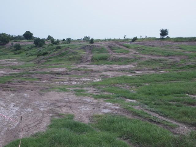

Some more Versys pics-
The area where this took place is called "Bo Din" and it's a huge plot of empty land next to a big reservoir / lake in Minburi, Bangkok.
Apparently anyone is welcome to go out there and ride-
Here are the GPS coordinates: 13.881675,100.796978
And a Google Maps link: http://maps.google.c...4787&num=1&z=15
Even though it's technically still in Bangkok it's really remote- I recommend going with a friend just in case you have an accident or mechanical issue and need help.
I'd really like to get back out there and practice some more so if anyone is interested please drop me a line and I'll see you there!

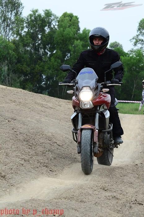

KZ;269330 wrote: Nice pix, who took them?
Most of these pics were taken by Khun Champ and Khun Narong. They are a pair of photographers who show up at nearly every bike event and post their pictures on assorted Thai forums.
These pics were taken by the same guys-
They've got some skills!

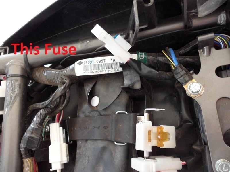

Been looking on other forums to find a way to be able to switch the ABS off when on the gravel, had to many hairey moments when travelling fast on the dirt and you cannot wipe speed off because the bloody ABS has cut in which makes going round the corner exciting to much, if the ABS was disconnected you can steer the bike using the rear brake.

You found the 3 fuses under your seat already but if not ......
RTFM and you know that under your seat are indeed the fuses for your ABS. Just run a wire from the correct fuse to your handlebar and add a switch. Might not be the most beautiful way to do it but it will work.

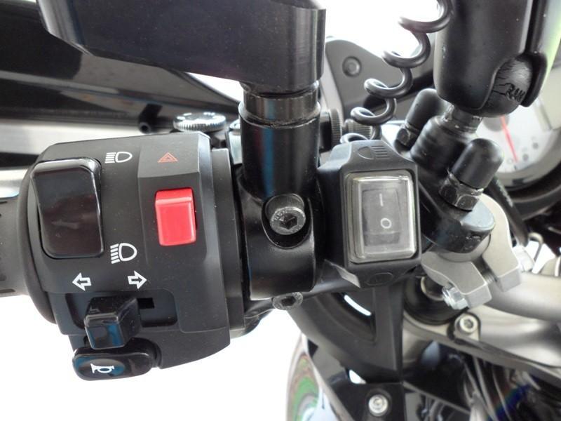

Well done the mod to switch the ABS off today and everything works Ok even with it switched off.
Used a SW Motech light switch that came with my driving lamps as i hard wired these into the bike so they were on all the time i was driving.
Ran the spliced wire for the ABS through a relay as they are pretty chunky wires with a 20A fuse, i feel better for the switch rather than a large current running through it when the ABS cuts in.
So all happy now, and you have the ABS warning light on when its switched off, just in case you forget.

Now check if the ABS is indeed not working anymore!
