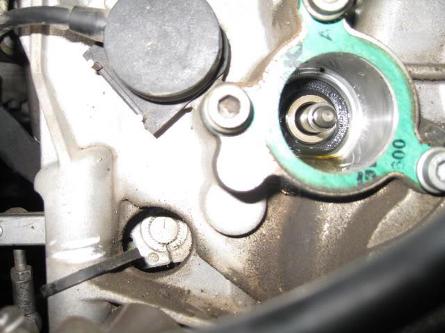

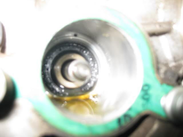

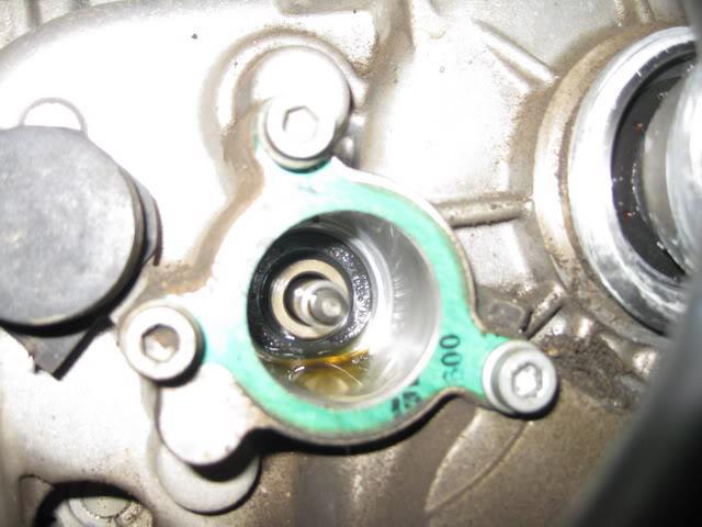

here is confirmation that my Slave cylinder is caput(finito) as there should not be any oik inside here.

Marco wrote: Feejer
Oh yes. That is trouble. Luckily mine did not go bad before I got the weep hole drilled. Did your plates get contaminated with hydraulic fluid? No matter anyway, as you are going the whole way with the clutch replacement.
Might be too late if you already assembled, but one thing I remembered is that a good idea to put some ultra-low friction/high temp/waterproof Krytox grease (if you can find it) in the divot for the actuator rod. If not, then the Honda Moly60 grease is darn good too. Lowers the chance that the rod digs in and spins the piston on the seal. Just a theory, but I think that's why these slave units fail prematurely.
