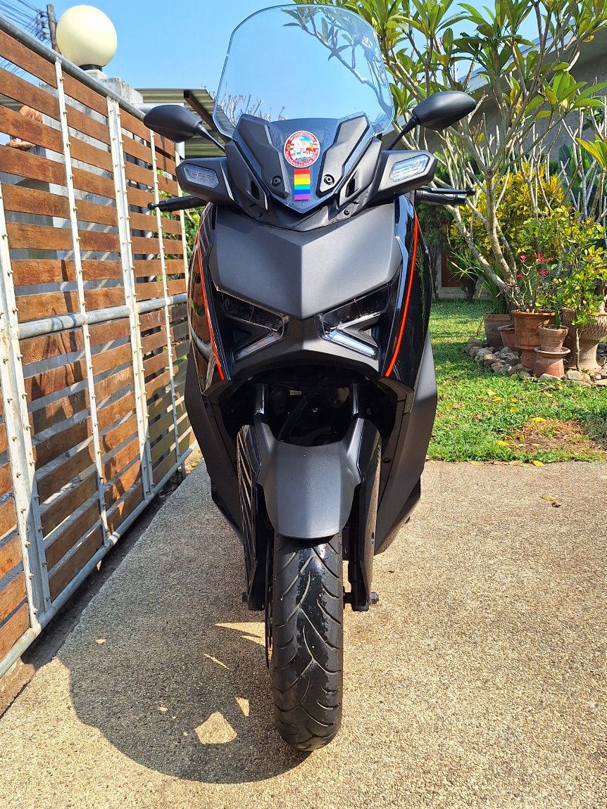

Buying second hand from Maejo with just 2900kms on the clock and around 8 months old i got it early this year for Thb 150k, year 2024 model but not the top version. Owner had to sell as going back to work in S.Korea.
First ride impression: unstable.
Immediately dumped the crap original Dunlops Scootersomething and changed them to Bridgestone Battleaxes. Totally changed the stability of the scooter. But still i am a 100++ kilo guy and in turns Xmax still too unstable, so ordered rear YSS shocks via Pistonshop.
After these 2 crucial changes Xmax stability and handling are what i want it to be.

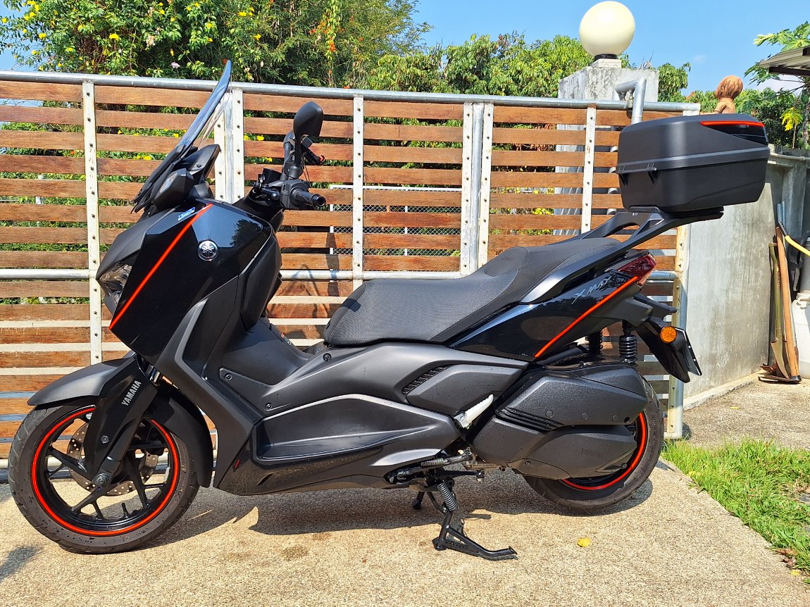

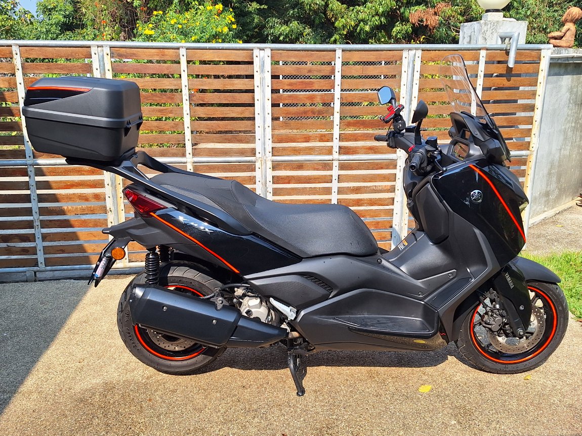

Did fit some gooodies like Motowolf mobileholder, Givi topcase on original topcase holder. Other mods not really necessary.
Went to CNX several times on it and now do my shopping mainly on the Xmax as underseat storage huge, topcase adds another 32 liters. And once i strapped two boxes of BeerLao on the backseat on top of each other.
Topspeed is (with my bulk) around 145km/hr, weight around 185kg+ and power enough to move quickly from A to B. Fuel, well i do more than 300kms on 1 tank which is 13 liters.

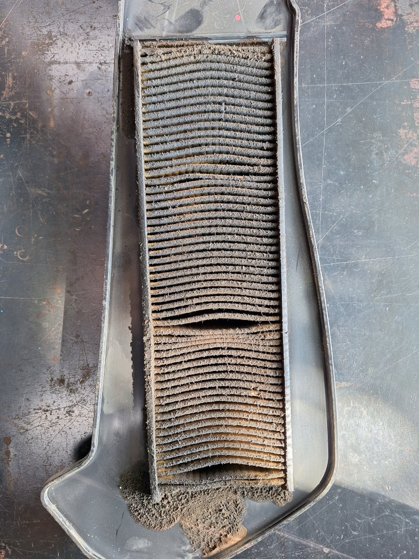

Today did a regular service, changed engineoil and oilfilter and didn't buy anything cheap but only top products. I also did fit the K&N YA2918 airfilter and was shocked to see in what bad condition the original airfilter was after not even 10,000kms. Also the filter for variator/clutch was totally clogged with gunk, dust and sand.
So fitted the new K&N and blew the variator filter from the inside out as just ordered 2 originals in BKK.
As a sidenote, the original airfilter some joker put oil on the outside, usually one can use the airfilter 2 cycles at least but through this alcohol/jabbadabba doo idea of oiling the original one it went straight into the trashbin.
A warning to all scooter riders where the airbox is mounted above the transmission/variator casing, as this is a very low lying point and exactly where dust/rubbish moves from the frontwheel, the filters there tend to soil very quickly. I will now clean both at an 5k km intervall.
Just check yours frequently.......
On the Honda ADV350, on dusty Northern Thailand roads, I replace the air filter every 3-4000km....it's intake position is not dissimilar to a vacuum cleaner }}}hahaha{{{

The 400B ADV350 filter unfortunately gets a bit oily from the crankcase breather that vents into the airbox, so blowing it can cause problems.
Haven't seen this vent on the Xmax as also was expecting this but after examining the original airfilter, lid and housing it was definetely Somchai'ed with oil

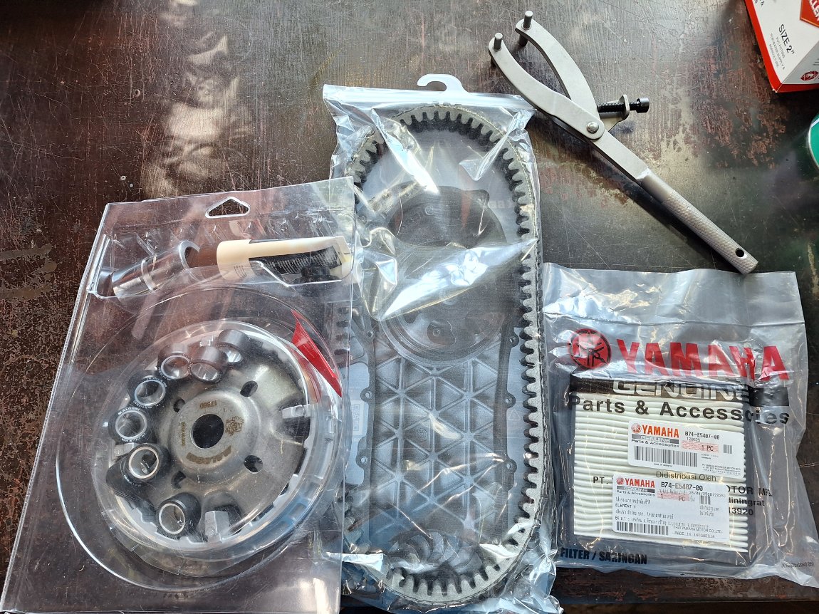

Just fitted the MALOSSI MULTIVAR2000 and a new variator housing filter. As expected and already experienced on my Tmax, changing the Variator disk made a huge difference in low speed acceleration. Happy, now only waiting for the Yoshimura R77J-TIS full system and a engine remap after fitting it.
This time didn't change the belt yet as still as new and hardly a noticeable change in dimensions. On next change of the belt will also get a new clutch spring fitted.
