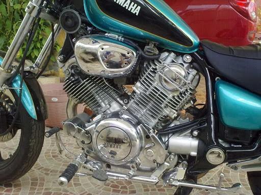

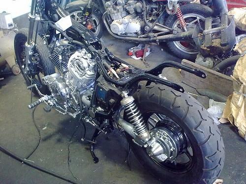

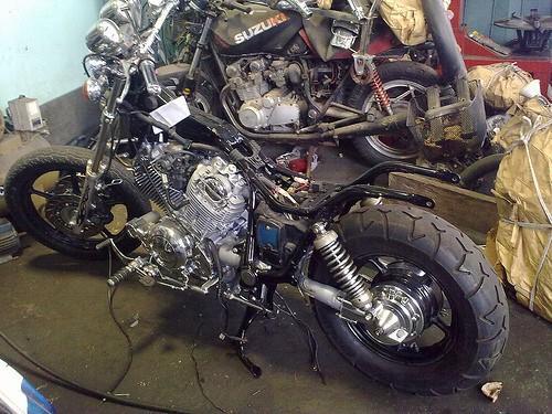

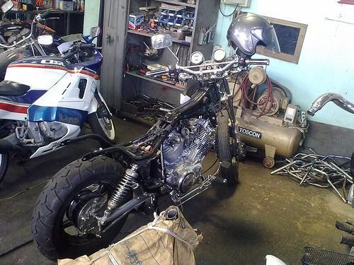

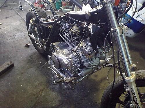

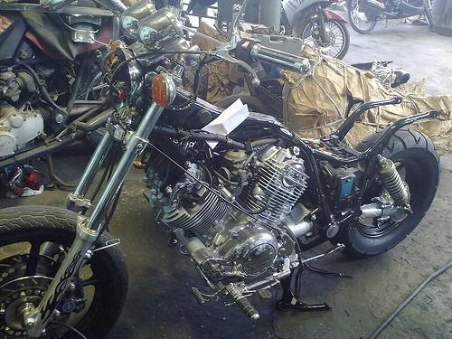

Thanks for the feedbacks. Looking forward to be on the road with it soon too :happy1: ...but somehow the time to finish keeps stretching. It's kind of normal here though :think: . Anyways here some pics of today .Still the Carb to be polished(at least i tried to get it to understand to Mr. Oor (mechanic))-some parts we are waiting for and quite a bit of work ahead .

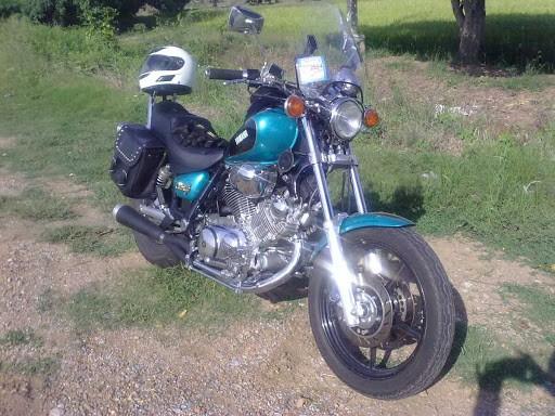

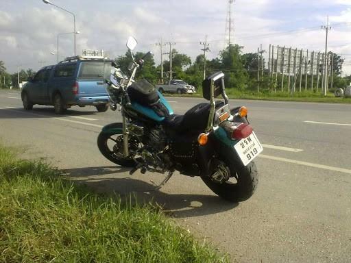

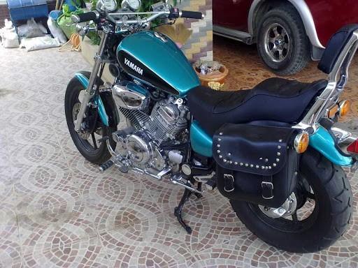

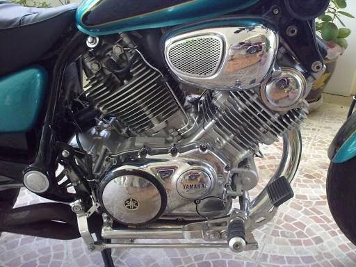

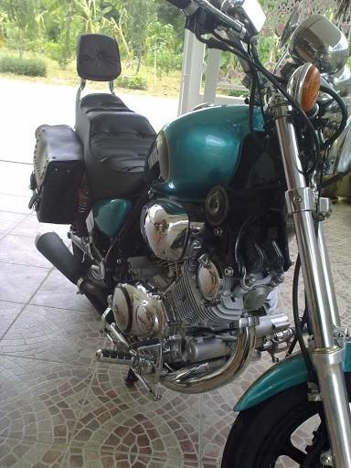

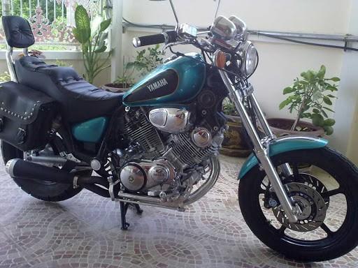

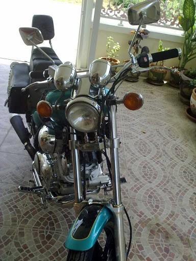

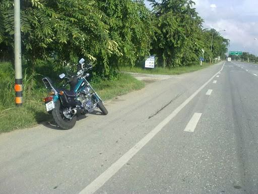

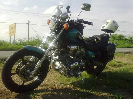

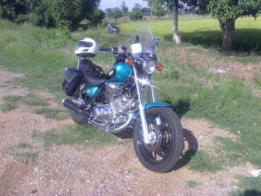

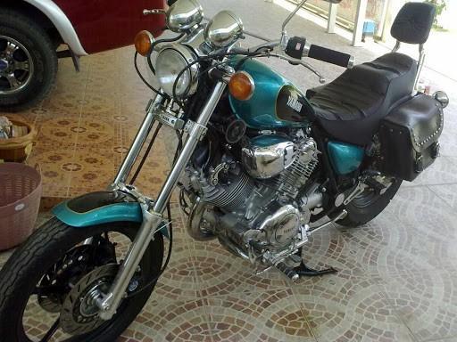

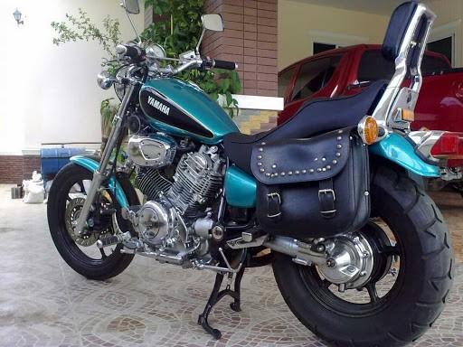

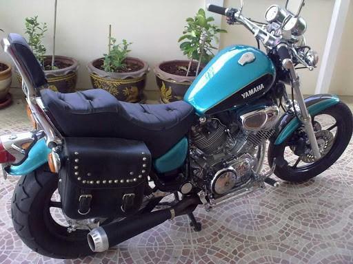

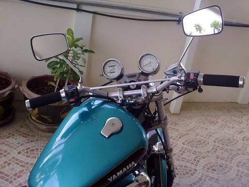

Here some pics of my soon finishing Virago Xv750 . As you can see it has the new paint the Motor is not black anymore...there is a new exhaust ( custom-handmade) lot of things has been done that aren't visible but were rather technical(new clutch, new generator stator, new pulse generator, new wiring ...) . There are still some cosmetic parts to be fitted/exchanged but they will be sourced over time from secondhand bikes. Looking forward to be on the road soon.
mbox
Ps: there are 12 pics below so it may take a little to load

And a nice one she was tranferred into..............
I like the colour and also the custom made muffler !!
Must have a throaty sound, good, so all dogs, chicken, Waves and kids can hear & run :mrgreen: .
So when's the first ride up to CNX ?? BTW where's the plate ???? rgds, FR

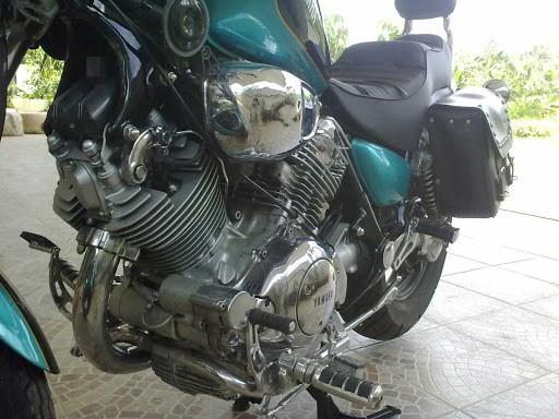

Thanks Franz & David , I am very happy to have it close to finish...the last 3 spareparts just arrived from the US and shall be installed by tomorrow ( generator stator, pulse generator & startergear)...although the startergear looked a bit different as i remembered it , but the mechanic said it looks right . So hopefully i am wrong and the mechanic right. The exhaust sounds really nice now it was well made with the exception of the paint itself. I asked for a heat resistant color repaint , although not sure if maybe something else such as powdercoating could be better.
I am sure a longer trip shall come and if that comes it will be to CNX, but first i would like to make some shorter rides to see if all is well ...

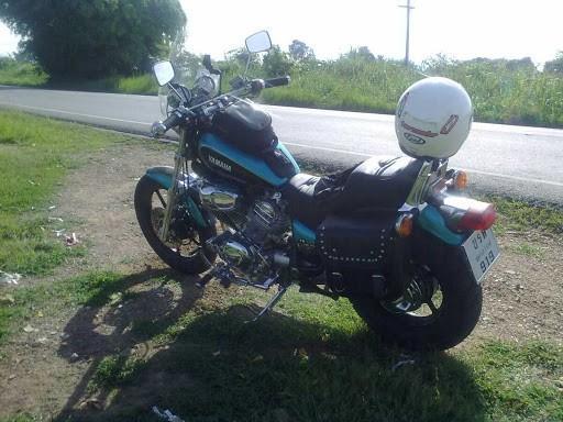

Franz, about the plate...i lost it while doing a test ride. I reported it lost to Police already and will drive on the Police Statement around . A new Plate has been applied for and i shall have it already but it was a "wish-plate" so it may take a little longer...

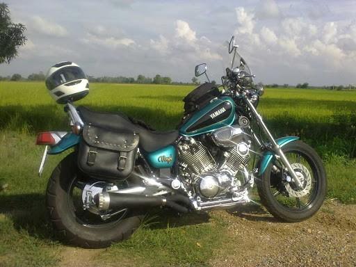

Captain_Slash wrote: You certainly made a good job of it as it looks great
Thanks colin, it feels great too, but it is an 25 year old Lady and i assume there will always be bits and pieces to be exchange or fixed...but the basics are fine ( me thinks).
Not sure what i must think of the custom made exhaust ...i like the looks and the sound is crazy but also quite loud...i ride on trips longer than 30km's with earplugs, and when i pass on parked Cars their alarm would go off :shock:
