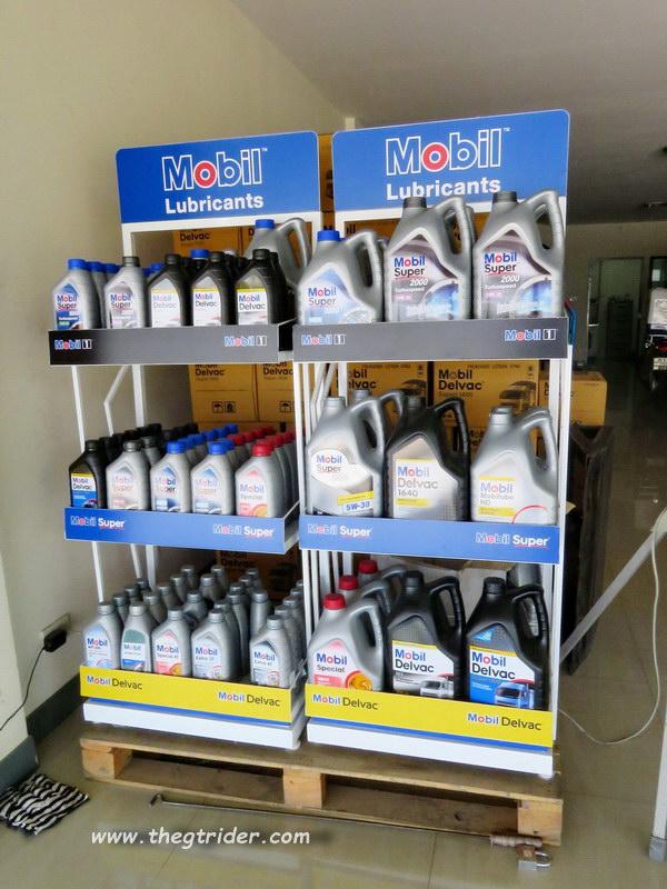

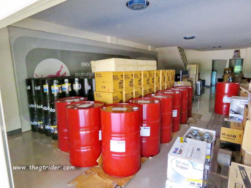

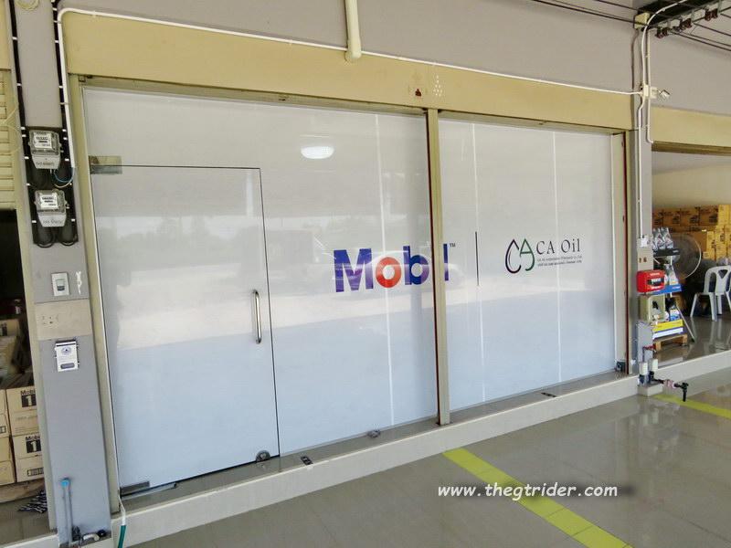

Found the Mobil 1 distributor for Chiang Mai.
For the hard core Mobil fanatics you can get it by the drum..
I'm not sure about retail sales from this outlet as the staff there at the time seemed somewhat incompetent & could not even produce a biz card or contact details.
The shop however is right next to Tire Tech, so you could swing by & check both places out.
Tire Tech is here
Google Maps

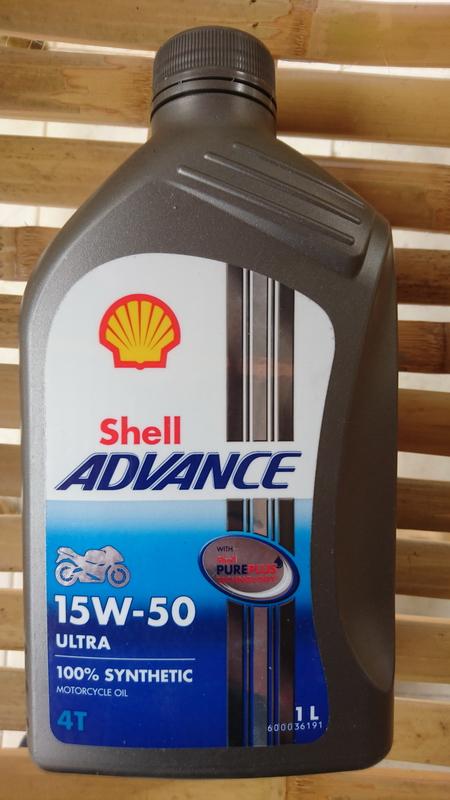

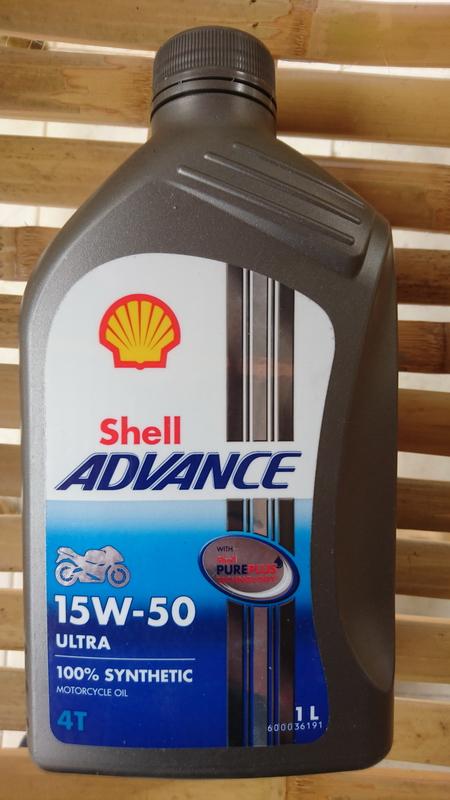

Up for an oil change on the Vstrom and with the hot season approaching, getting 15-50W isn't so easy with 10-40W, the oil available in most places.
Ban Chang in CR, everybody's favourite tyre guy, is locked into Motul oils, which I reluctantly use, but A650 baht a litre, it isn't cheap.
Back home in Chiang Khong today, I popped down to a small local shop to get a can of Sonax spray, and lo and behold, he had some Shell 15-50W at a nice price.
