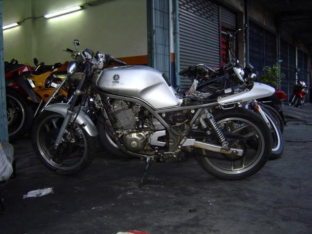

To add a little to this never ending story, here's an update on the SRX6.

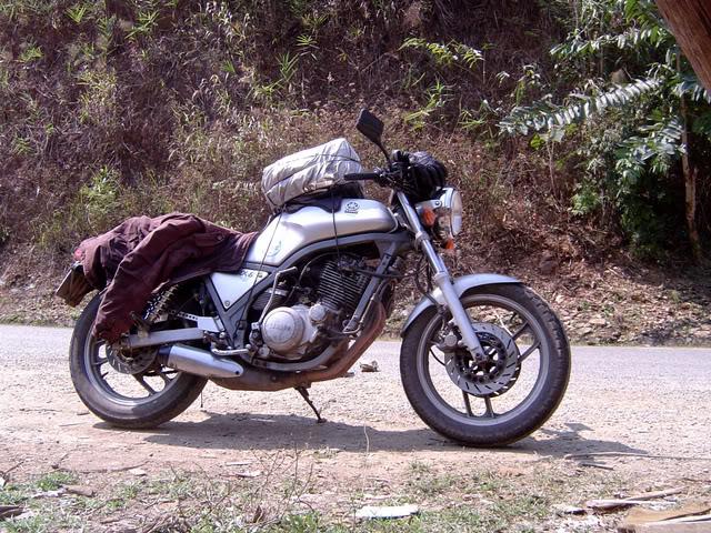

Well bike still looks the same as when I came to CNX; while taking the engine apart, I always found some new surprises.....by Somchai..... :cry:
Front without screen looks much more attractive, further on did I get clamps with mirror holders from Ebay which now moves both mirrors to similar height and position. Just replacing the holding clamp for the front brake cylinder housing & tank.
Sides look now really nice but still some more work to be done:

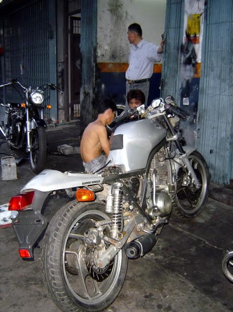

Now the engine, while taking off the head, found that none of the valves ever closed so had to completely clean this one up, replace the valve top seals and grind them into a new seat. But then came the big surprise. Engine was fitted with a new sleeve, while pulling the original one out, Mr. Sc also damaged all 4 threads for mounting the cylinder head and fitted them with inserts, just look at the screwed-up inserts......no wonder this one was bleeding from every cranny.....Further on did he press in a non fitting sleeve from I think a SR500 and thus reduced the replacement from 600 to 500 cc. While fitting the piston Mr. Sc found out that the valves will crash into the piston, so he grinded the piston well off with a handheld angle grinder, not caring of also grinding away some sleeve surface. just see the marks on both sleeve and piston. Not enough, Mr. Sc also saw that the new modification didn't work as the piston will crash into the crankshaft, so angle grinder again and here you go.....look at the underside of the piston.......
So now the engine's strapped bare, just found out that a non fitting brass gliding bearring was fitted into the pushrod which shouldn't be there but the 500's piston rod is lightly smaller than the 600's. so take this one out and restore to original. Had to get a used cylinder & piston from Ebay so hopefully next weekend I can start to reassemble the engine. Want it to be ready for Dec. 5th.
