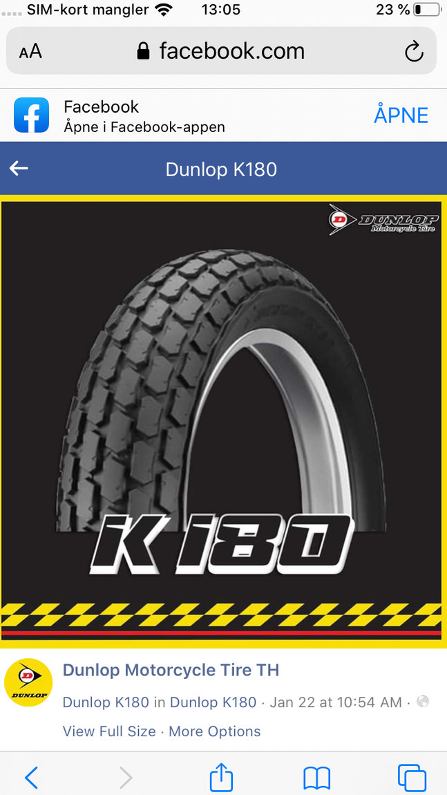

I think I might head towards a set of Dunlop K180’s for my Interceptor. There are very few 18” options out there that are usable, particularly when road is 90+% of the riding, but it would be nice to have something with a little more bite for wet clay an sand.
The K180’s look to be OK on the road, and I’m not doing any fast riding, although I doubt if they will wear well.

Dunlop obviously has factory that makes tires here in Thailand. My newly purchased Dunlop 605 is definetively made in Thailand.
Cant help you with a dealer but Dunlop motorbike tires Thailand has a Facebooksite where you can contact them.
Here is a posting from them a couple of days ago...

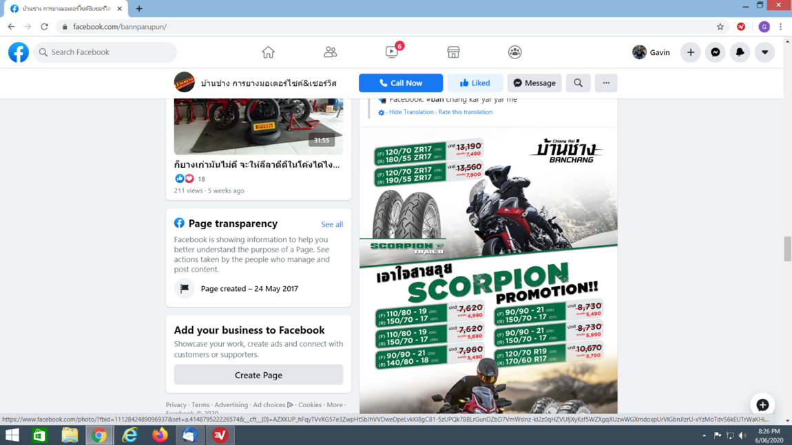

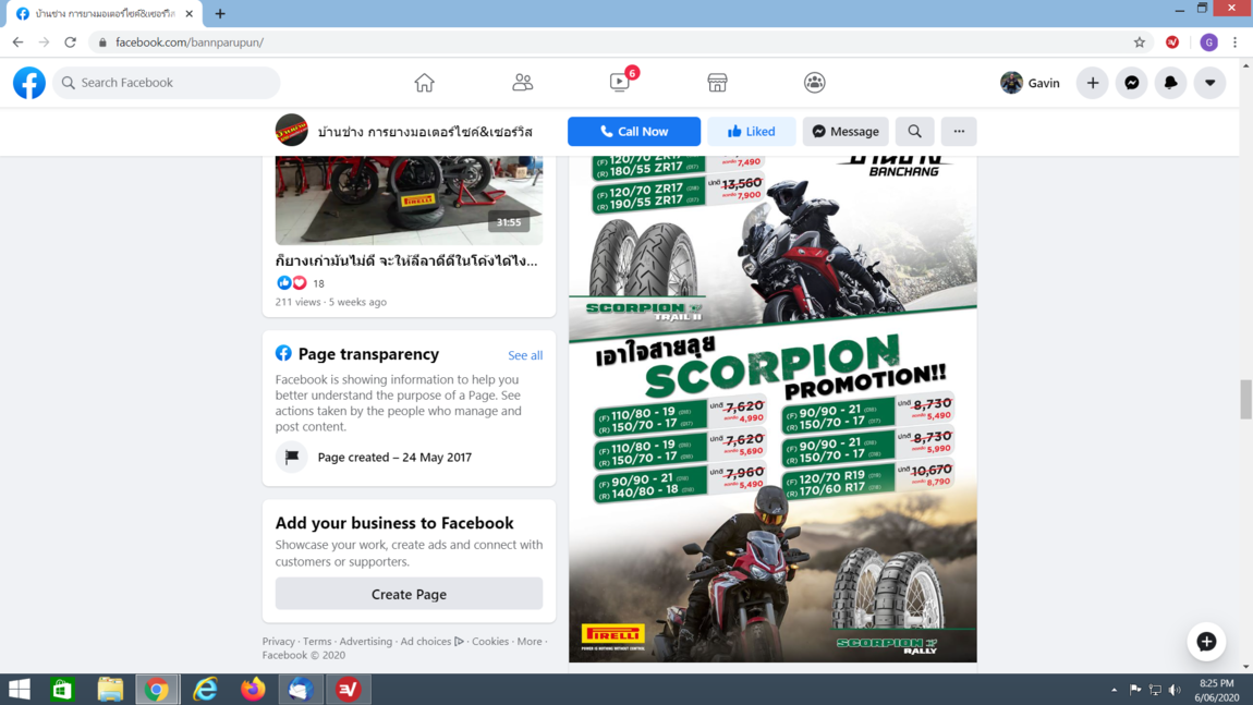

In Chiang Rai they have a promotion going on Pirelli Tyres starting yesterday, a nice discount on the Scorpion Trail 2 and the Rally STR for those interested.....................

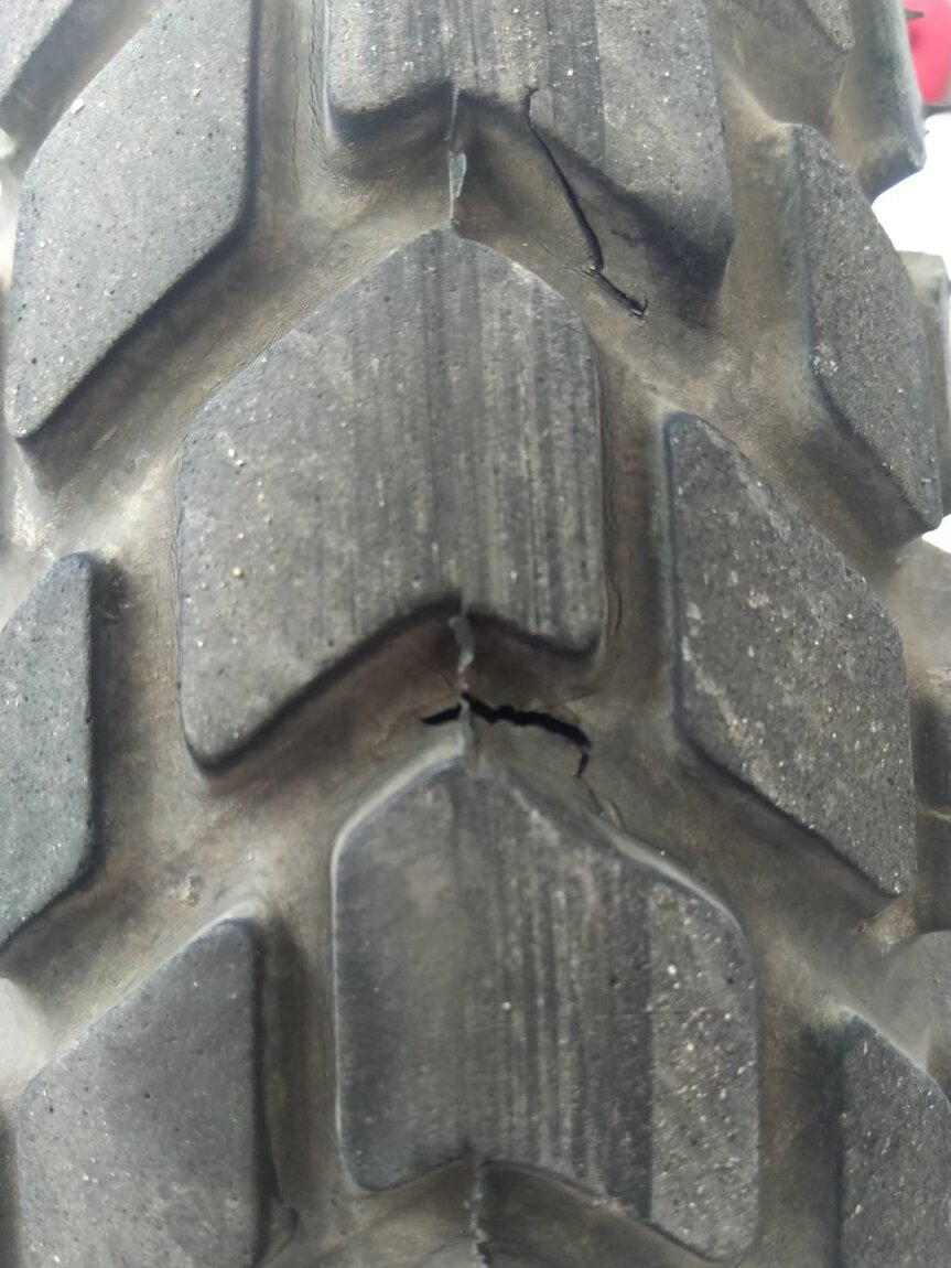

The front tire of my bike (RE himalayan) is showing a progressive cut/ crack(s) I'm not sure how deep it is but it's getting a bit bigger the longer I ride. I noticed it during a trip and rode home for another 90 kms and saw the crack getting worse. I think I caught a piece of metal while driving on Mitraphap road on the way back.
Turns out the MT60 90/90 -21 and 120/90 - 17 that come with the bike are not sold in Thailand after talking to the RE dealers in BKK (two of them). I just don't get it that the original tires that come with the bike are not serviced by the dealer. I called 29tire in BKK and they confirmed they don't have them either and they have a lot.
My first question is if the crack is really that bad ( figured it is) or if it can be glued (probably not a good idea), and if I need to change them what would be good tires for 40/60 or 50/50 off road.
I was advised Mitas E07 tires and I've read elsewhere that Metzeler Tourance might be good but they're not sold here.
Thanks!
To our Himalayan rider, not unless the manufacturer ( in this case Royal Enfield) calls out for multiple tire sizes....you are stuck with the OEM size.

Those cracks are nothing to worry about. I have had tyres with far bigger cracks. Of course - keep an eye on them in case they get a whole lot bigger.
Tyres and what different riders prefers are very very subjective. What one rider loves another rider hates. So to say anything onjective about tyres are difficult.
Metzeler Tourances - I had a couple of sets of them on a Triumph Tiger 955i. I was reasonably happy with them but they are more road oriented than the MT60s. So if you plan to ride much on gravel roads I wouldnt have gone for those.
Mitas 07 - had a couple of sets of them on a Tenere 660 - very good 50/50 tyres - imo that is. They will be a bit rougher on smooth pavement than the MT60s, but better of gravel and rough surface.

Hi,
From what I gather there are two alternatives available in the same size, I'm not really looking into changing the size though. VeeRubber and Matis E07 are the available options. I'm not sure about the VeeRubber tires, never used them for a bike but I once bought a set for my bicycle here and they were.. not too good.
The issue is that the stock tires, Pirelli MT60s are not sold here nor can they be ordered by RE. I find it odd that RE sells a bike but then doesn't have the stock tires that they ship with internationally not in stock. I asked RE and basically they gave me an address in BKK to source it myself and said they refer people for tires to other places. Huh? OK.
Anyhow, I read the comment below by Dodraugen as well so I'll perhaps wait it out a bit to see what happens with short trips and if the crack gets worse. From what I have observed so far it does and I have tubed tires. There are also all sorts of dry cracks on the sidewall of the rear tire. I'm really surprised that these tires are worn out so quickly with only 6,500km and two years.
What about the Dunlops, 604, 605, 606? The 604s are 80/20 on/off, the 605s are 50/50, and the 606s are for really offroading. I have a set of 605s on my Crf and I love those tyres. But that doesnt mean you will. Dont know if theyre in Himalayam sizes though...
I've been riding motorcycles for 20 years but for some reason never long enough on the same bike to really have had the affordance of trying out different tires on the same bike. So this is a bit new territory for me.
For now, I'll just see if the cracks keep getting bigger. seems like they did over 80 kms hence my caution.
Ideally the tires would be a 40-60 or 50-50 since I do often go on gravel, sand, rocky roads so it would come in handy. I'll have a look at the Dunlops as well to see if they're available.

Here is a video from FortNine.
I think Ryan is explaining this very good.
I saw this one but forgot all about it. I remember saying to myself, nah this doesn't happen to my bike. I got genuine Pirelli MT60s on mine....
Fortnine is good... "it cost me my left nut" hahaha. I'm going to check first thing in the morning where this tire is made.
Reactions: Oddvar
So I checked my tires this morning and indeed, both come from the factory in Brazil, with the DOT code being XE: GRAVATAI, RIO GRANDE DU SU, BRAZIL
Now the interesting question is, was Ryan F9 right with his claim or not? I have only done 6700 kms on this set of tires. The tires are produced in week 53 of 2017 so they are three years old. There are dry cracks all over the rear tire and part of the front tire. The front tire has two deep cracks. The bike has alwasy been stored properly inside whenever I'm not here, not on the side of the road or in direct sunlight. Compared to a set of other aftermarket pirellis 1,5 yrs, with 15K of wear, the tires on my bike feel rock hard. To compare, I was able to squeeze the aftermarket tires' thread a bit and it had flexible edges. My tires are almost rock solid.
So to be honest, based on these subjective observations I can claim very little. Consumerreports.com published an article in Sept 2020 and claims that there are no differences in the tires produced from different pirelli plants. They do not talk about the difference in OEM pirelli tires and aftermarket tires so the question is what they have looked at. What I do know is that these tires are perhaps better up for replacement than keeping them. However, since I have to leave in a few weeks for work and I won't be back until June if the situation permits, I might just wait until then and order some tires later.
