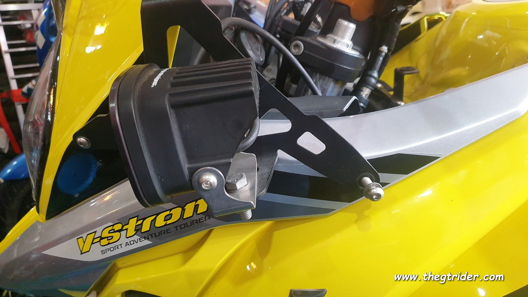

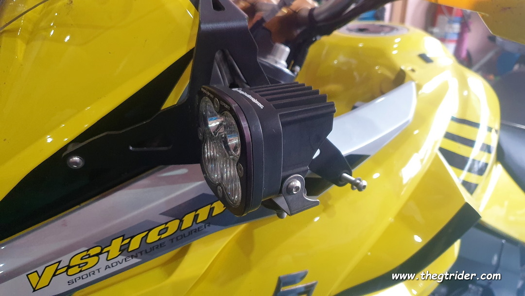

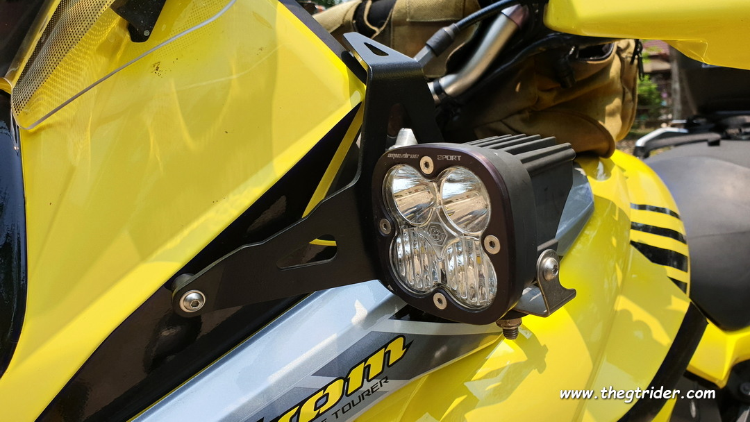

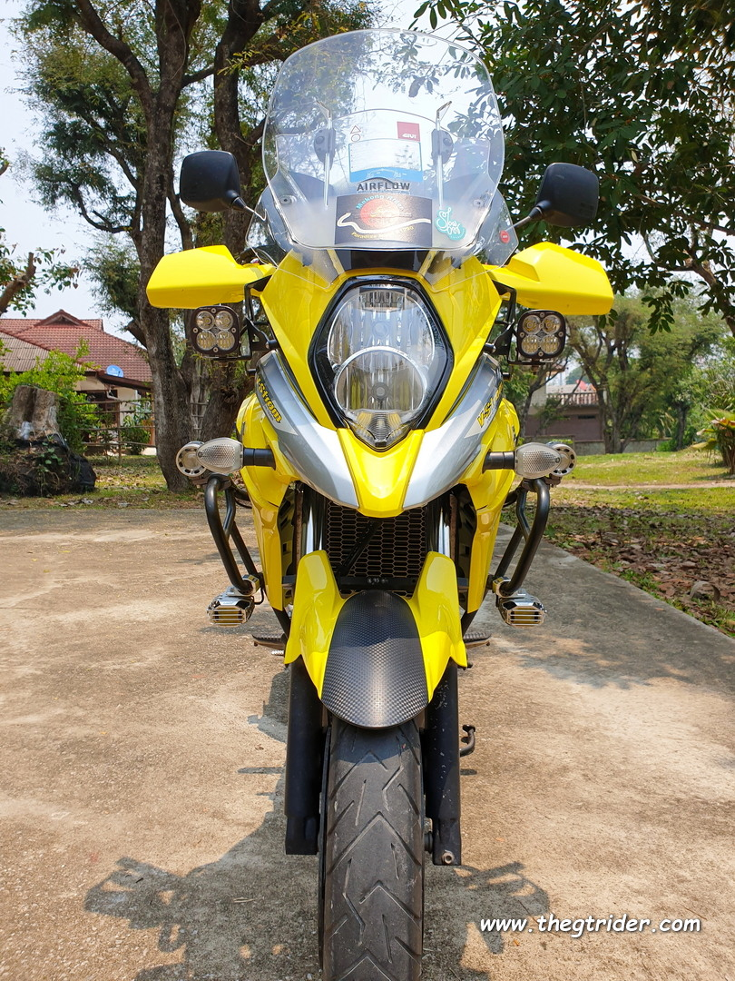

With the Givi screen confirmed as the one to use on the bike, the next step was fitting the 3rd set of spotlights, & the main set, the Baja Design lights on the bike - 20W Led Squadron Sport lights.

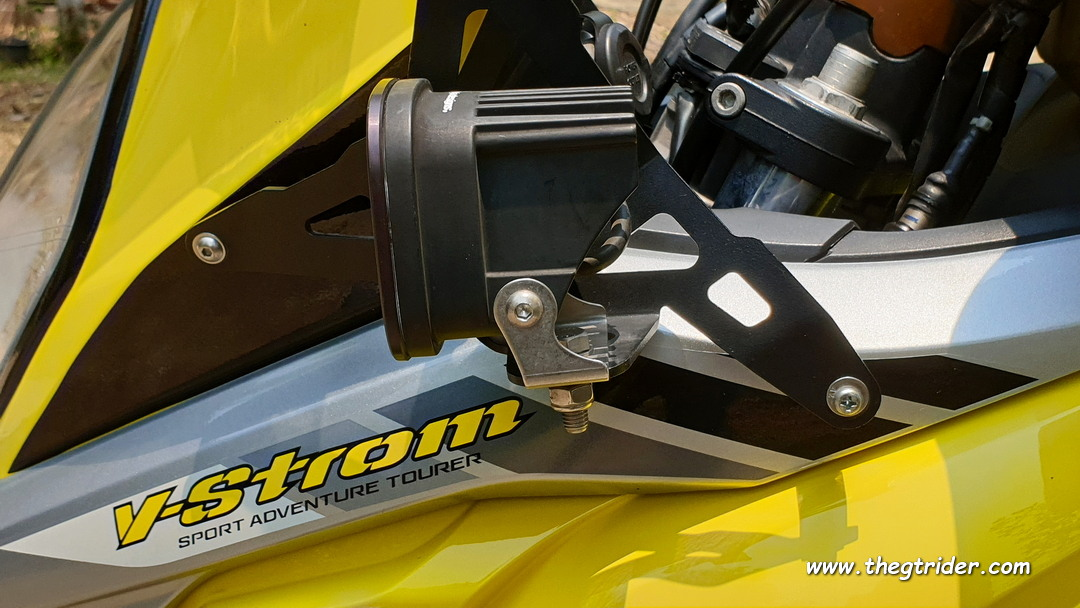

The ideal position is always up high so they can shine down the road & give you good vision to where you are heading.
Originally I had thought about trying to mount them on the front of the screen, using the screen brackets, but this turned out to be unrealistic.

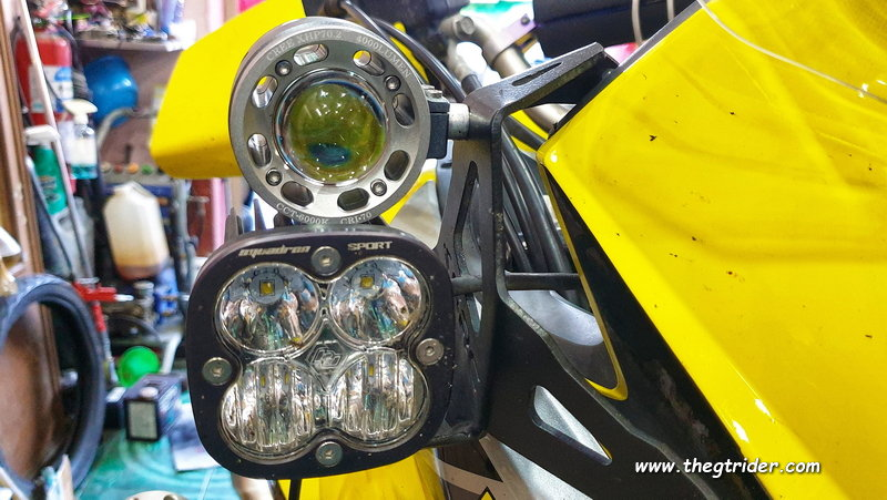

So the only other decent spot was up on the side of the fairing.
I had SRC brackets on the spotl;ights that bolted straight onto the 2015 bikes, but the 2017 bike has a different fairing & there is no metal frame under the fairing to bolt mount them onto; so Kong Electrics in Chiang Rai, came up with a satisfactory idea of drilling holes in the plastic & using small "boots"? to bolt them on.
Job done

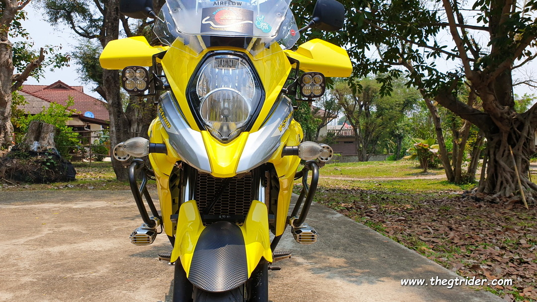

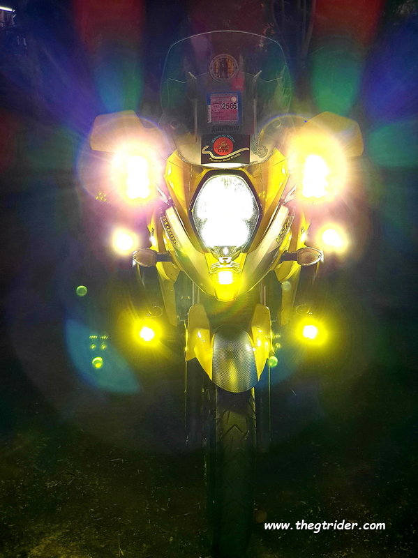

I now have 3 sets of spotlights on the bike for night riding that I enjoy.
The bottom set of lights are yellow Loboo, that I use as running lights. in the day.
The middle set of lights are Loboo
The top set are Baja Design
The next step, a night time test & setting them up focussed correctly.

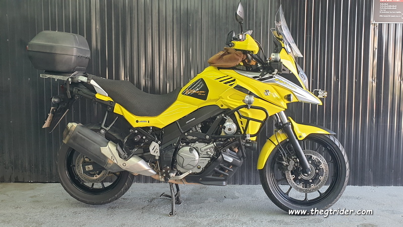

32,710 kms.

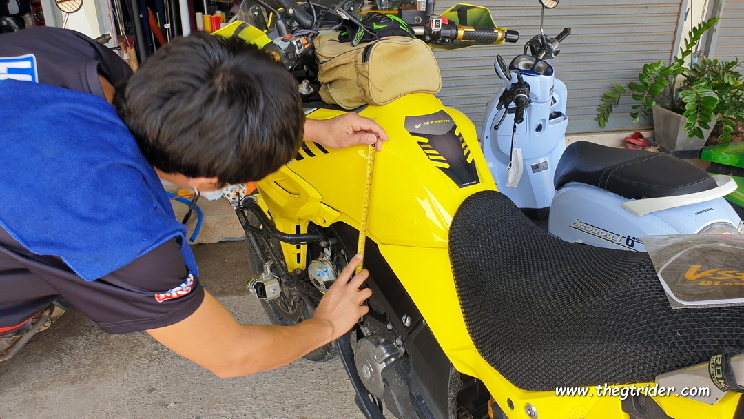

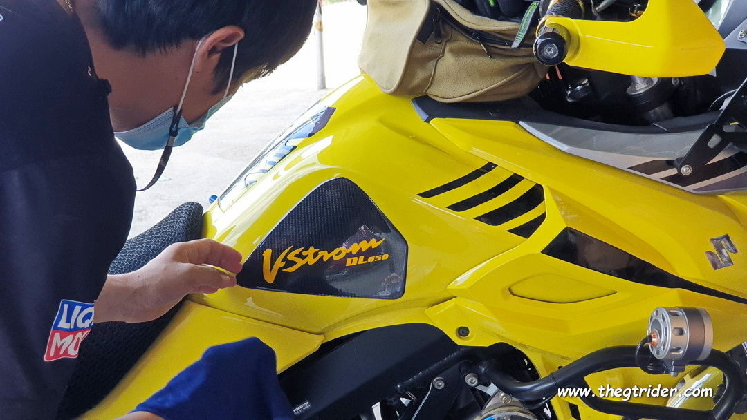

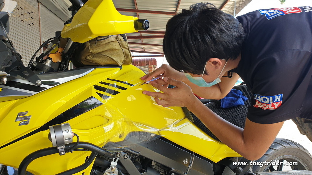

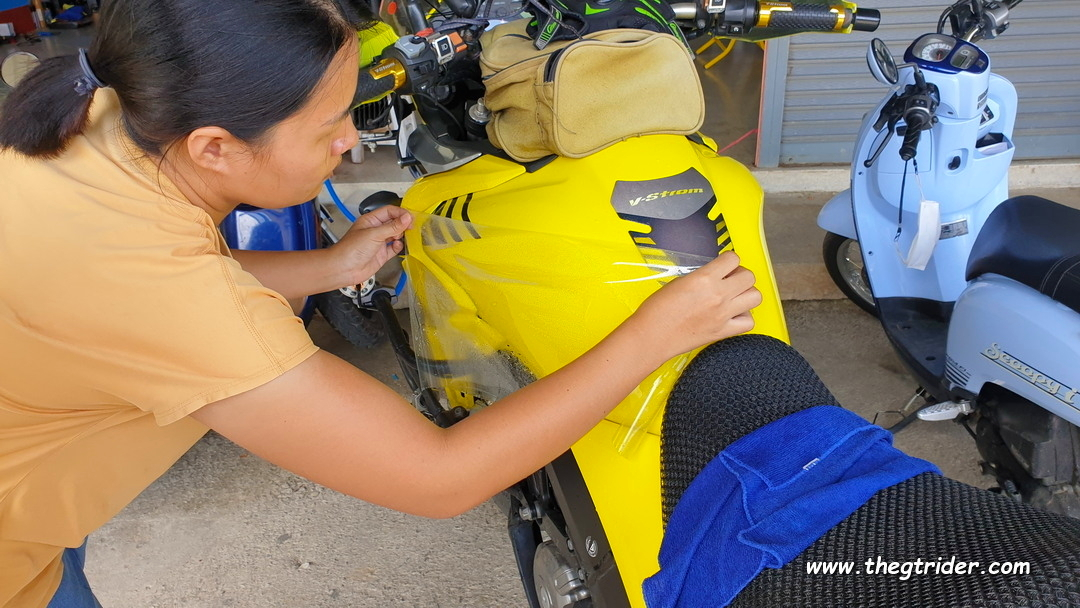

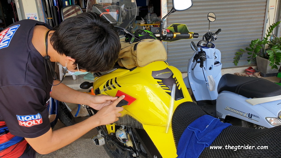

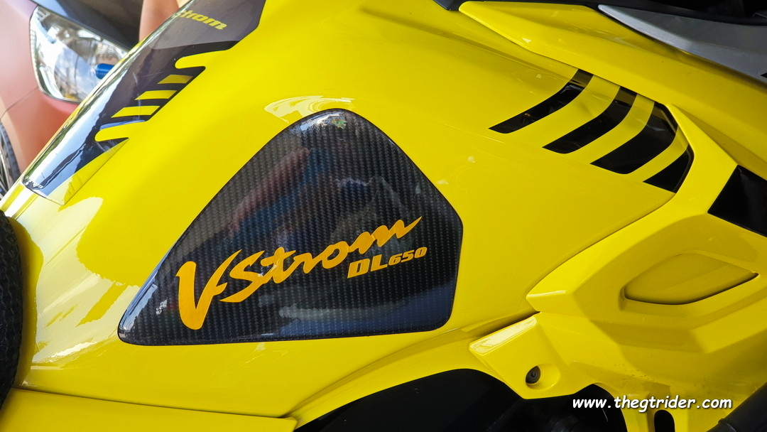

Fitted some tank pads, hopefully to stop the scuffing from mounting / dismounting on the bike
Sourced from Lazada as is usual nowadays.
First fitted a clear sticker film on the side of the tank & then put the pads over that.
400 baht at Ting Sticker Chiang Rai.

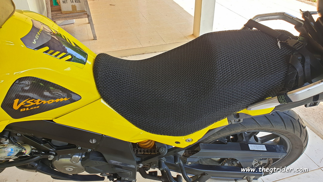

The bike also has a mesh seat cover now - how did we ever ride without them?
It has transformed my seat yet again!

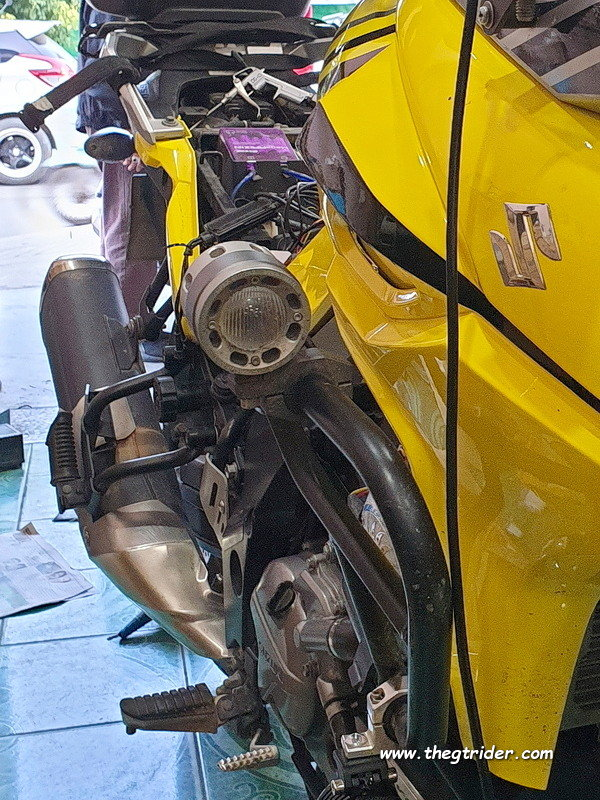

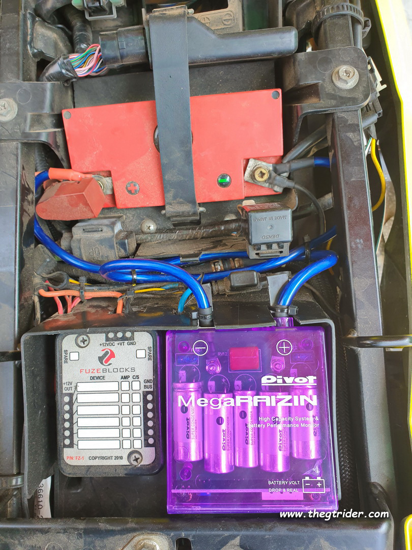

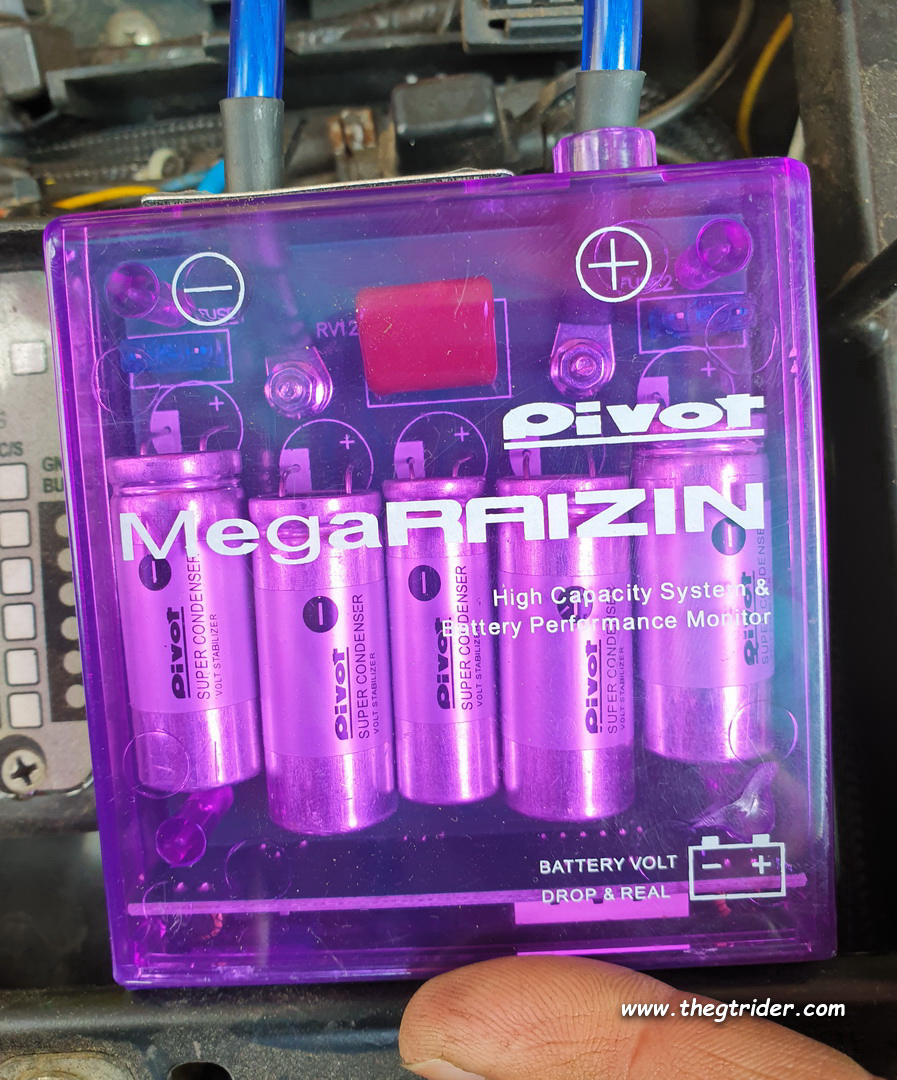

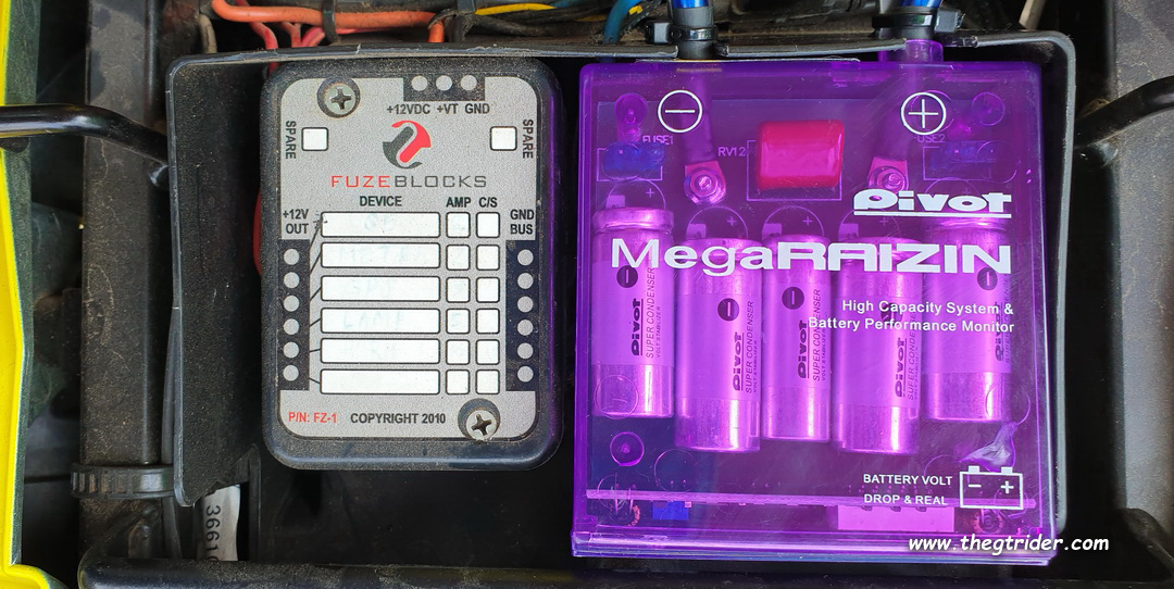

After fitting all the spotlights, multiple people have expressed concern about the electrical & charging system being able to handle it all.
I actually don't think it is an issue, because in practice not all the lights are on high together for long periods of time, as other vehicles are coming & you need to turn off the high beams.
However Kong in Chiang Rai suggested a lithium battery power pack, to piggy back onto the main battery.
The model he suggested I try was only 600 baht so I thought why not. It is cheap enough give it a go.
Slotted in alongside my Fuzeblock where all the accessories are routed.

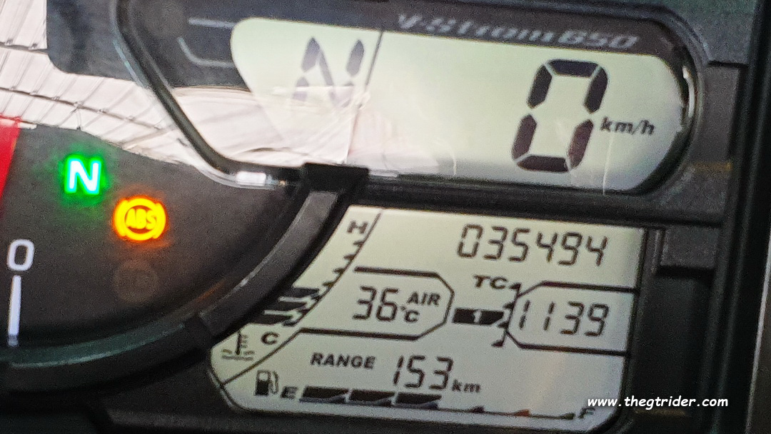

The big picture & time for a quick clean to get rid of the dust, that accumulates so quickly.
And we now have 35,494 kms on the clock = 11,836 kms since purchase in February 2021. May the good V-strom times continue to roll on.

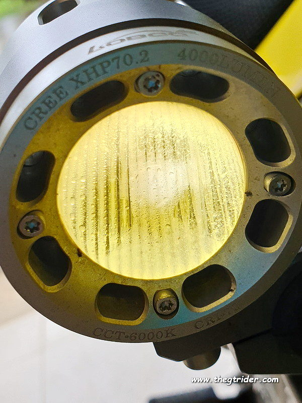

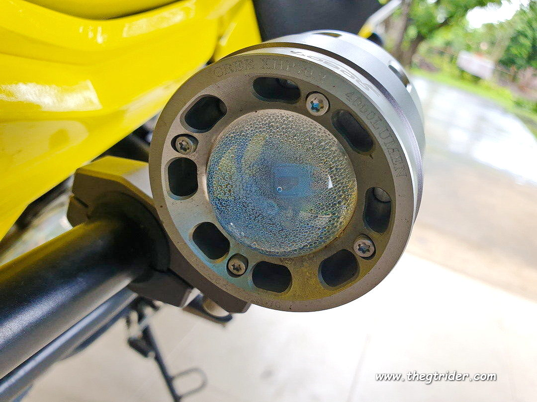

Interesting re the Loboo spotlights fitted.
After some serious riding in torrential rain, I now have 2 spotlight failures on the right hand side.
Yep that's right, both the right hand Loboo lights have failed.
The top Baja Design lights are still working perfectly.
So let's see how a warranty claim on the Loboo lights goes in the coming weeks.

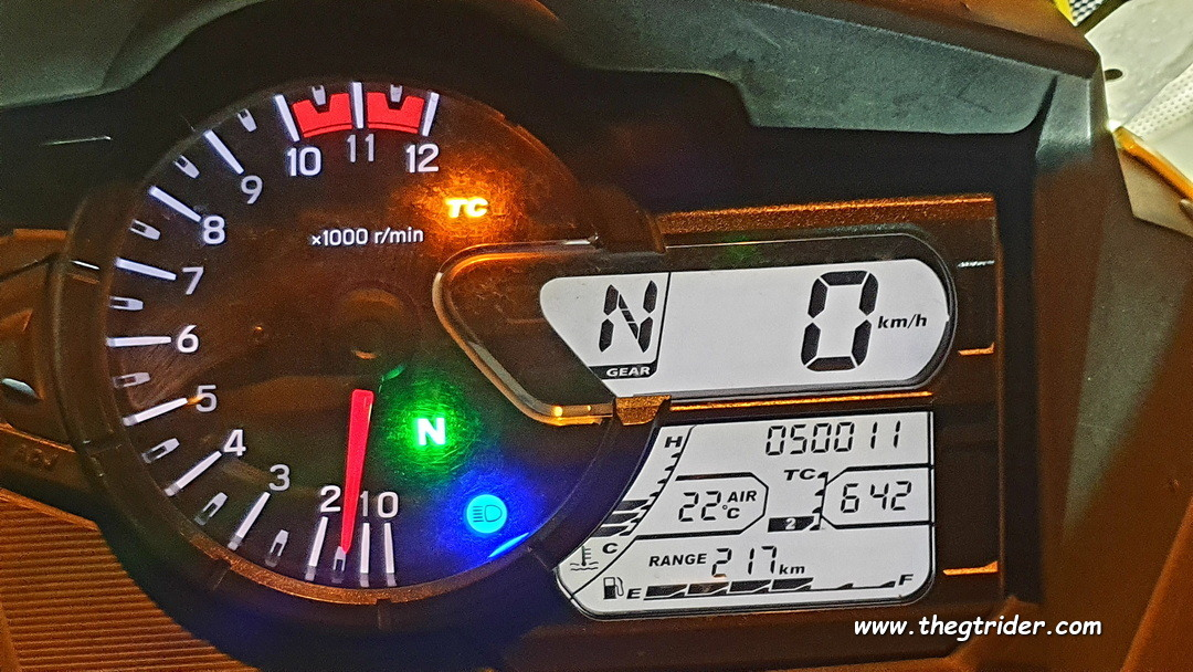

50,000 kms showing on the Vstrom now = 27,000 kms since February.
252 days = 107 kms a day.
The only issue so far has been a faulty 02 sensor as detailed here.
There has been a spotlight issue with the Loboo spotlights, water ingress. Too much riding in heavy rain.
1 set has been replaced under warranty, and the second set is being inspected now & under review.

2. 1 set of yellow Loboo for running lights, purchased via the late Steve Prince. These have been excellent performers for 55,000 kms, but recently one light failed. An examination showed that it was not the light, but the control box. A sealed unit that we failed to open & seek to repair.
3. 1 set of white Loboo lights. One set failed with water ingress & performed badly. These were part of another set purchased by Dave DKT, where he bought a pencil beam set & I bought a wide beam set. Then we swapped one light over, so we both had one wide beam & 1 pencil beam. The pencil beam was installed on the right to focus down the centre of the road & the wide beam on the left to light up the edge of the road. A complication then arose with a warranty claim for my set that the water got into. The dealer wanted a complete set back with matching lights. One complete set was replaced under warranty, & the other set had the seal only replaced. Not quite what I was expecting, but that’s how it goes.

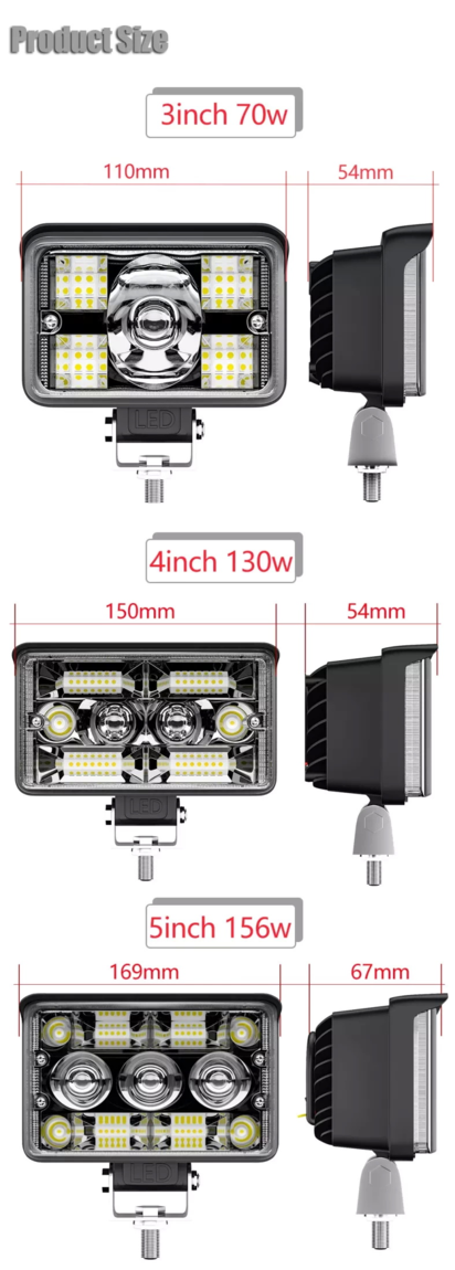

3"4"5" 70w 130w 156w Spotlight LED Light Bar Work Light Yellow White Off Road for Driving Truck Motorcycle Fog Lamp Headlight | Lazada.co.th
3inch 70w:16pcs+1LED (two-color white and yellow)
4inch 130w:30pcs+2LED (two-color white and yellow)
5inch 156w:24pcs+3LED (two-color white and yellow)
Too good to be true?

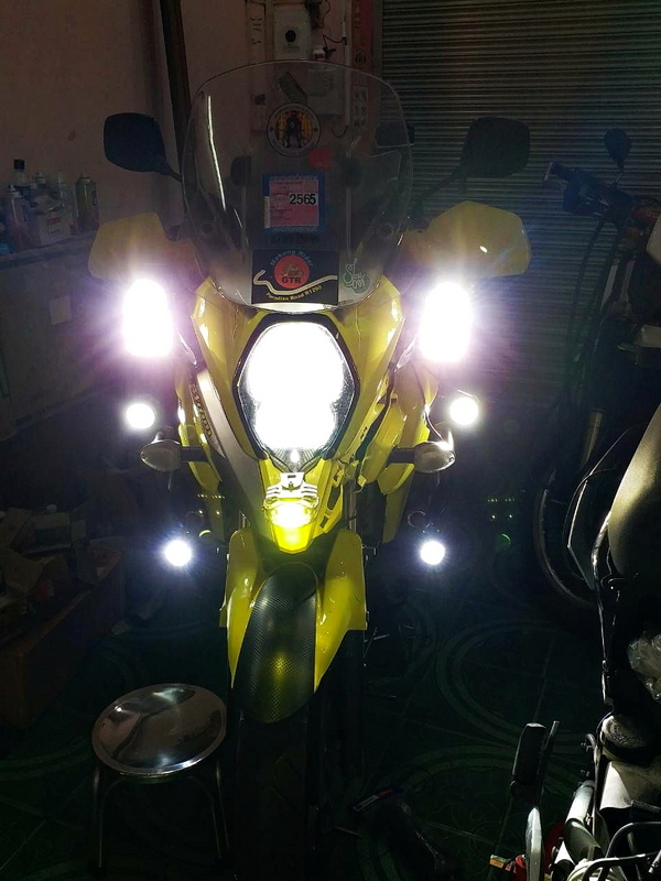

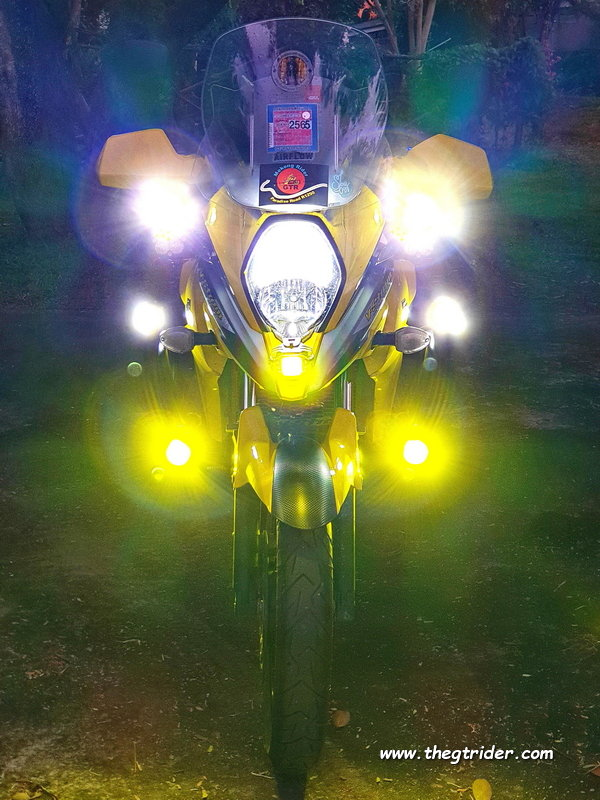

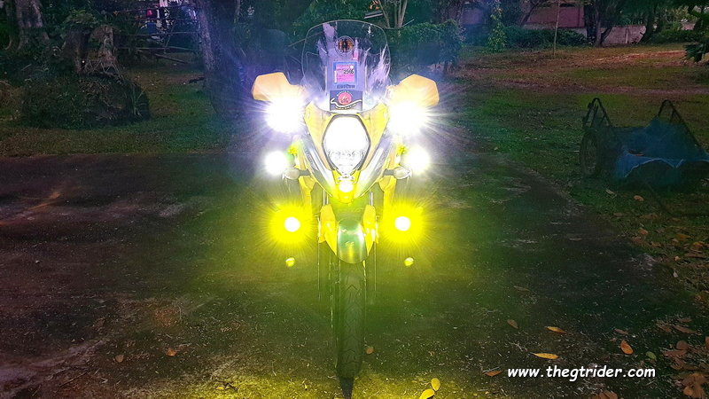

Lights are on. 2 days of rewiring & fitting. Kong is a genius getting it set up properly.
A test run in Kong's workshop.
Standby for a test run & some more detailed photos.
Reactions: Deano747
14,875
5,661

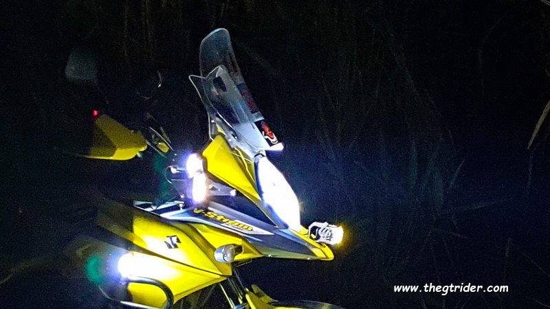

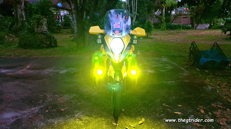

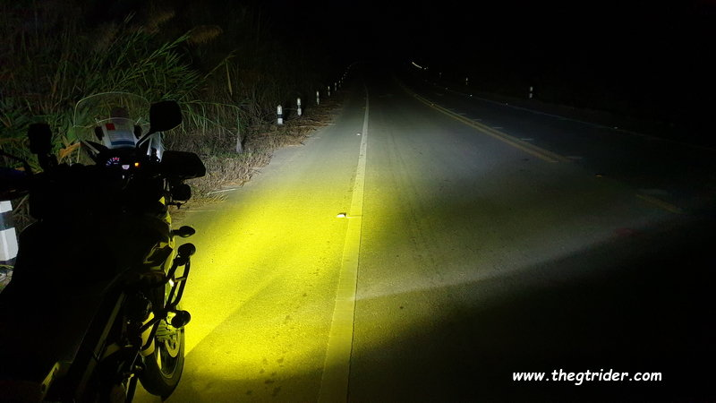

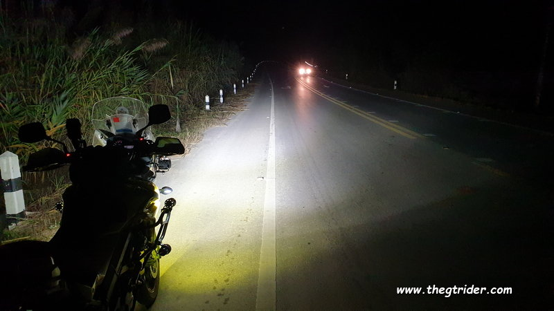

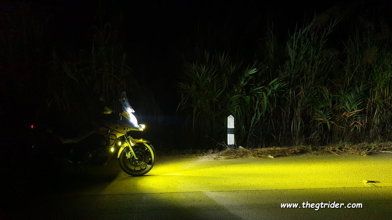

Update testing lights at night

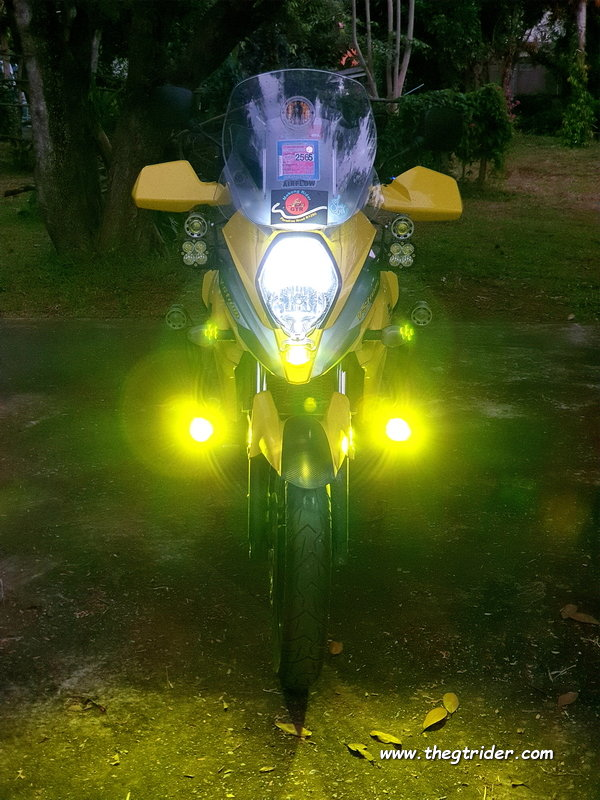

1 centre yellow running light for day time use around.
This single light is from the 1st set of Loboos I bought via Steve Prince, but after 50,000 kms 1 control box failed (no complaints after 50,000 kms), so I ended up with 2 working lights.
I had thought of selling them, but realized I would not get much for them, so decided to keep them & put one on the front centre for day time, a running light for use around town; & so now have a spare back up light.
Then for day time running lights on tour, out of town I bought a set of 60W Crees @ 1200 baht.
These are placed low down, where the original yellow Loboos where.
At 60W they are too bright for use around town, but will certainly get you noticed out on tour.
I'm a fan of yellow running lights, as they are more obvious, stand out more when there are so many vehicles - bikes & cars - with white running lights on the road. Yellow is the way to go.
These spots also have yellow lens can also be removed to have a bright white light.
However I don't feel I need to do that with the other spotlights I have on the bike.
So the real deal spotlights = Loboo.
Both the white sets I bought from Jamie at JJ Enginering.
I had some trouble with these lights in the wet season with water ingress, but Jamie saw that the warranty was honoured & the lights replaced (1 set) & repaired (1 set). Nice work Jamie, your efforts were much appreciated - excellent work.
The question was where to mount the 2 sets?
I had 1 spot already mounted mid level.

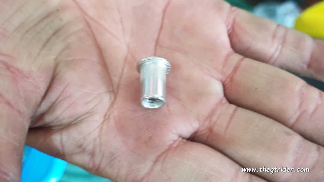

Where to put the other - as high as possible. Kong came up with a perfect solution, with the result the set was piggy-backed onto the original Baja Design bracket, with the Baja Design lights.
The Loboo spotlights have 3 levels
Low - 10 Watts / 800 Lumens
Medium - 36 Watts / 4000 Lumens
High - 76 Watts / 8000 Lumens

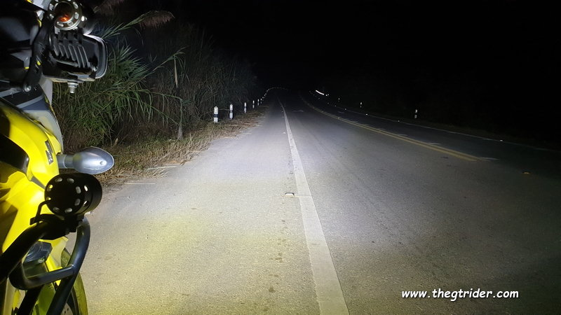

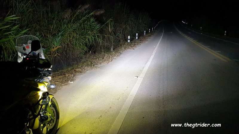

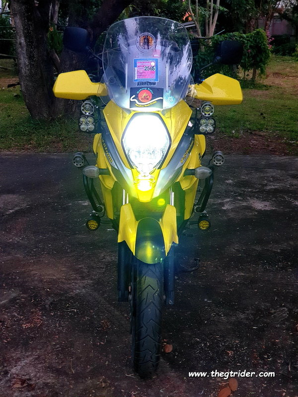

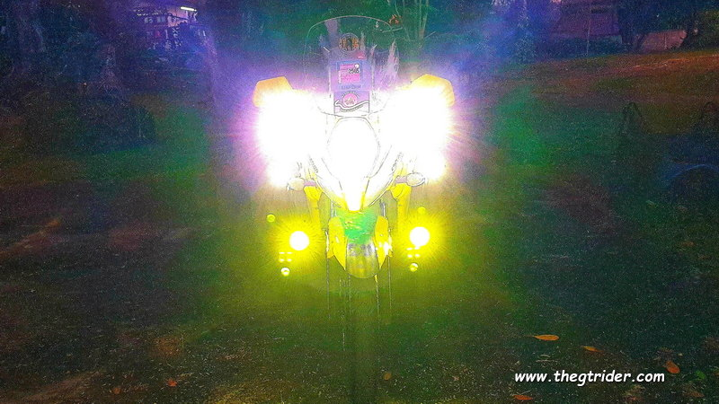

With the all spotlights all on low
With all spotlights on high.
Blinding light, & exactly what I was seeking for safe riding at night.
A couple of poor shots out on the road, facing up an incline.
I need to go back out a 2nd time with a riding shot, after I get my rebuilt Ohlins reinstalled early next week.
Some readjusting of the spotlights maybe necessary.
It was not easy setting these lights up. Each set of lights has a manual override switch, that has to be turned on first.
The Baja Design lights are wired into the high beam switch only.
The Yellow Cree running lights are turned on / off manually.
The Loboo lights have separate control box & switches with 3 levels each. I would prefer the two white spotlight sets to be wired direct into the high beam switch, but this more complicated because of the separate control box each set has. However we will have a go at this in the coming weeks.
If anyone needs any spotlight or electrical work I can highly recommend Kong in Chiang Rai.
Can the alternator runs these lights for any length of time, is a valid question?
Well they are not all on for any great length of time, because as a respectable rider / driver, you are constantly dipping your lights onto low beam.
I have yet to run with lights on full high beam for 20 minutes+, that will be the long test 45 minutes on full high; however with the 3 sets of spotlights having manual over ride switches, you can turn off some as you go.
Or that's the theory, let's see what happens in practice coming back from a Mekong Pizza in a few days.
I hope some of you riders find this info helpful.

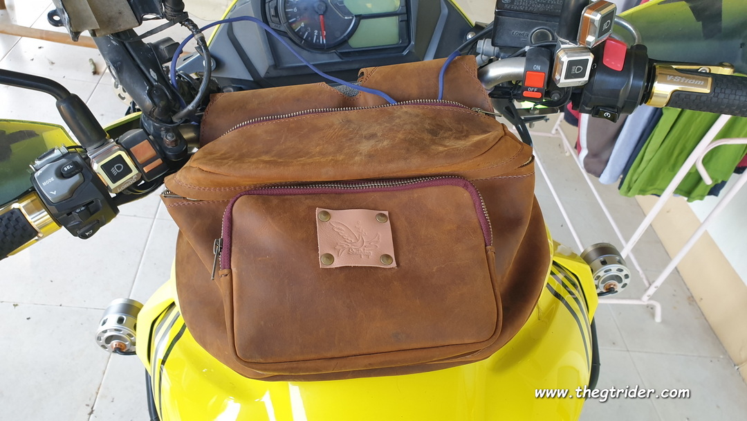

The most useful accessory on my two Vstroms has been the dolly bag / beauty case, pouch on the handle bars.

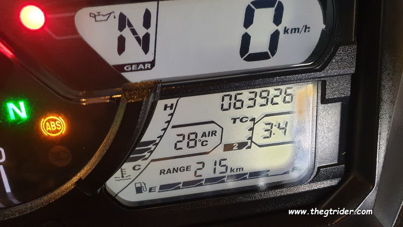

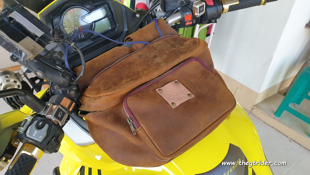

The original one was purchased from Canada & marketed by Gears
img_4972-jpg.87838
img_4974-jpg.87840
It lasted for 160,000 kms before it started to fall apart.
1609403384335-png.138776
1609403413091-png.138777
1609403429380-png.138778

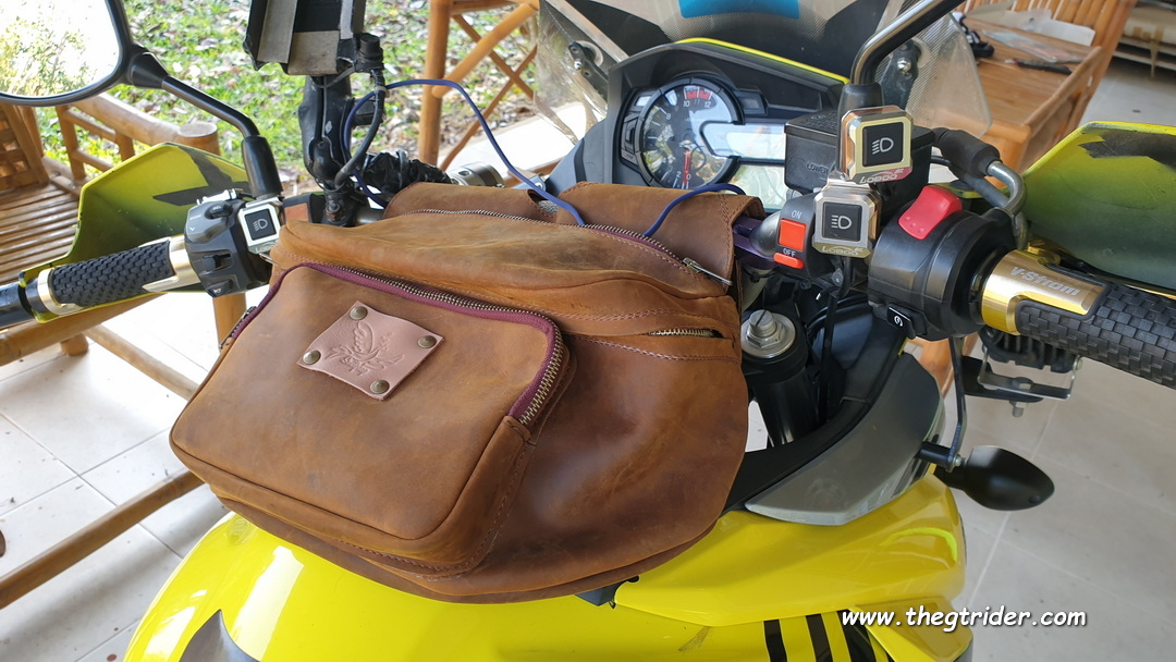

I couldn't be bothered going through the hassle of importing a 2nd one, so tried the cheap charlie way & got a copy made by the zip & boot magician in Chiang Mai.
1,000 baht & hey presto
1609403558823-png.138779
44,000 kms later it was knackered. Cheap material & stitching coming apart. Not up to the rugged job on the old GTR fellah's bike.
So let's test the skills of the new Chiang Rai leatherman / bootmaker.
Tough cowhide leather & double stitched
2,000 baht & let's how tough it is on the yellow GTR machine.
14,875
5,661
^ Will the new bag be waterproof David ?
Good question & definitely not 100% the same as the original.
It will be interesting to see how it goes.
I always have a couple of zip lock bags inside there for the heavy rain, but how quickly any water drains out & / or the leather dries will be an issue. It should not be too difficult to rig up some plastic bag cover for it when the time comes.
