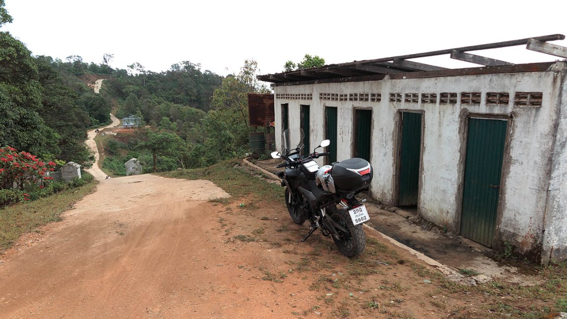

I mean like the steepest part of 4009, the 8-9 km long stretch where the road climbs 800 meter in one go, near the western end. (a part of the 12 km west segment)

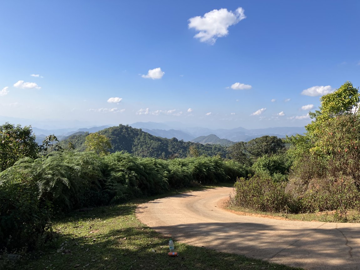

If we think of roads that climbs high in one long exhausting go, the Wat Ko Pha Doh road (doi paper road) that takes off northeast from 105 some 30 km north of
Mae Ramat surely is a top candidate I believe.
(this road is one of a few entry stretches from 105 towards Omkoi area)
From 105 to the junction next to temple high up on mountain ridge where the gravel/dirt starts it's 18,5 km of asphalt and concrete, mostly quite good.
The steepest 9 km long stretch of this road climbs 1050 meter in one go,
so definitely steeper than the steepest 8-9 km stretch of 4009.
On 1249, if I pick the steepest 5.5 km of the 6 km mentioned in before post, the road climbs 780 meter in one go.
(I have never been there, now surely high up on my list of soon-must-to-go roads)
On 4018, if I pick the steep 5 km of the western stretch, the road climbs 730 meter in one go.

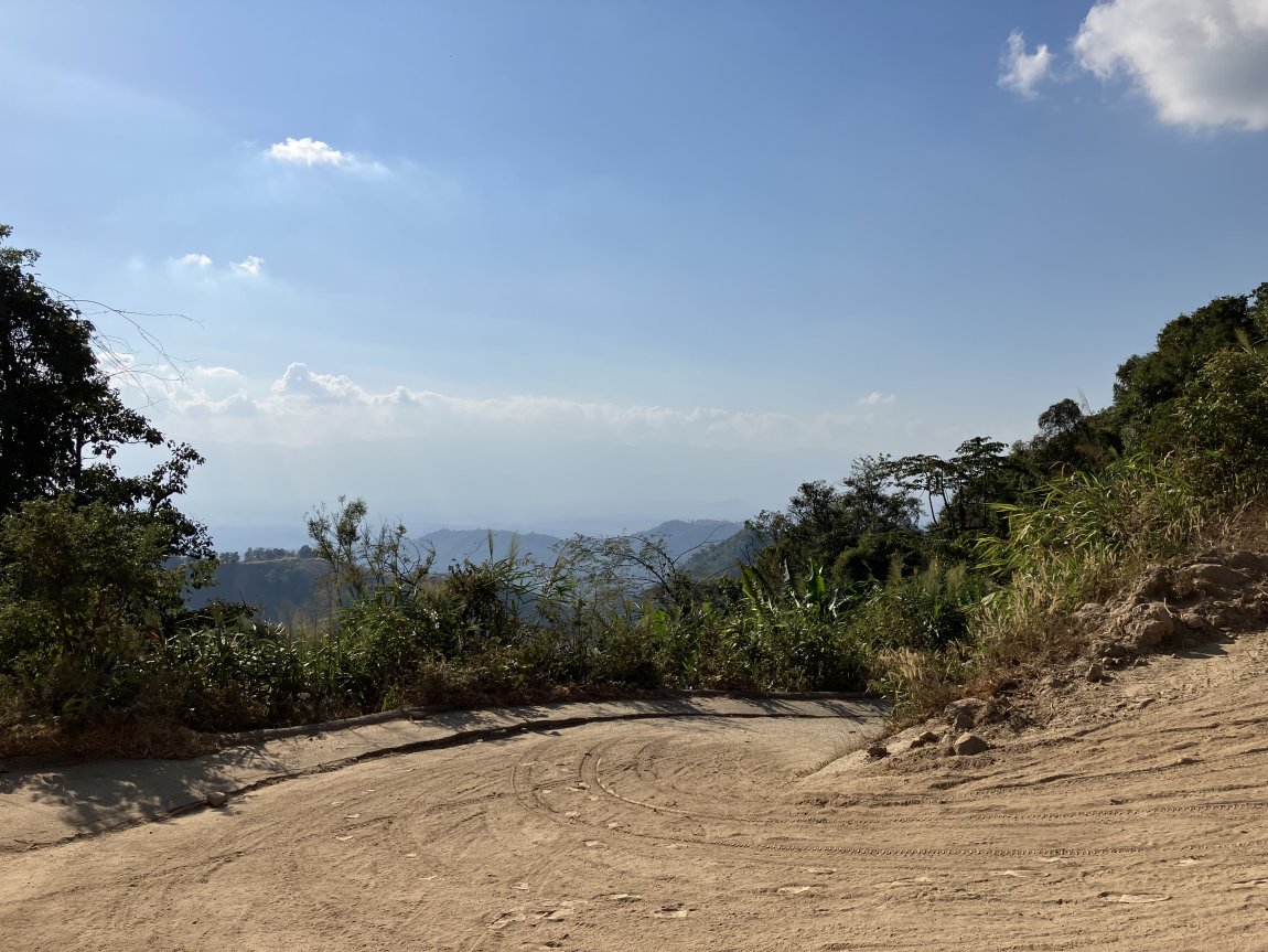

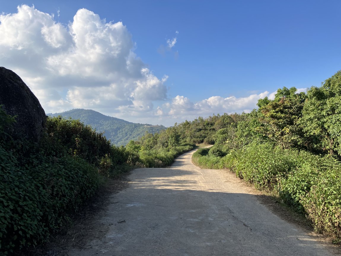

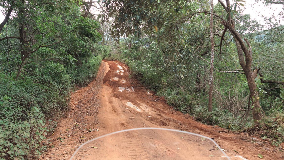

(this road I have been to on a rental 500X, quite scary as a super newbie to thai roads. Super smokey too, so no pics worth seeing)
Concrete under the dust. Part of the steep long brake cooking stretch where you descend 1050 meter in just 9 km
At around 1400 meters up, after the steepest part.

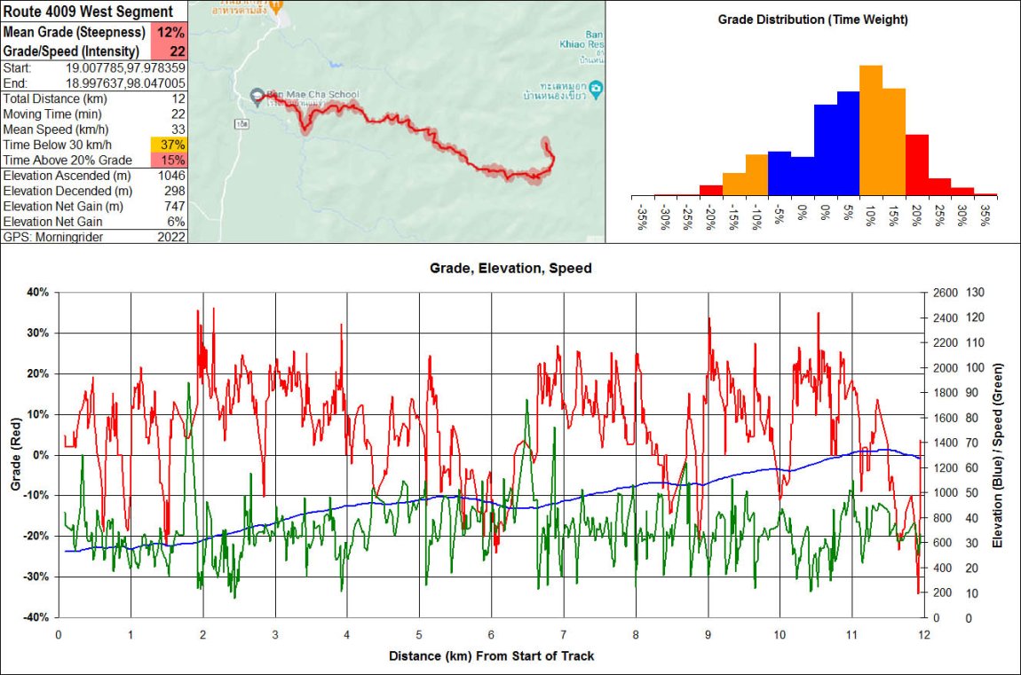

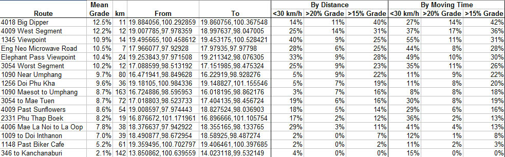

This is how our resident expert Morning rider sees it
Some notes received from Morning rider
Of the roads I analyzed—and please point me to any others that should be in the top ten—the steepest road in Thailand is the “1249 Nor Lae to Ang Khang,” as you expected, but it’s only 6 km long. Of the roads over, say 10 km long, the steepest is the “4018 Big Dipper.” #2 is the “4009 West Segment, and #3 is the “1345 Phu Anma Viewpoint.”
That’s only considering the steepness. But if there are two roads of the same steepness where one is straight and smooth and the other has many tight turns and bad pavement, the latter would be more of a trophy ride. That’s why I added a calculation of “Effort,” which is the steepness divided by the speed to take the road condition into account. Maybe “Terror” would be a better word! If Road A is twice as steep as Road B but one can only ride at half the speed of Road A, which on backroads is due to hairpin turns, loose gravel, rough surface, and/or narrow tracks, then the roads would be tied for “Effort,” even though Road A wins the steepness competition. If Road B is widened and repaved, then the Effort ranking go down. But the steepness ranking will always be the same.
Sorted by “Effort” the toughest road in Thailand is the 4009 West Segment. It is not the Big Dipper, because the Big Dipper is 9% steeper (13.1/12.1) than the 4009 West Segment but it is also 20% faster (40/33) and thus easier to ride. By Effort, #2 is the 1345 Phu Anma Viewpoint and #3 is the Singapore Road. Then the Elephant Pass Viewpoint at #4 and the Big Dipper at #5.
Note there maybe some changes to this list as we double check data.
I see some that need to be double checked.

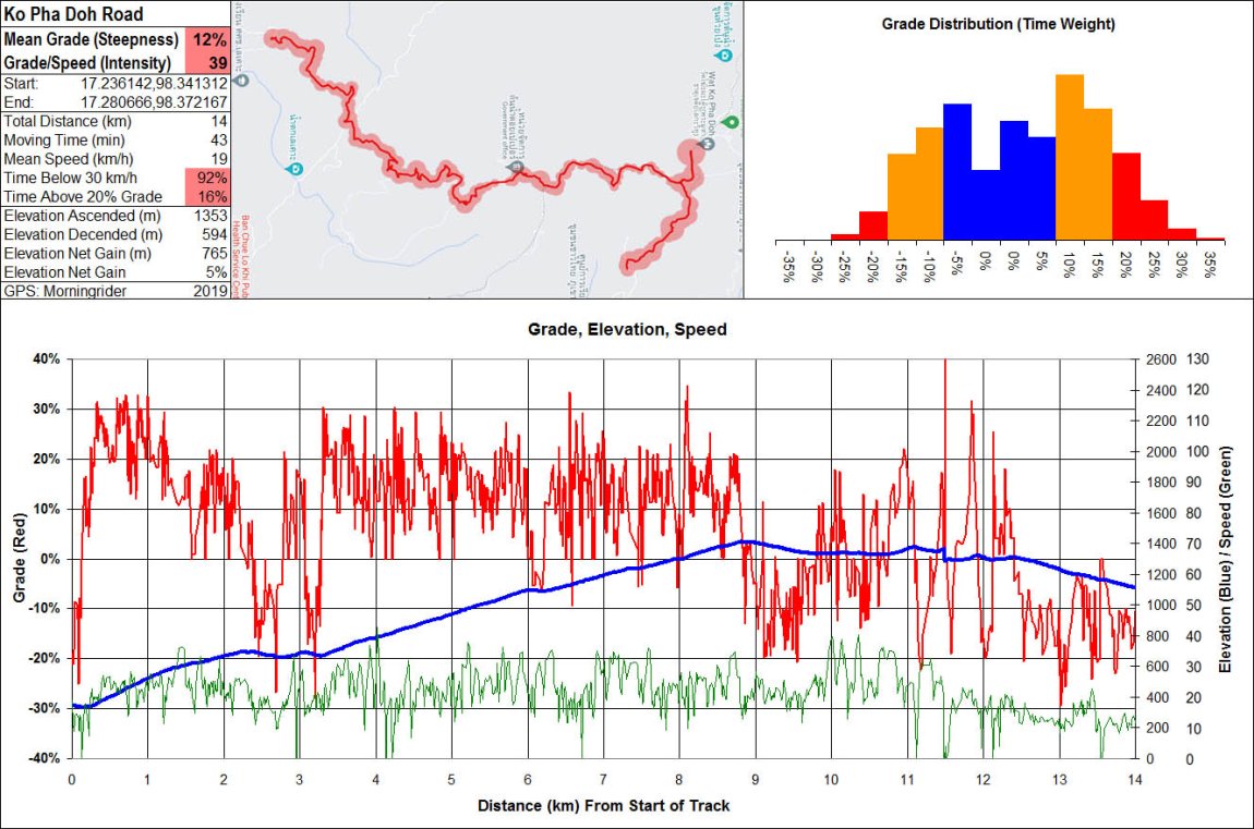

That's an interesting take for sure! Then the Ko Pha Doh road easily tops 4009, it's longer and steeper than 4009's steep western stretch, not to mention the thick bulldust (on top of concrete) in some of the hairpins and slopes! The 4009 was almost dust free two weeks ago.
The last concrete stretch close to the temple junction is not that old

You’re right. I have that track, from four years ago. Of the routes I checked, Wat Pha Doh Road is in the top five for average steepness (11%) but is—by far—#1 for grade/speed (36) because the road is terrible. These photos are taken from the easy spots, where I could safely stop. The surface was poor for street tires, slip-sliding away with long dried ruts a foot deep from 4WD tracks. My hands were shaking at the end of it.
Reactions: Moor66

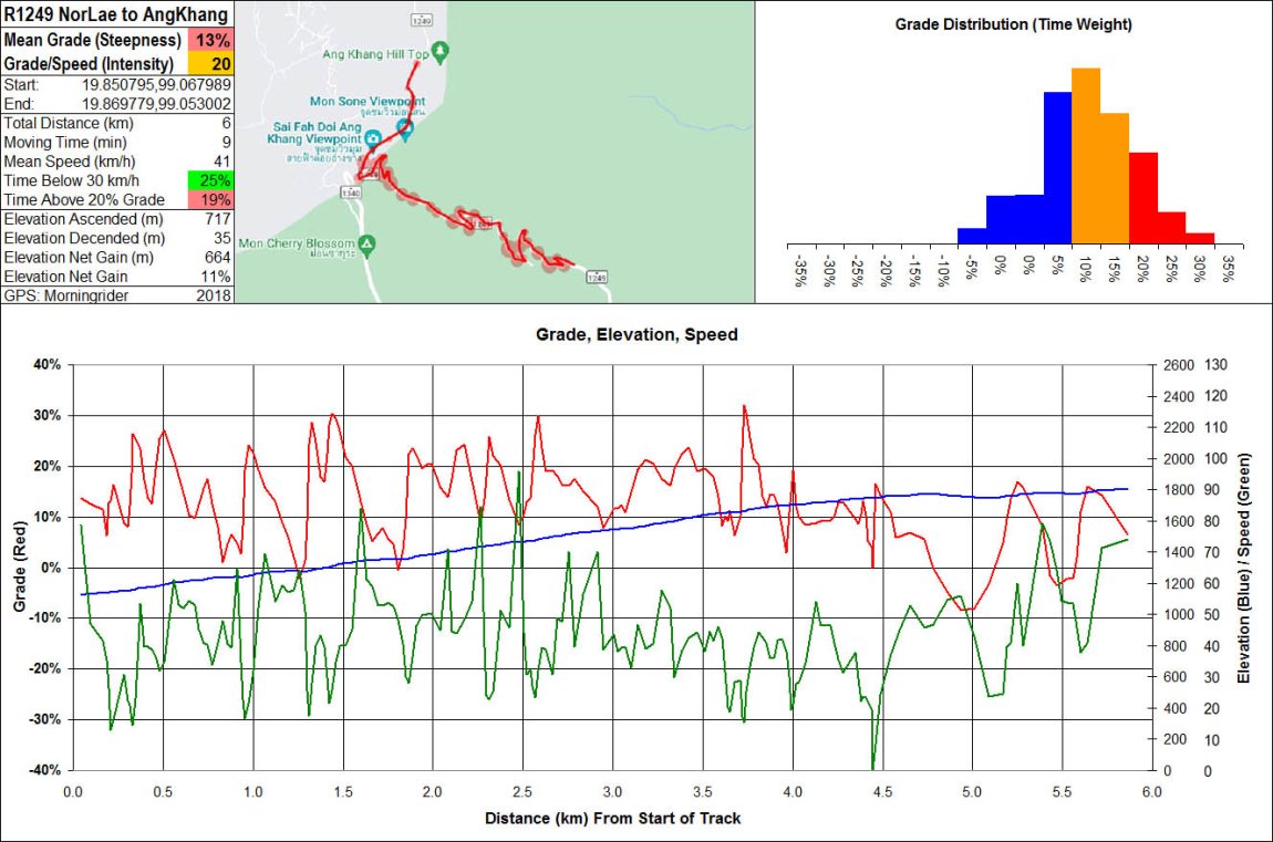

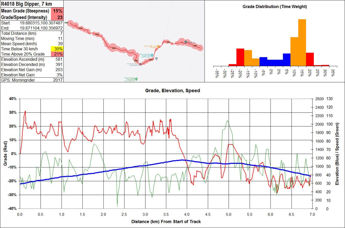

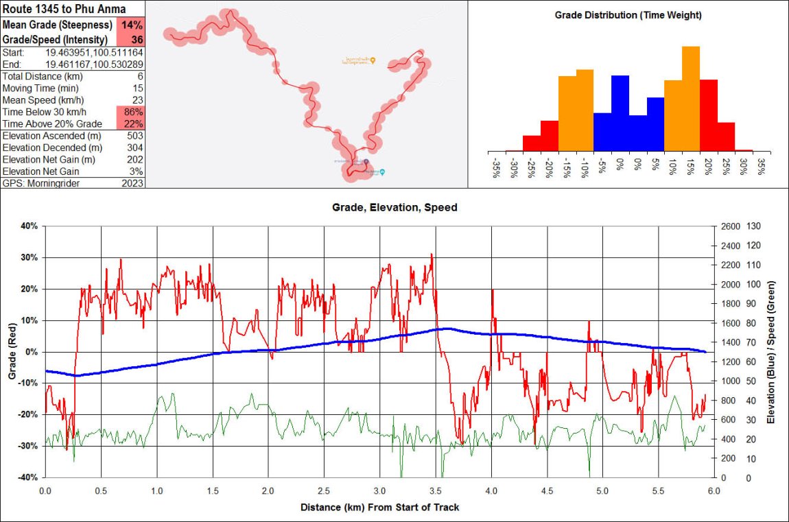

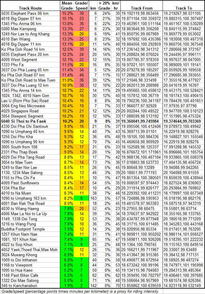

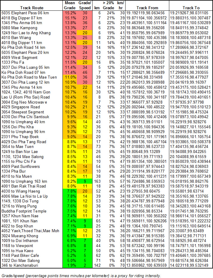

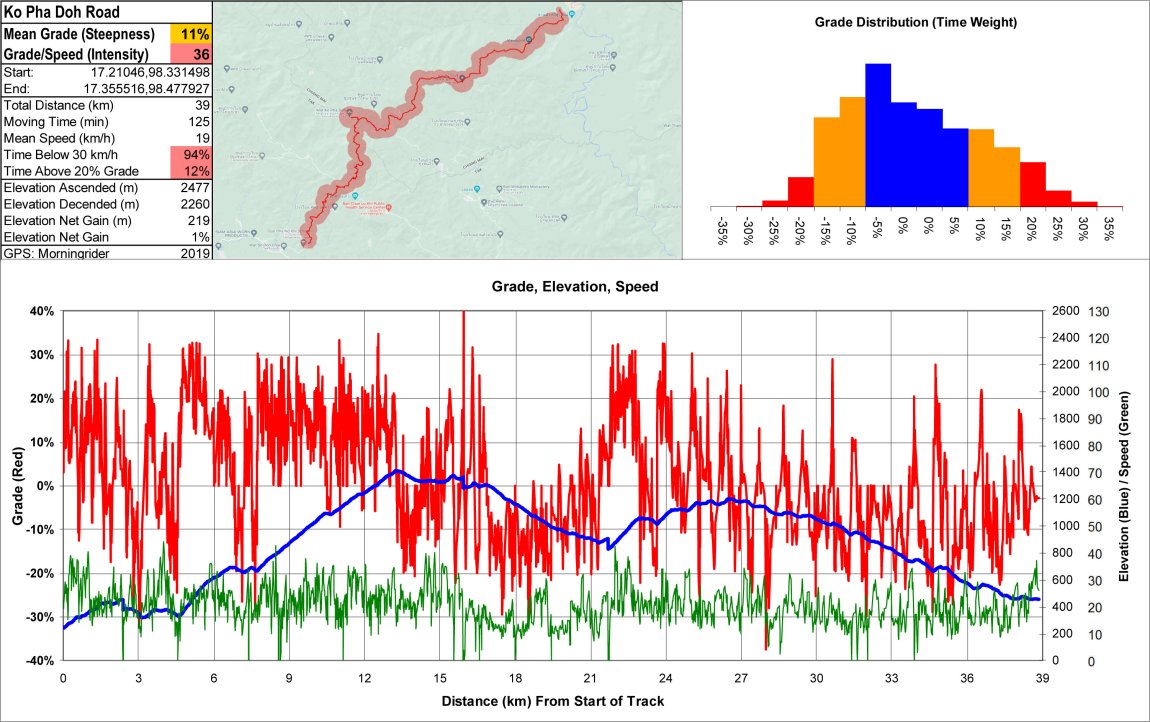

To try to find the steepest paved road anywhere in Thailand, I ran the Garmin tracks of my Thailand rides from 2017 to 2023, 72,000 km, 2 million trackpoints, through GPS Visualizer and then a monster spreadsheet in Excel to identify the steepest 5, 6, 7, 8, 9, 10, 12, 14, 16, 18, 20, 30, 40, 50, 60, and 70 km (16 specific distances) of each of the twenty routes I had taken. I had to use several filters, such as disallowing U-turns because otherwise the steepest routes often turned out to be up and down the same route, thus counting the steepest bits twice. And disallowing ferry crossings when I discovered that walking upstairs from the car deck to the roof with my Garmin Oregon in my pocket was computed as a steep hill in the sea! My ThinkPad took about four hours to process each of the twenty routes, by far the slowest Excel spreadsheets I ever made. Then I manually sorted the steepest of the sixteen distances for the twenty rides to get the steepest of the steepest.
I didn’t include my older tracks because the GPS system elevation accuracy was poor in years past, and anyway my later rides often included the most interesting parts of previous rides. Based on comparing multiple rides over the same routes, and based on comparison of my tracks with tracks GT Rider sent me, I estimate the accuracy of the steepness calculations to be within about half a percentage point.
Steepest means the highest time-averaged absolute value of the grades between trackpoints (measured over at least 3 meters while moving) along the route. I did a second analysis to identify the routes with the steepest grade divided by the lowest speed, time-averaged from trackpoint to trackpoint. “Grade/Speed” is of course subjective, being based on one rider’s speed on one day’s weather and road conditions, but it helps to compare two routes of similar steepness—a faster route usually takes less effort than a slower one (better surface, fewer hairpins, wider track).
These were the twenty rides the computer analyzed, by following the routes that I happened to take on each of these rides and segmenting them into all possible overlapping routes of the sixteen lengths mentioned above (tens of thousands of routes were calculated for each ride):

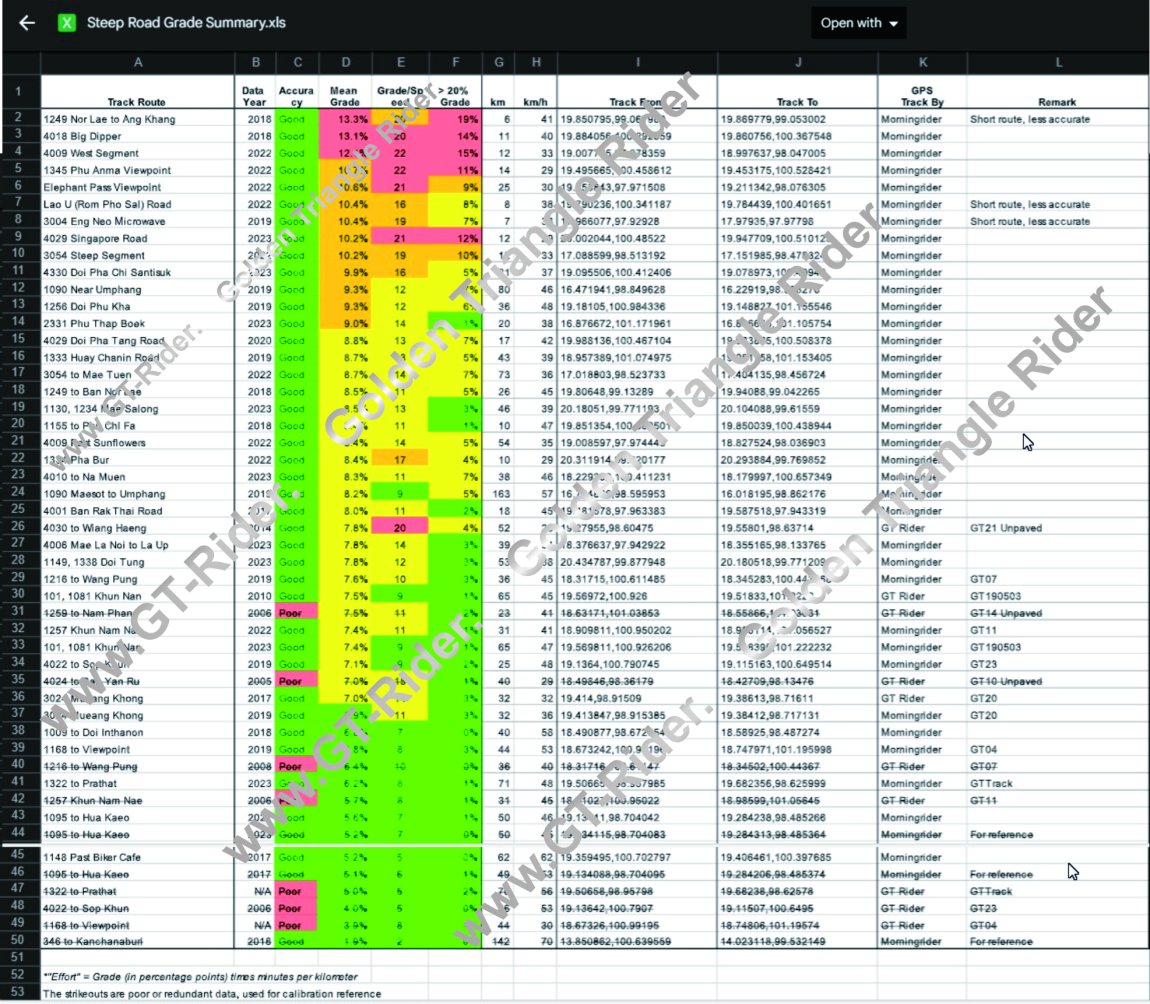

Here is a summary of the results, sorted together with longer routes that I selected manually for comparison:
The steepest roads I could find are the 5035 Elephant Pass, 4018 Big Dipper, 1345 Phu Anma, 5080 Mae Kampong, 1249 Nor Lae to Ang Khang, 4010 Ban Wiang, the Ko Pha Doh Road, 4009 West Segment, 1333 Phu Fa, 3037 Doi Pha Luang. The most intense roads (Grade/Speed) I could find are Ko Pha Doh Road, 1345 Phu Anma, 3037 Doi Pha Luang, 5035 Elephant Pass, 5080 Mae Kampong, 4010 Ban Wiang, 4018 Big Dipper, 4009 West Segment.
Of course, long and short rides can’t be compared with each other but only with other rides of similar length, like marathons and sprints. Almost any ride can be made steep, if you make it short enough.
If anyone has a correction or addition, please PM me a recent GPS track (coordinates, elevations, and timestamps) that should be on this list. I’ll gladly run it through the analyzer and add it. It doesn’t take long.
Here is the same list as a text file, in case anyone wants to cut and past the coordinates into Google Maps to see the (approximate) routes.

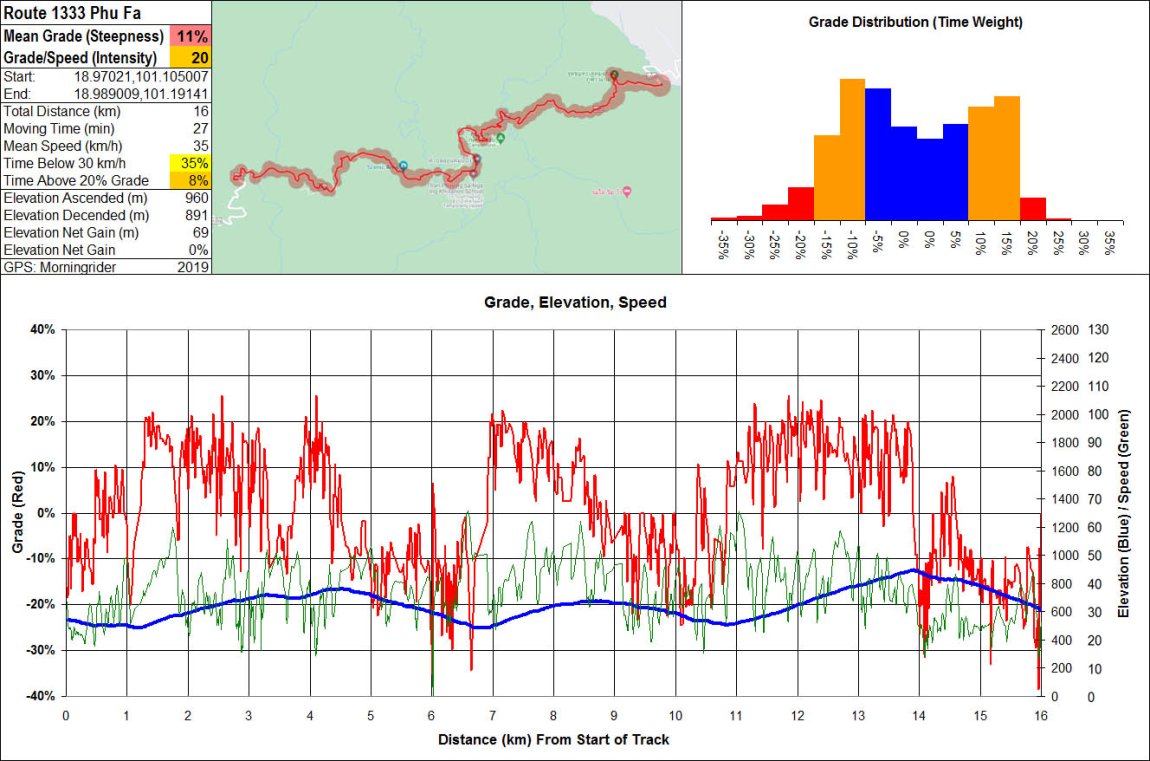

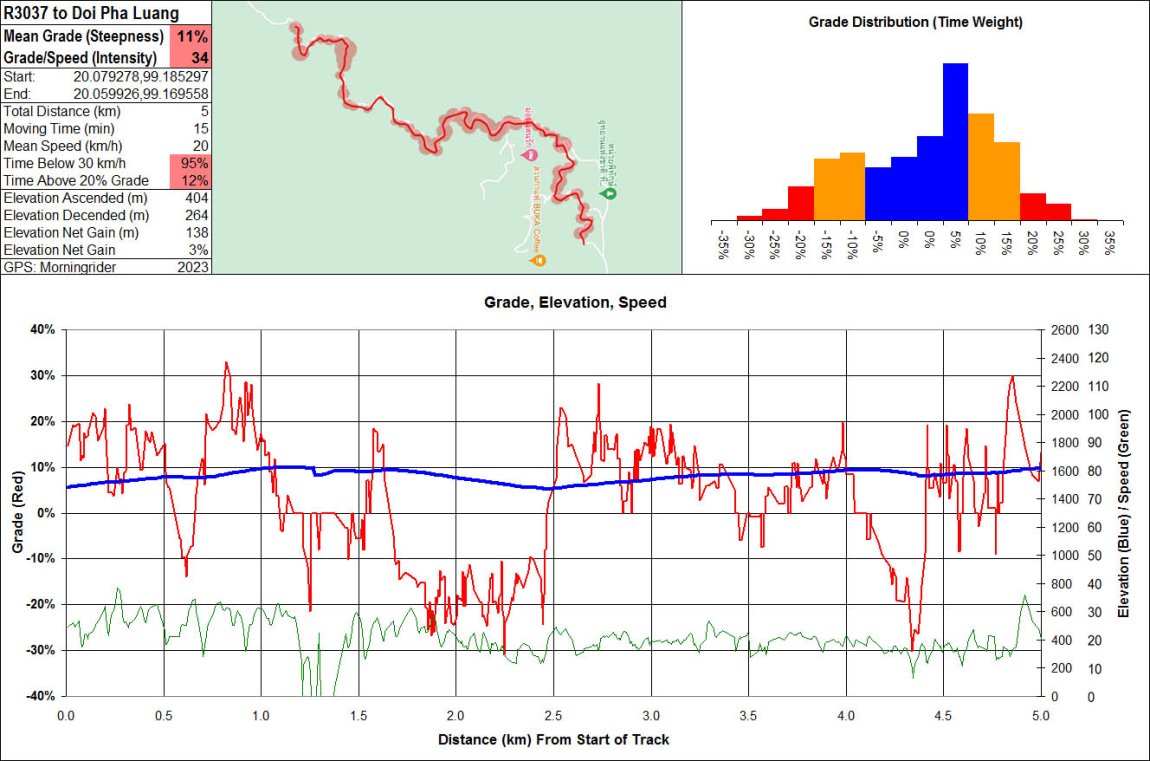

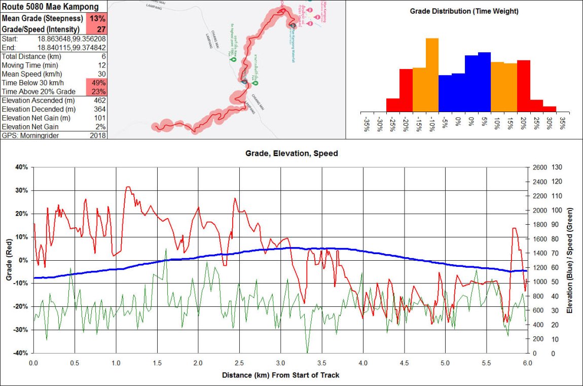

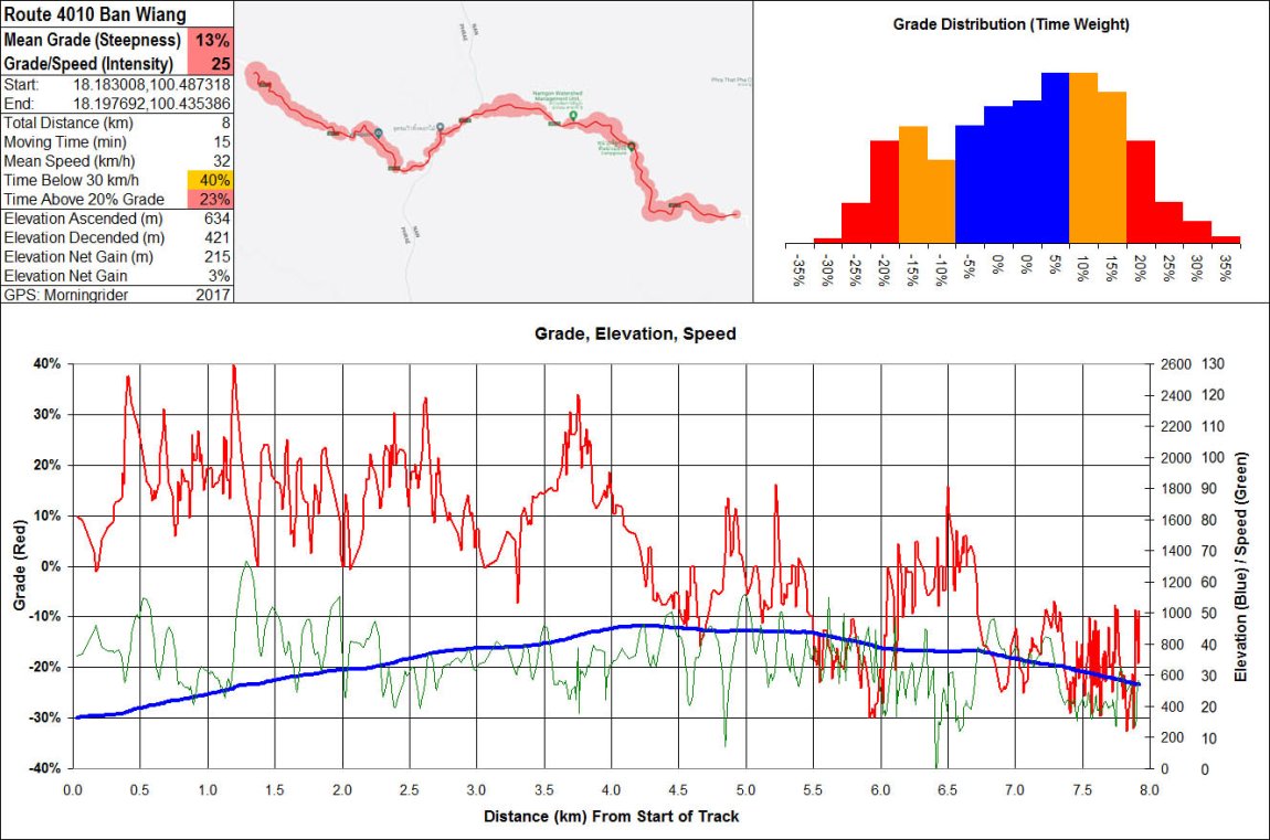

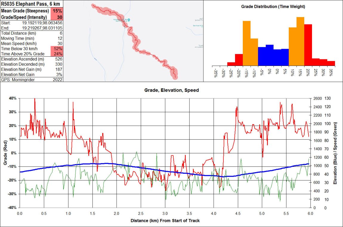

And here are summary sheets of the steepest roads. The area of the pink blobs shows the Grade/Speed at each interval of the route relative to the rest of that particular route—the bigger the blob, the tougher that spot relative to that route. The histograms are interesting, especially the Big Dipper and Elephant Pass, where almost none of those roads is level.
Moor66
Active Member
Aug 20, 2023
21
17.236142,098.341312 to 17.280666,098.372167 > Ko Pha Doh Road 14 km
To me something is very wrong here... these cordinates includes the long supersteep section of the Ko Pha Doh road that goes up north, but then turn right at the high elevation junction, downwards another steep dirt gravel road that heading eastwards
And within those cordinates, some steep downwards riding is included, before the supersteep 9 km long climbing section starts.
Then the other rocky bumpy dirt road that descends a few km eastwards is included.
Confused 55

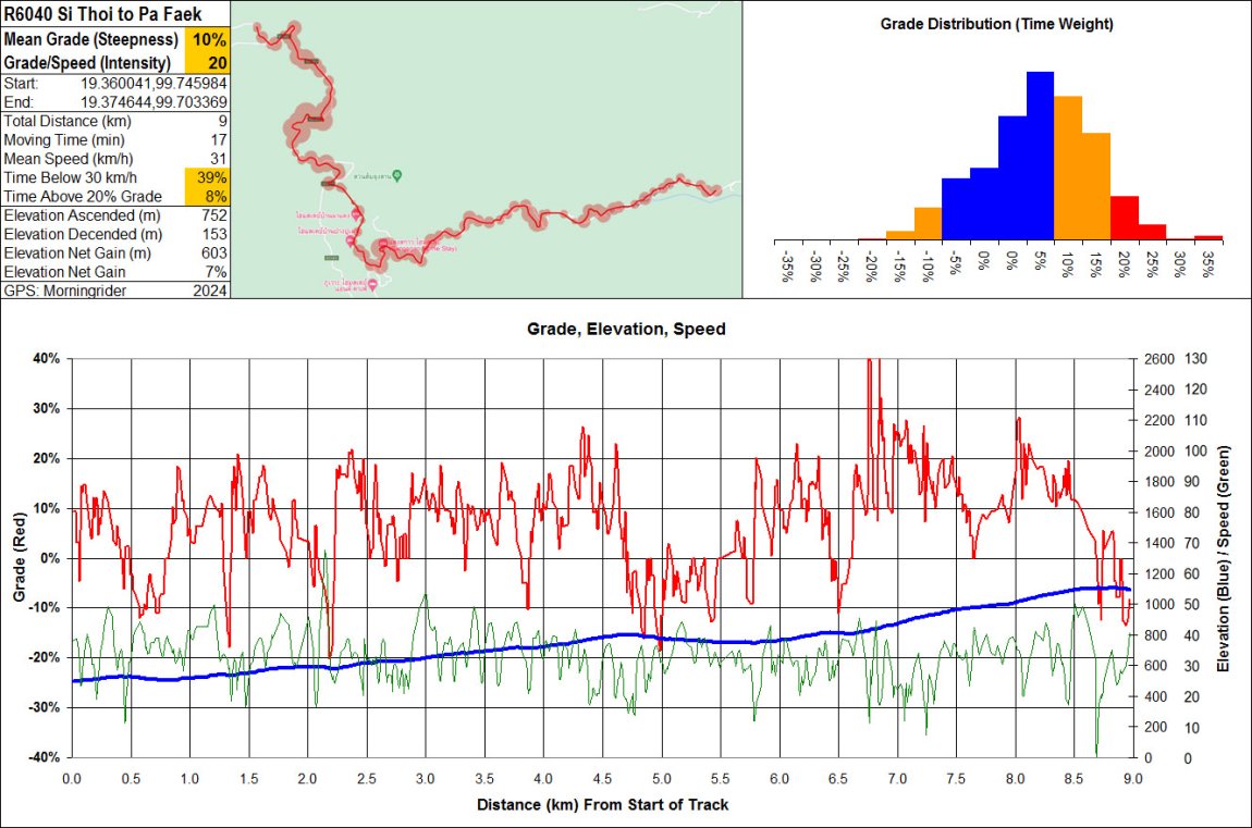

East of Mae Chai I have a candidate. 6040 rises from around 400m to 1000m in about 10kms passing through Si Thoi or colloquially called the coffee village. It then follows the ridgeline to Viewdoi Homestay the last 4kms being dirt.
The dirt then continues 5kms back down to the valley floor at Pa Faek. So the last bit is steeper but not asphalt so doesn't count?
But I don't have the tech to measure it precisely. Managed to get my phone to display elevation though.
Unless my handheld Magellan GPS will do it. (if I can get it to switch on). :idea:I do have an inclinometer I could put on the road.
Confused 55
Sorry for the confusion. Back in 2019 I had ridden what I thought was the Koh Pha Doh Road from the 105 to Mae Tuen, 39 km. stopping at the temple on the way, hence the slight detour in the GPS track. When I scanned my tracks for the steepest and
7 and 14 km rides, those segments appeared. In other words, that 14 km (out of the whole 39 km) was the steepest continuous 14 km of the Koh Pha Doh Road, or more properly, route, since it is more than one road. In the list above that road appears as one of the steepest (and hard work considering the slow speed) at 7, 14, and 39 km. Here is the plot of the whote route to Mae Tuen. The last part of it is part of the 3054 now.

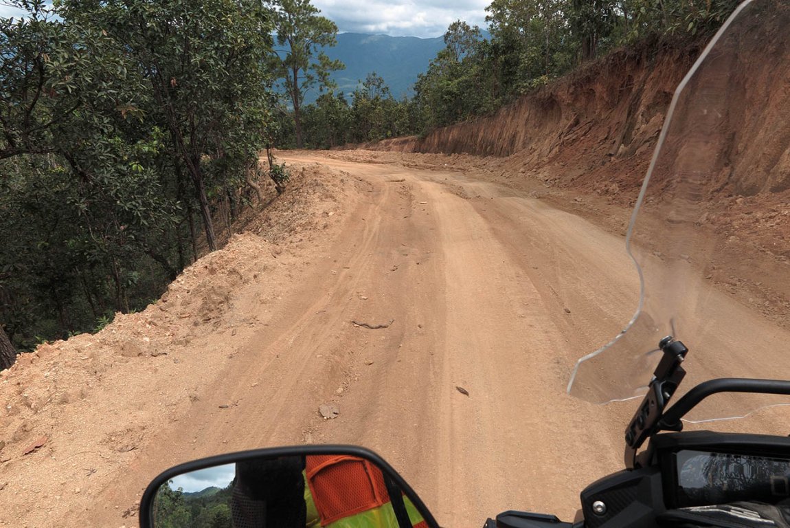

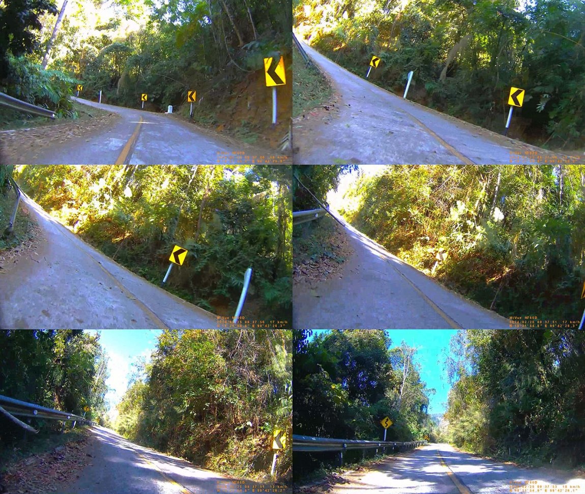

I gave Mike a shout, he shouted back, and we met in Phayao for a ride up the 6040. He led his friend Roger and me to the start of the route and pointed the way at critical turns. The steepest section of the road starts as two lanes of asphalt at 500m and ends up as one lane of concrete soon after it passes the summit, at 1100m. It continues to a village where coffee beans are laid out to dry in the sun and enjoy a wonderful view—and big bikes are advised to turn around where they still can.
According to the GPS track, the steepest 9 km of the 6040 is tied with the 12 km long Singapore Road and with the steepest 12 km of the 3054, all with a mean grade of 10%. Yet the 6040 is hardly known outside the local area. A summary (the area of the pink blobs on the map shows the grade of that section divided by the speed, indicating the riding intensity):
My updated steep roads list (with R6040 in bold)
