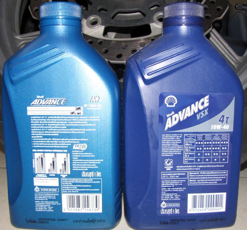

In the case of my Kawasaki's I've trusted the recommendation of the service staff who until recently always recommended Shell Advance VSX Semi-Synthetic 4T motor oil. But Kawasaki Rama 9 recently changed motor oil from Shell Advance VSX semi-synthetic to Shell Advance AX7 and after a couple of track days the new AX7 motor oil turned to sludge so I'm a bit concerned and wonder if you guys can offer any insight about the difference in these oils.
Here are pics for your reference:
I know it's hard to read, but the old Shell Advance VSX is rated API SJ, JASO MA while the new Shell Advance AX7 is rated API SL, JASO MA 2
I have no idea what the difference is between API SJ and API SL or between JASO MA and JASO MA 2
I want to go talk to Kawasaki about the change but want to know what I'm talking about before I go there.
Anyone know what the difference is between these oils?

Standard answer would be a coolant leak. Could it be the "sludge' was always there and the new oil simply flushed it out.
Is there a difference between AX and Ultra? I couldn't find AX on Shell Thailand's site only Ultra.
If staying wth Shell why not use Rimula Ultra. Commercial "diesel' oils have long been touted as the best for bikes with integral gearboxes.

Looking at Shell web site, it seems Shell Thailand sells the VSX (http://www.shell.co.th/home/content/tha-en/products_services/on_the_road/oils_lubricants/advance/) and Shell Philippines sells the AX7 (http://www.shell.com.ph/home/content/phl/products_services/on_the_road/oils_lubricants/advance/#subtitle_2).
VSX market text from Shell:
Shell Advance VSX 4T
Shell Advance VSX 4 is a unique semi-synthetic lubricant exclusively developed for 4-stroke motorcycles, providing excellent engine protection, cleanliness and superior clutch and gearbox operation
- It is specially designed for riders of high-powered bikes who need a superior oil that protects and keeps their bike engine clean in all types of road conditions
- Its balanced formulation means the oil retains its viscosity for longer and reduces oil consumption
- The special formulation prevents clutch slippage and reduces clutch sticking after cold starts
Smoother gear change
- Provides excellent engine protection and performance, keeping engines cleaner for longer
- It exceeds the requirements of international specification (API - SL and JASO MA) and all Japanese and European motorcycle manufacturers
And AQX 7:
Shell Advance AX7 10W-40
Semi-synthetic 4-stroke motorcycle engine oil ideal for high-performance motorbikes. Shell Advance AX7 offers excellent oil-performance reliability, helping to protect and clean your engine and prolong its life. It also provides advanced control with smoother gear changes and an enjoyable ride by reducing noise and vibration. Shell Advance AX7 offers enhanced performance for standard motorbikes, underbones and mopeds.
Key Features
- Enhanced shear stability to dampen vibration and reduce noise
- Enhanced protection against valve train wear
- Special formula keeps oil in-grade for longer
- Optimised friction control for smoother clutch engagement and gear changes
- Removal of sludge and engine deposits
So the sludge removal seems to be standard feature! :)

Simply said change back to another oil and check for similar sludge build up, as maybe you have a water leak. If no excess sludge present dont return to AX7 oil.
I wonder how much on description of AX7 is sales talk. It aint healthy for sludge to be present in oil so this should ring alarm bells.

The Shell oils are group 3 and 4 oils and are not really semi synthetic at all , Shell have run into problems in USA when claiming synthetic qualities in their oils.. Motul Synthetic is a full group 5 oil and is completely synthetic
It is probable that the ASX has extra cleaning detergent compound in and that loosened the deposits in the engine ..personally i would use another oil brand , Motul is the best in thailand or mobil1 , but castrol or honda products are OK too. In my Ducati here i use Motul or Mobil , in UK i use Putoline.

I've changed the oil and filter and will do another track day with the Shell Advance AX7 and see how it goes. This is Liam's old ER6 and when I bought it, it only had 9000km on the odometer and I know he rode it gently and serviced it regularly. Since I've had it, it's only been used for track days, so ridden hard, but not for any great distance/duration. I was shocked at the condition of the AX7 oil after a couple of track days.
Yes, it's quite possible that there's a small coolant leak that's contaminating the oil... Hopefully she'll hold together for the Pirelli Track Day on Sunday after which it may be time for a re-build...

API is the American Petroleum Institute which began grading oils at the beginning of the 1900’s
The grading started with the designation SA and progressed through different S grades and now the latest is SN
Current API grades include SN, SM, SL and SJ for petrol engine. All previous API service designations are obsolete. So any one of the above API categories is ok to use.
JASO is the Japanese equivalent (Japanese’s Automotive Standards Organisation) of API and the MA classifications is to show the oil is suitable for wet clutches.
So there are no problems mixing those two oils and they shouldn’t have caused any sludge to build up.
If there is water leak it can only be coming from the head gasket or the water jacket around the cylinders or the water pump shaft may have a seal leaking between the water side and the oil side.
This would be the likely place to leak I would say.
If it were the head gasket the power loss would be noticeable and it would probably miss fire. If it is the water jacket the cylinder block will need replacing if it is so corroded the water is leaking into the crank case. This is unlikely at the age of the bike.
If it is a water leak it should be obvious in the oil when you drain as the water will separate from the oil if you let it sit for a while.
