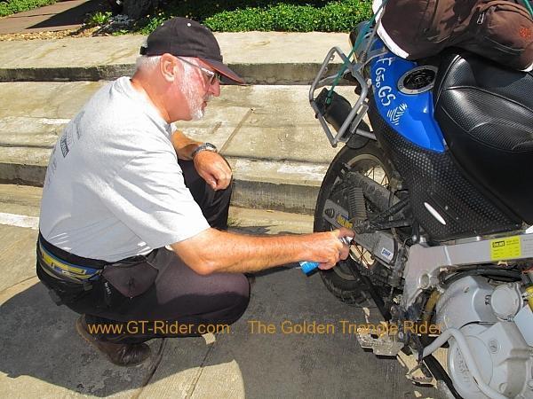

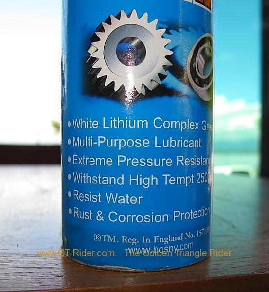

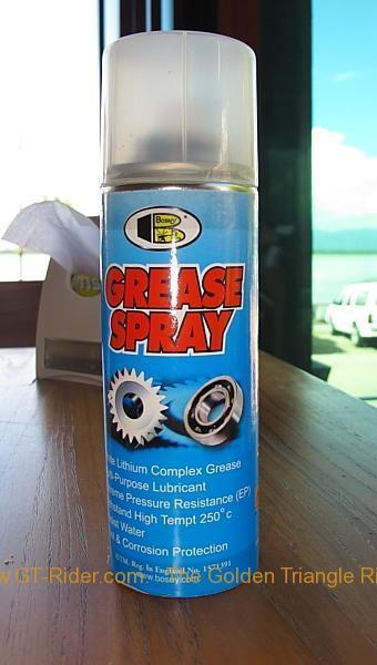

Whilst my AT has been off the road for an engine overehaul, Backdoorphil has very generously lent me his BMWF650 for use.
One of the things that Phil gave me to use with the bike was some chain lube....
White lithium grease in an aerosol can, sourced from HomePro I believe.
Does anyone have experience or ideas on this particular product, because I'm not convinced it is that great as a chain lube.
:idea:
wimpy
Jan 31, 2005
185
9
I found that stuff tends to fling all over the place. :(
