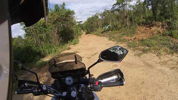

I recently installed the screen hoping it would be a big improvement over the standard on my Versys, but it offer nothing over the original. In fact, when the mic is placed in the helmet if i'm using the action camera, the noise at 100kph plus it much louder. I have tried various setting without success.
Does anyone use one and has it made a difference? Mine is on the highest setting on the fairing, and I did consider making some spacers to try and make the screen a little more vertical. But for 7500bht, it is dreadful thus far!

Just an update:
I raised the screen via the well nuts on the kawa, but by detaching the screen from the angled brackets I used 2 rubber faucet seals - one either side on the top fixing to make the screen more verticle. Made a big difference.

Faragit can you post a picture of what you have done with yours to make it better.
