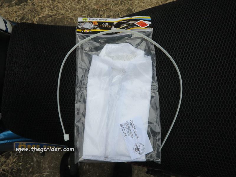

Now here's what you get in your kit

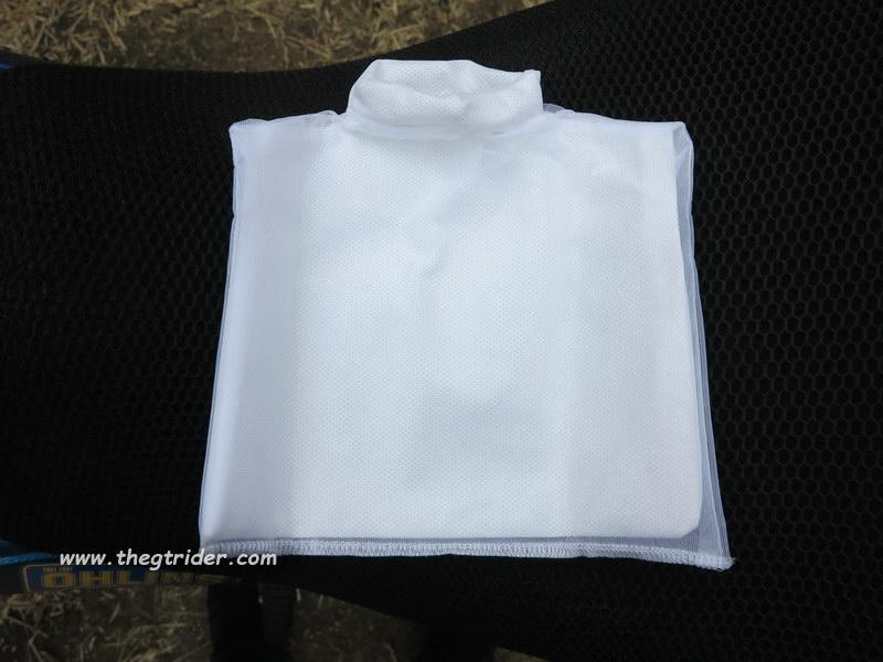

The filter bag

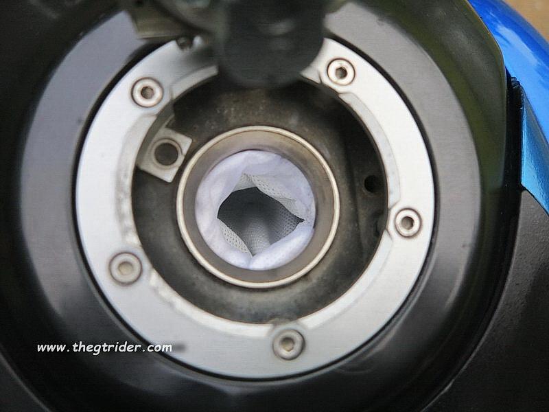

Into the tank it goes

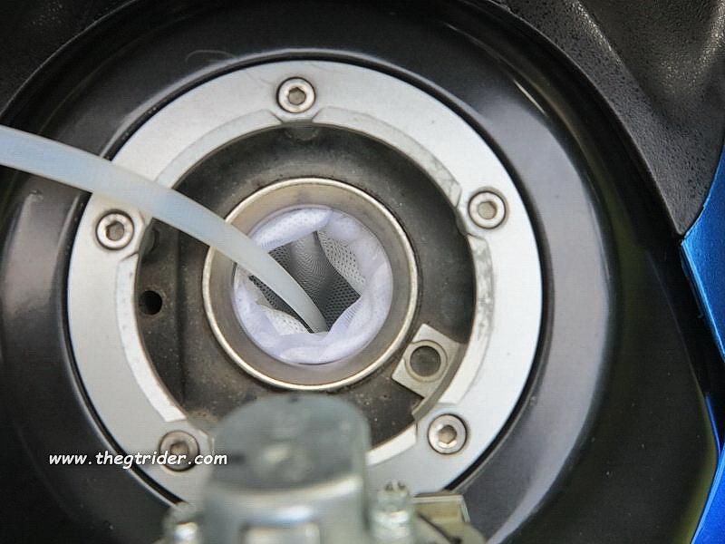

push the bag out with the plastic stick
How it sits below the lip of the tank inner
The filter bag

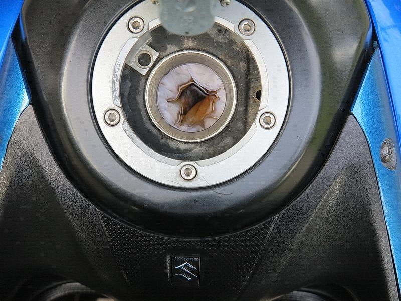

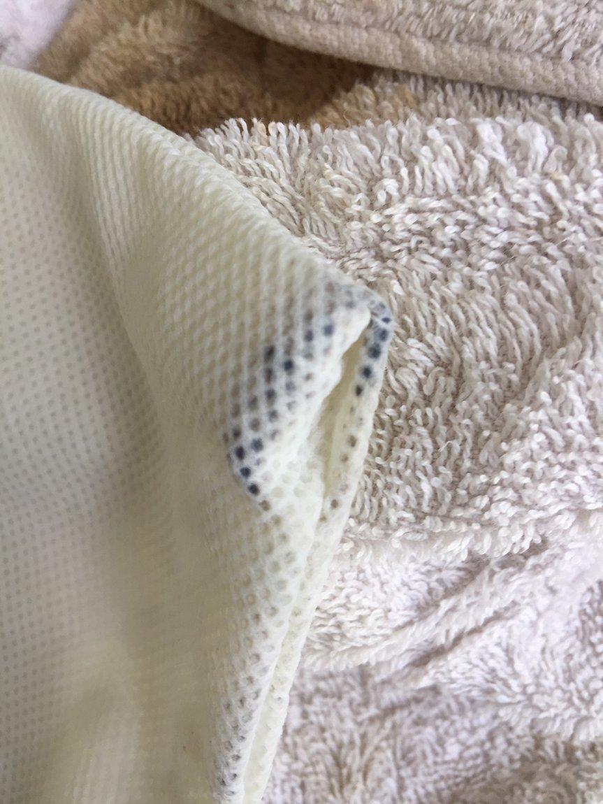

After only 900bht of fuel. Topped twice at 200bht and last week at 500bht.
You can see the crap in the corner of the filter. It feels quite hard when you grind with your fingers. Almost like tiny stones. Will cut the bag open soon.
This is from the same well know station. I filled up once at a station that has been established for two years. Another which opened recently nearer to me. So even with new pumps, this is possibly the result.

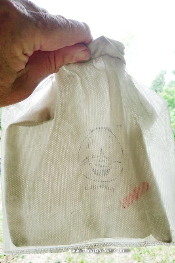

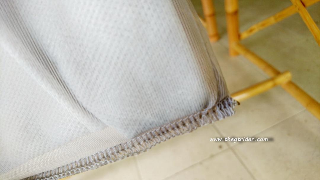

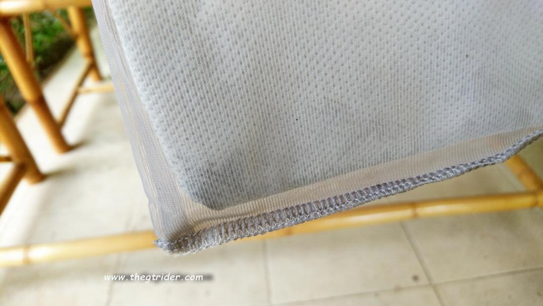

26,000 kms up on the Guglateh fuel filter & time for a look
Its definitely not a pristine white bag. In fact it is dirty as you'd expect,
The Bottom left & right corners have some sediment in there
Verdict a nice handy product for protecting your fuel injectors from rust & bad fuel, keeping everything as clean as possible & giving better performance.
Cheers Guglatech Asia.
