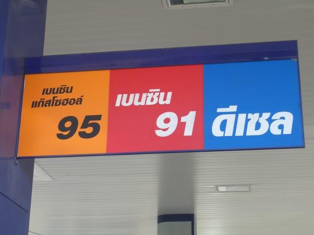

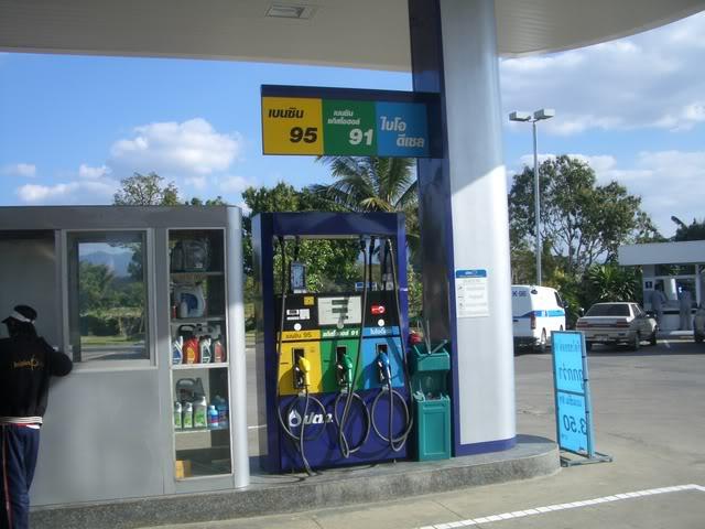

Now just to make things more interesting, some gas stations are now selling 91 Gasahol
Yellow 95 says BENZINE
Green 91 says BENZINE GASAHOL
Blue says BIO DIESEL
Orange 95 says BENZINE GASAHOL
Red 91 says BENZINE
Blue says DIESEL
Basically on 91/95 if only one word will say benzine, if 2 words will say benzine gasahol

Q. is there a diff. in colour between gasahol and benzine/petrol. Ie. when one pulls up usually they have red fuel and piss coloured?
