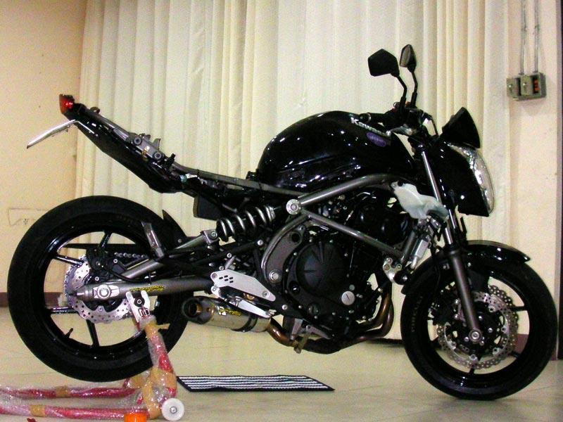

Well, if you've ever seen an ER6n / Ninja 650R you'll notice immediately that the suspension is very basic. Rear shock is adjustable for preload only and old school forks aren't adjustable at all.
I've got my preload dialed up as far as it will go but the spring is just too light so I'm going to try the YSS shock which should arrive next week and is adjustable for preload and rebound and springs are available in different weights.
I adjusted the sag on my Gixxer K6 using the Keith Code guide and I think I got it pretty close to where it should be. If/when we meet I'm sure you can teach me a lot more about suspension set-up and I'm quite a novice. I had a CBR600F2 (fireblade) for years and the suspension was adjustable for pre-load, rebound and damping but to be honest I never fiddled with it as the bike handled great from day 1 with the factory settings.
The Arrow exhaust on the ER6 is temporary until my new TWO BROS arrives. The TWO BROS is smaller in diameter so I should be able to get more clearance. Here's the TWO BROS vs stock can:
Here's the Two Bros on my old ER6n:
The rearsets I've put on the new bike give me a lot more clearance, so combined with the race slicks it will be interesting to see what touches down first- pegs or can or.... me? :mrgreen:

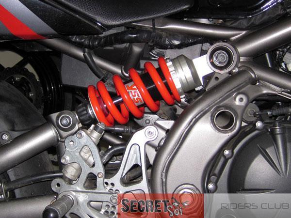

Finally had a chance to install the new YSS rear shock but with all this damn rain I've not yet had a chance to try it out... :oops:
Installation is incredibly easy. Took about 5 minutes.
So now I've got a progressive spring and rebound adjustment :thumbup:
Looking forward to trying it out when the rain stops!

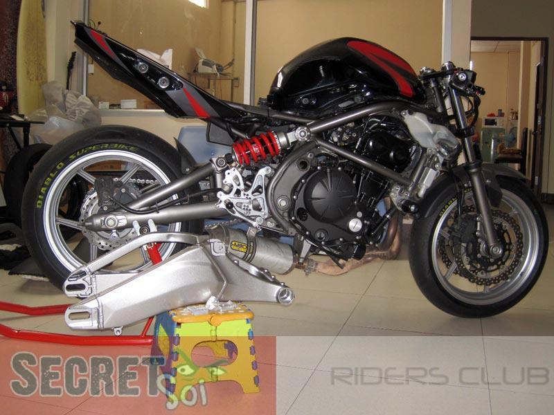

Next mod- Versys swingarm on ER6n!
Hope to have it ready to roll for the Kawasaki Track Day at BIRA Circuit on December 18th.
