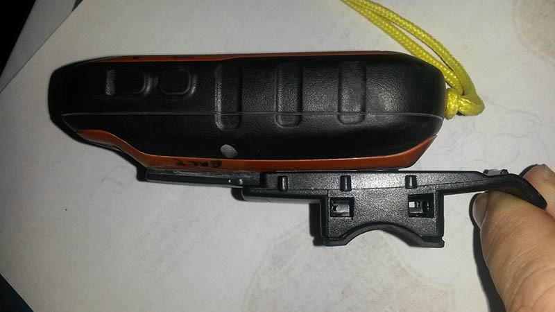

Ive had the Garmin 60CSx for about 7 years and had no problems with it. Its compact and robust.
The screen is small but I don’t mind it. I cant compare it to anything else because it’s the only GPS I’ve ever owned. There’s newer models available now. Maybe 62CS
Pretty compact as you can see.

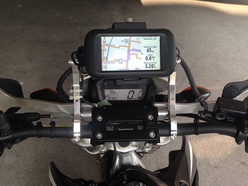

Hi Brian this is how I mounted my Montana to the bars on my CRF, it really is good because it places the device up over the display so you don't need to drop your head to see it. The amps rugged mount is bomb proof and wont come off, if you don't want to run power form the bike get the bicycle mount https://www.gpscity.com/garmin-montana-6xx-bike-mount.html NB: without power from the bike you'll go through 2 sets of 3AA batteries each day.
Here I have made a plate to attach the rugged mount http://www.gpscity.com/garmin-montana-6xx-amps-rugged-mount-with-audio-power-cable.html
I then attached this to the Rally Management Services nav mount Universal Navigation Clamps (click link)
Using cross bar mounting blocks Crossbar mounting blocks (click link)
