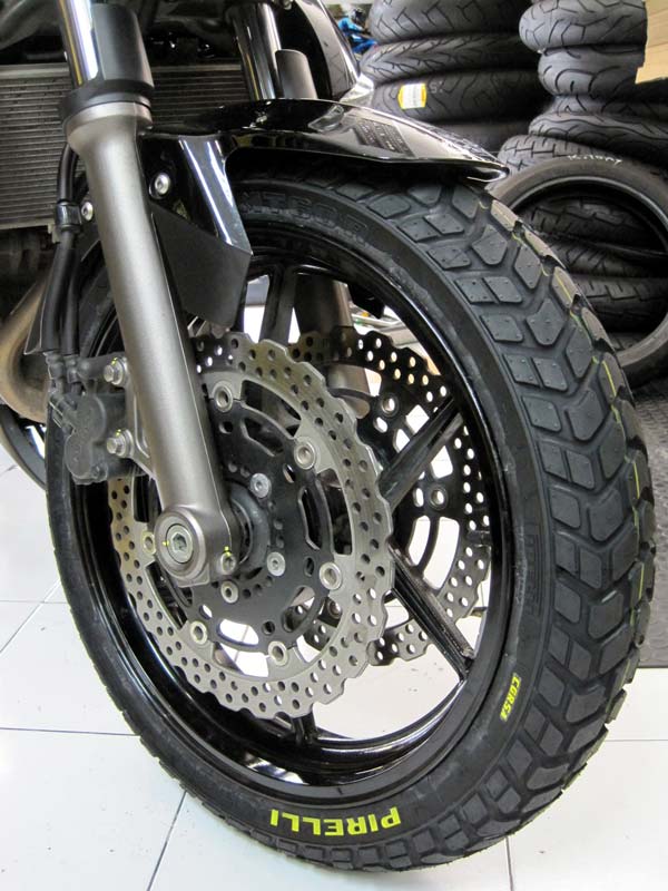

If stock suspension settings work for you then I agree, no need to mess with them. Sounds like you've ridden an ER6. I'd recommend you rent a Versys some time so that you can see how much better the suspension is. I've owned a couple ER6's and a Ninja 650R and couldn't believe how much better the Versys handled when I rode it off the showroom floor.

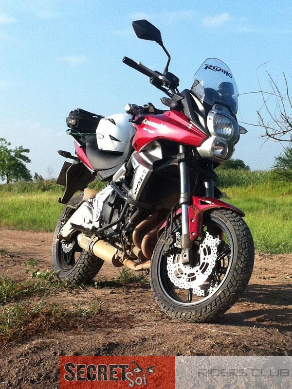

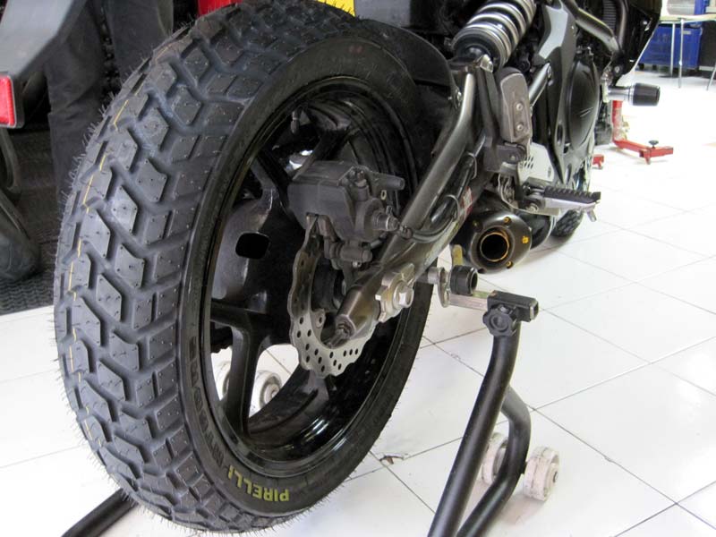

The Pirelli MT60RS Corsa's are great dual purpose tires BUT they wear very very fast on pavement. That they were originally developed as a wet weather tire explains their short life on dry pavement. I'd recommend the MT60RS Corsa if you ride mostly off-road. But if you ride mostly pavement you can expect the rear tire to not last more than ~5 or 6 thousand km. Pretty short life for such a pricey tire. They do look the business though ;)

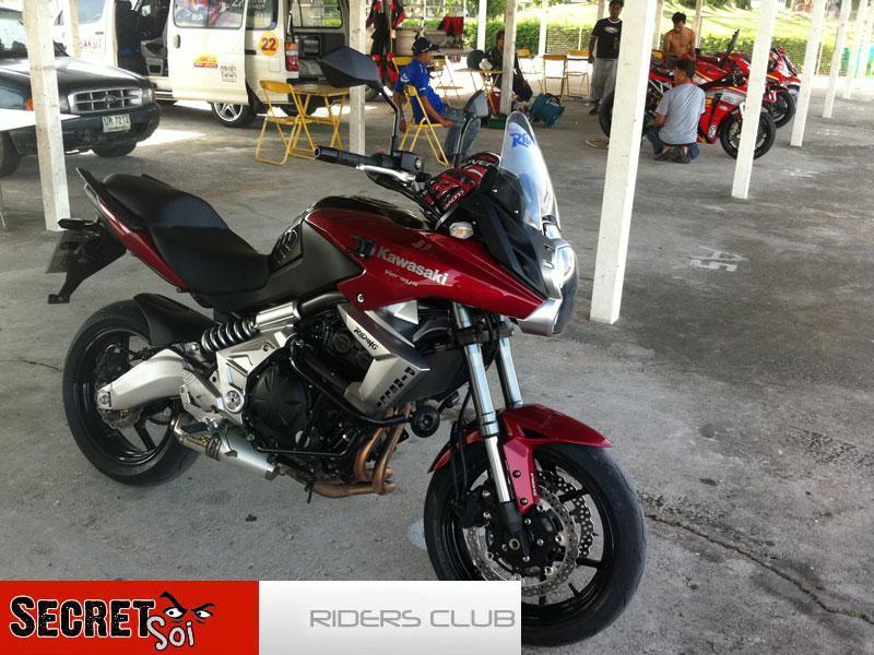

Ha, just realized the pics above are from my old ER6n, but anyway, same same but different ;)
I have two sets of wheels for the Versys and use the MT60RS Corsa's for off-road and have been using Scorpion Trails for road, and hit the track with Supercorsa's once. I'd quite like to try the Avon Distanzia as I've heard good things about them, they're cheaper than the Scorpion Trails, and are said to last longer-
