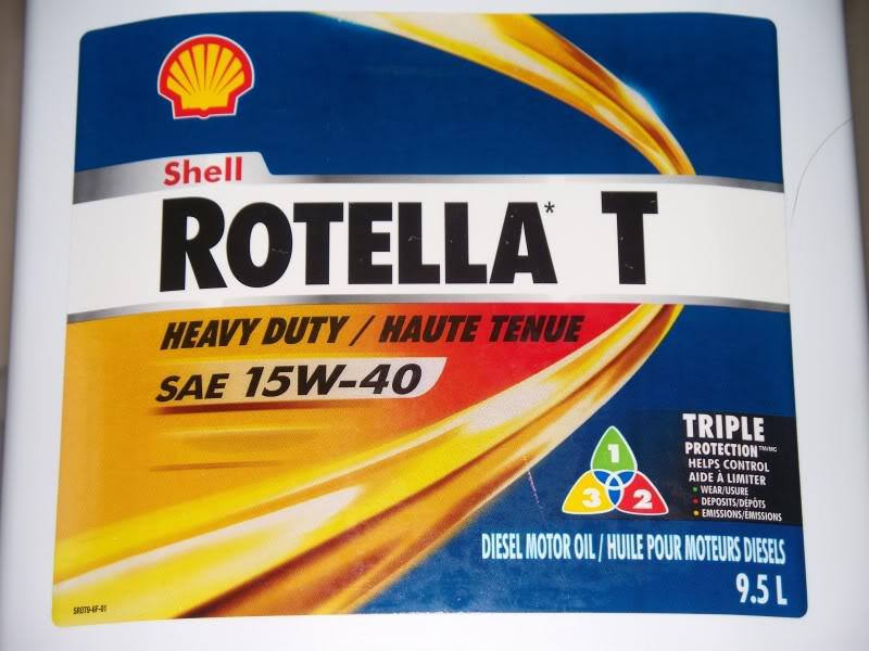

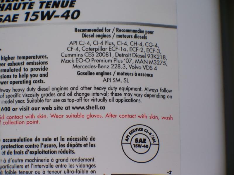

Hi All,
After blowing the tits out of my clutch ive found out that Rekluse recommends Shell Rottela T Heavy Duty Diesel Engine Oil 15W-40. After researching some more this oil seems to be used quite widely in motorcycle engines. Unfortunately Rottella can only be found in the United States of America! boooo. I had a trip round to the local Shell Station and they had in stock the below products.
900 Baht for 6 Liters
650 Baht for 6 Liters
Fully Synthetic 2,400 Bath for 6 Liters
In Australia particularly this question is asked a lot, and there seems to be conflicting views whether its the same stuff. I had the wife phone Shell Thailand but they were none the wiser as usual.
So anyone had any experiences with using Diesel Oils with your motorcycle, specifically Shell Rimula X??? or seen any Rottella T anywhere
I have also found out that its quite common for Yamaha OEM clutch friction disks to fail with Rekluse clutches. The move to Hinston or Rekluse items hopefully will prevent it happening again in future, hopefully!

Consensus here is that the Helix Ultra is the closest match to the Rotella T Synthetic here in vis, base oil type, and additives. Search bobistheoilguy.com for more info. The Rimula is a bit of a mystery???? But your concern about OEM Yamaha clutches being picky is justified. For the first oil change on my new FZ1 at 50 miles, I used Mobil DELO 15W/40 non-synth diesel oil as a break-in oil. The FZ1 OEM clutch did NOT like this oil at all and would actually "stick" and remain engaged for several seconds even after the clutch lever was pulled in. Then it would release the gearbox tension with a little clunk and be free. So the oil's frictional properties seem to be an issue with some of these plate compounds.
At first I thought it was just an adjustment issue but after checking things and all in spec, I started to suspect the oil. Drained it out and went with the Rotella Synth 5W/40 and worked it into the plates a bit in the garage before heading out. Was still a bit sticky for a few miles but eventually all was well and remains so 2 years later. So I would go with the Helix, whether synth or non-synth really depends on how long you want to go between drain/refill.

My take on this was that Rimula is Rotella sold in different markets as they don't seem to be available together. Although it did say some years ago that Rimula is not suitable for caterpillar engines. Don't know why.

First, may be you can use Shell Rotella T6 5W-40 into yours bike because that is pass JASO MA but Shell Rimula R3X, Shell Helix HX5 and Shell Helix Diesel Ultra are not pass JASO MA(wet clutch slipping)
We have Shell Advance Ultra 4T 10W-40 (JASO MA2) available in Thailand.
Please find more info from yours book service bike for oil recommendation.
