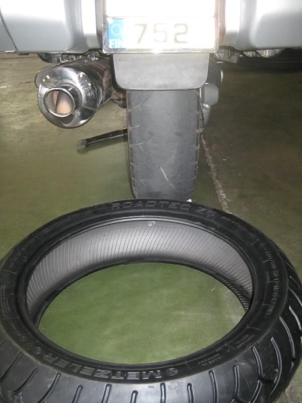

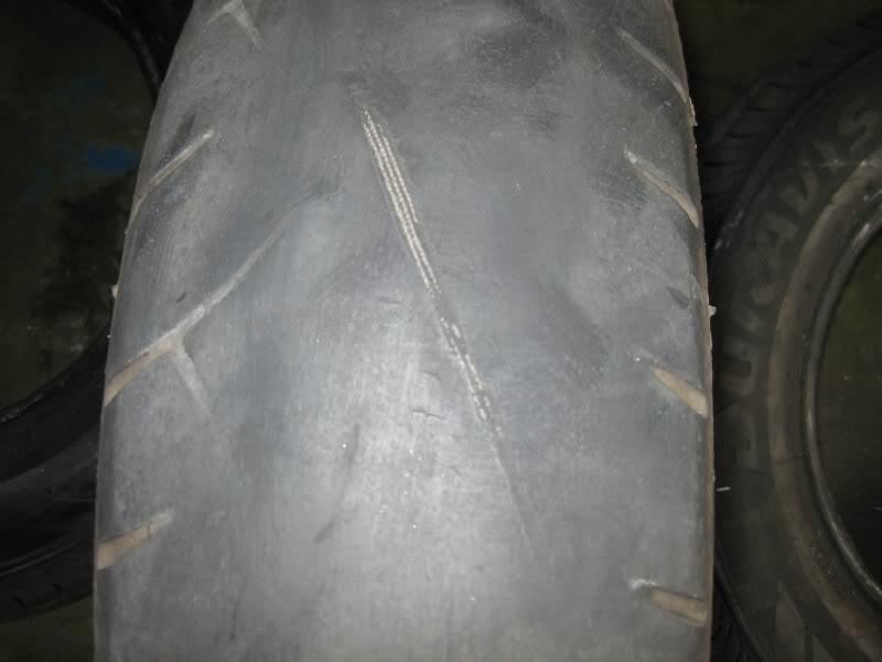

My back tyre last 24840Km
Marco
Oct 15, 2006
1,695
7
58
Khuang Nai
Hello Lads
Just desided to to put it in here as it's beemer.

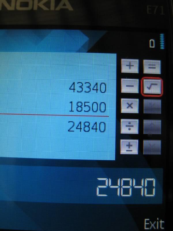

Tere has been a lot's of talking about how much one can get on his rear tyre and now it was my LT's turn to get new rubber
I got 24840Km on it.
Pictures will tell the tales
when i got the bike it has 15000Km, changed new back tyre on 18500Km on the meter and now again,,,
have to say it has done well considering that bike weights 420Km+me 120Km=Half of the Metric TON :wink:

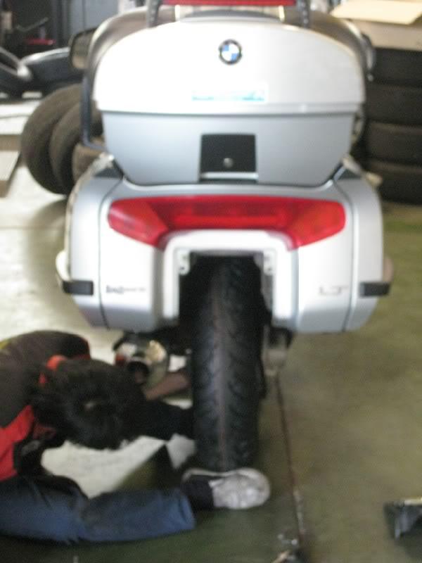

Changed in Chiang mai Cockpit station on the Airport road just opposite f Honda Dealership.

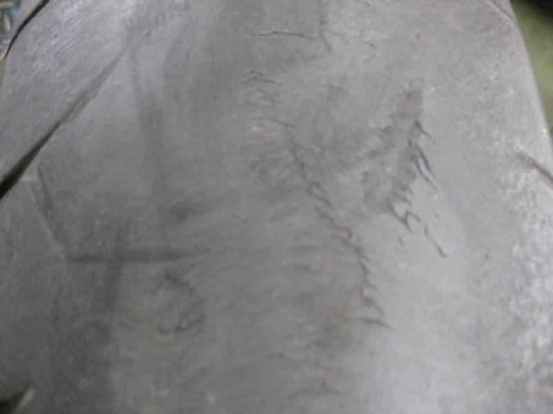

I am amazed that anyone would ride a bike that had a tyre in the condition shown in the photos.
A big heavy bike like that ridden in the hot temperatures of Thailand fitted with a tyre that has worn through so far the inner belts are showing is just asking for a sudden failure and deflation.
Even if the bike is being ridden sensibly and at relatively slow speeds the temperature and the pressure inside the tyre could increase enough to explode the tyre.
A tyre blow out on a motor cycle is a scary event and will usually end with the loss of control of the bike and a subsequent crash. I have experienced this before during my racing days on slick tyres that chunked and blew out. My slick tyres were almost new and not in the condition of the tyre as shown in the above post.
In my case, it is not worth the money saved to get an extra couple of thousand kilometers out of a tyre compared to the cost of repairing the bike and possible injuries to one self.

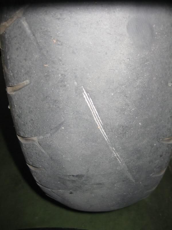

I am using Pirelli Diablo Super Corsa SP soft compound tyres. I change my tyres once the tread depth is below 2mm.
Even slick tyres have wear holes to show when the useable surface area is gone.

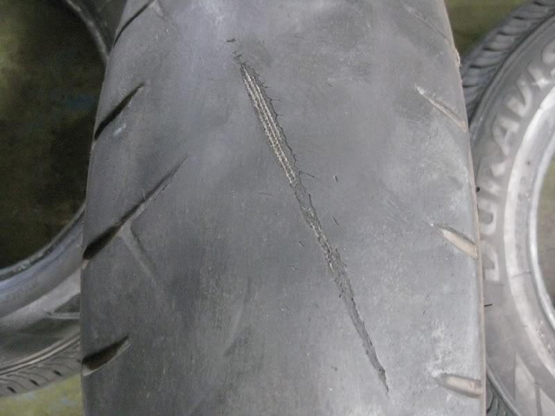

As I spent four years doing some research into new tyre rubber compounds, it is worth pointing out that there are at least 5 and maybe more rubbers with very different properties, contained in every motorcycle tyre.
The Wear layer is formulated of course for good wear and grip, a compromise, as they are not compatible properties which is why soft grippy race tyres do not last long, and hard wearing tyres do not grip so well. The road tyres most of us buy however have good wear and enough grip for most road conditions to exceed our confidence or ability.
Brian who is race track trained, buys a much softer grippier compound and is prepared to accept the shorter life.
On a motorcy tyre the wear area on the outer edges of the road contact profile may be a grippier compound which blends into the harder central compound. The sidewall compound is not good wearing, but has excellent flex behaviour and low hysteresis, or heat build up. Under these layers is a bonding layer that ties the wear layer to the fabric and steel (if present) reinforcement. Once one gets anywhere near the fabric it will wear very fast, it is not designed to touch the tarmac. Under the fabric is a butyl layer which has very low permeability, this there to prevent air loss. All these layers are generally fabricated and layed up by hand before the rubber is put in a big hot mould to vulcanise or cure it.
So apart from the legal tyre limits, which are not observed over here, one cannot go too far below the indicated wear marks before the tyre will start to wear down a lot faster. It also will not grip as well as the under layer does not have good wear or grip properties, just good bonding and stress transmission properties.
The top rubber is the most expensive and the maker does not put on a thicker layer than he has too.

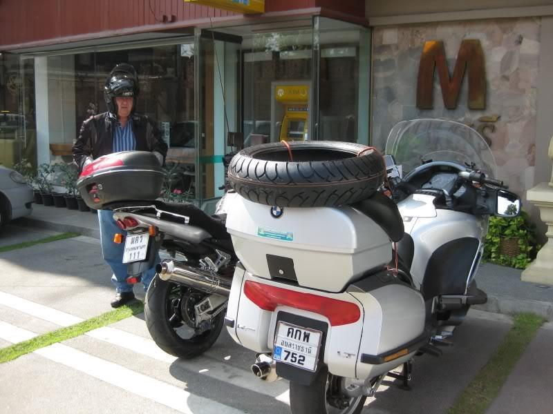

The Rear Metzler Z6 on my Ducati S4 in Thailand has just expired at 13,966km, there is actually loads of tread still on the tyre ,probably another 5000km worth but it has swelled on one section near to where it was plugged by me after a puncture at about 3000km use and so its got to be replaced, but the previous Michelins Pilot Sport only lasted 8560km . The tyre has a hared workout over the last week getting 2700km on it at high speed on my run round thailand
I am replacing it with a Pirreli DiabloCorsa111 which is same as the Metzler and made in same factory.

I don't think those Z6 are load rated for the LT. If you're running the 160/70R17, they are 73W. About 70 kg under what is specified as you need the 79 load index on that big boy.
If you ride mainly solo, probably OK. But if you are loaded down with a passenger, you're over the limit and could be trouble.
I had this problem with an out of town dealer that put the wrong tire on my LT after we had a puncture. I didn't know he did this until I got home and looked at it. Normally, I ran the BT-020 but he didnt have it so had to go Dunlop just to get us home.

Marco,
Auke's chart explains it well and can see the 72 rating is more than 80 Kg under what is supposed to be on the bike. You have been running on the 72 rated tires and had no problems because you have not loaded it heavy along with a passenger. But if you were to do so and go on a long tour, I would hate to see you have a tire failure while underway due to overload, very dangerous.
This is what the US based LT site says is recommended:
"IMPORTANT NOTE: The LT is a HEAVY bike and requires special tires. Do not buy just any ME 880s or BT020s in the same size as your current tires. You must buy the LT specific tires with the following size/part info:
Metzeler ME 880
Front Tire: 120/70 B17 M/C 58V TL ME880 Marathon Front - 2.50 BAR
Rear Tire: 160/70 B17 M/C 79V Reinf. TL ME880 Marathon
Bridgestone BT020
Front Tire: 120/70R17 BT020 BW TL M 58V V 23.8 4.7 5 520lbs 42psi 3.50
Rear Tire: 160/70R17 BT020 BW TL M 79V V 25.9 6.1 8 963lbs 48psi 4.50
NOTE: These are the "V" rated tires. The "Z" rated tires are not load rated for the K1200LT!"
http://www.bmwlt.com/forums/faq.php?faq ... labletires
I noticed right away when the dealer put the wrong tire on. The 79 rated Bridgestones were always very solid and stable. The lower rated 73 Dunlops were terrible and the bike felt like it had a broken spine and all squirrely. I think you will find with the proper load rating and stiffer sidewall, your LT will handle so much better.
Try the BT020 Bridgestones if you can find them there, or the ME-880. The ME-880 is not as sticky, but over there in the hot roads/climate should be no problem to get them to working temp quickly.

That new 170/60/17 is about 20mm smaller in dia than your old 160/70/17 (if that's what you had on there) and therefore spinning faster. I'm surprised you are not getting an ABS fault light due to front/back speed mismatch to the ABS computer.
Also, I'm almost certain that Z6 is a radial. You may have a bias ply Marathon on the front. Mixing a bias and a radial on the same bike is bad news and can cause all kinds of strange handling on any bike. Even more so on a monster like the LT.
Do what you can to get the proper Marathon back on there to match the front ASAP. The Z6 is a light sportbike tyre and is totally outmatched on that LT.
