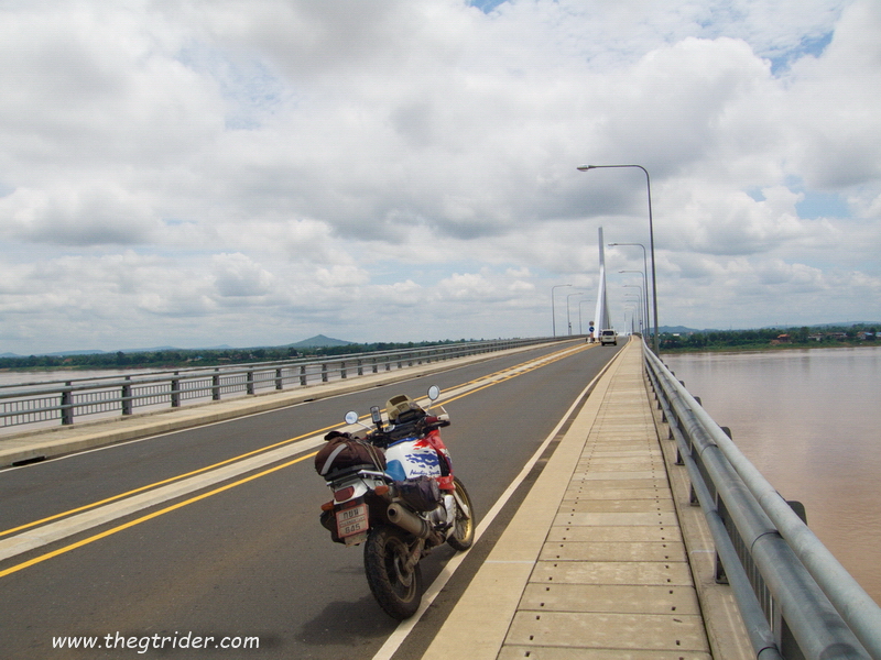

Exiting Laos across the Friendship Bridge from Savannakhet was easy & straight forward.
Entering Thailand at Mukdahan was almost the same, but with one minute hiccup.

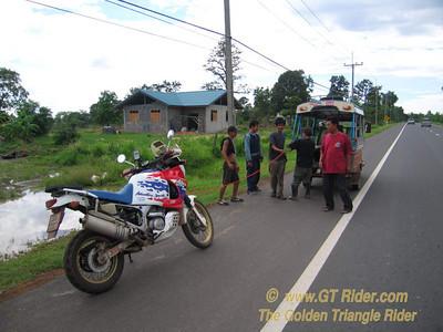

Then 30 minutes in Thailand, at 135kph the bike suddenly shut down – no electrics. Beautiful I thought, here we go again a replay of the previous year’s nagging electrical problems? At least it was not in Laos so I though good luck whatever the problem, the bike’s broken down in Thailand.
It was bloody hot out on the super & fortunately 50 metres up the road was a little house with some shade. I pushed the bike along to the shade, unloaded everything, cursing politely as I went.
The saddle bags have to come off to take off the side covers to get to the fuses, plus the bag has to come off to get under the seat & check the battery.
It was hot, I was pretty grumpy but my new rural hosts were very jovial & incredibly generous – bottled water + a can of Beer Chang was even offered. I took the water & declined the beer – I was not quite in the mood for a hot beer in the midday sun. :x

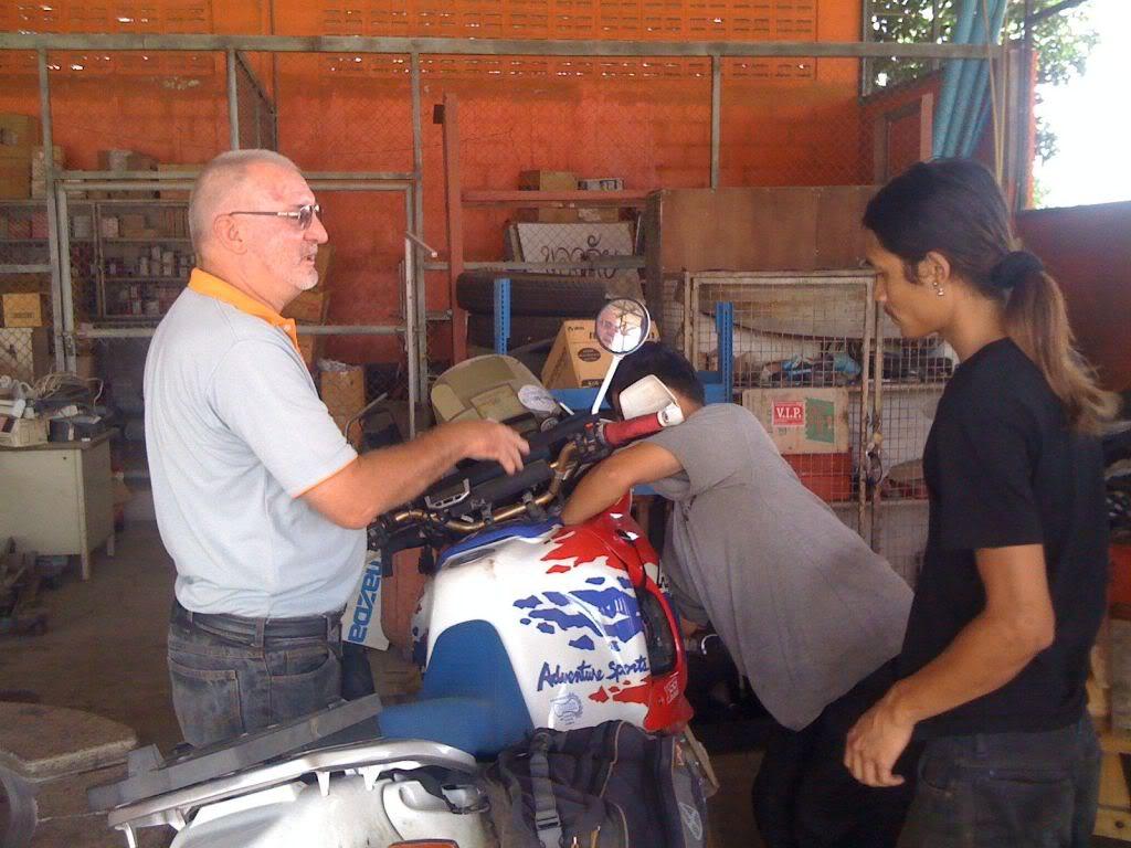

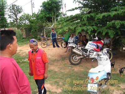

Under the Ajarn’s supervision the students swarmed over the bike excitedly yapping & joking away madly. They must have though Christmas was here early. :lol:
After getting them to check it out systematically fuses / battery, the ignition switch was the next step.
And lo & behold
Yep broken wire again.
No problem, solder it all up & get a pretty good warranty “I guarantee all my life” & a big cheer goes up.

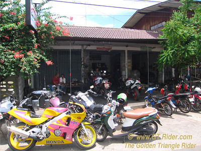

We locate the shop
Daeng Charoen Yon
15/7 Senaroemkid Road
Ha Yaek Sai Nam Phueng
Amphur Muang. Roi Et
Mr Krisda Muangwong (Khun Daeng)
Tel 0810600849. 0894217999.
I explain to Daeng what the problem is & would like to install a new switch if we can find one that will fit.
No problem. In 40 minutes the ex-trusty old Africa Twin is parked in the shop, after Daeng follows us to the PTT hard wires the bike & we ride it back to his shop.
Another 1 1/2 hrs later it is all go.
As a precaution Daeng installs a new relay to control the ignition switch power & prevent it from overloading & burning out.

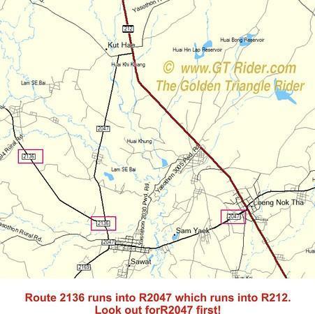

The problem with finding R2136 off R212
You have to look out for R2047!

Hi David,
Great report and pics and bring back memories of what started as a frustrating day, but ended up a suprising and great fun day and night out.
I realise looking at your posting and map that the turn to the 2136 is not easy, I had done it reverse direction and then its well signposted to Yasothon or Mudkahan. Sorry for that, but it occurs to me that you seemed to end up where you were supposed to be to get the approriate help. Is that not part of whats so great about this country. Somehow it just works out, as it did and on the way you meet some great people!
Just a couple of phone pics to show you in the shop directing things.

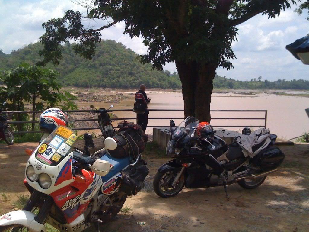

The next morning whilst loading the bike up carefully, looking for loose wires or whatever JG arrived on his FJR1300 for the run alongside the ’Khong to Loei. JG & I had been in constant SMS contact for several weeks, trying to co-ordinate so that we could actually do a ride together. It took quite awhile to set up, but the wait was worth it.

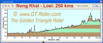

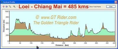

It's 250 undulating kms from Nong Khai - Loei
Right John?
Plus 485 kms from Loei to Chiang Mai
Not sure who won that one John, might be 50/50 I think I was claiming 400 & you were 500+
