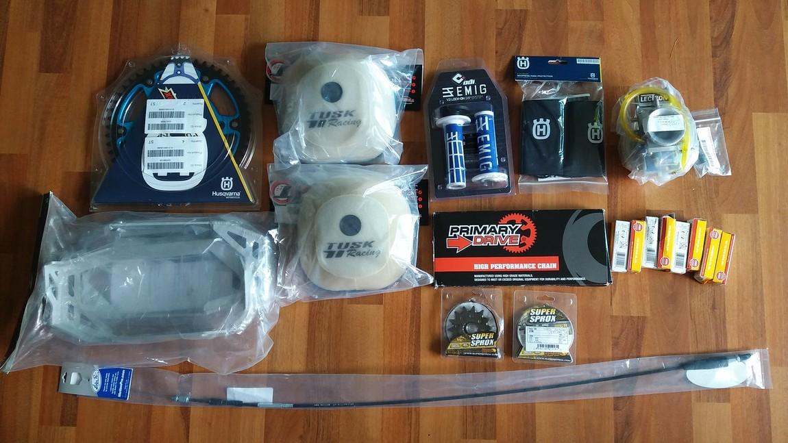

Parts
2016 HUSQVARNA TE 300 Parts and Accessories | Rocky Mountain ATV/MC
Carb
Lectron Adjustable Power Jet Carburetor Kit | Dirt Bike | Rocky Mountain ATV/MC
More to come on this as it unfolds...

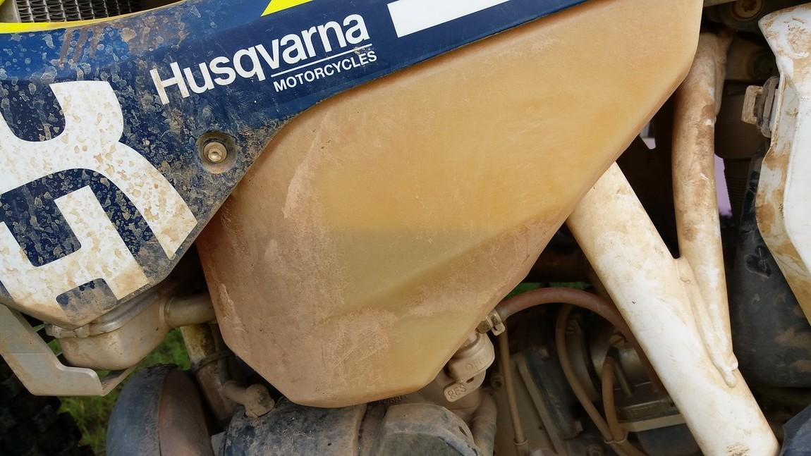

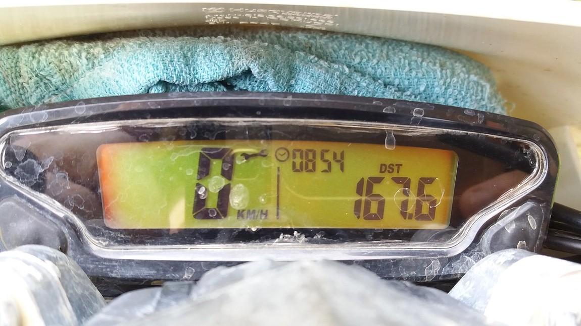

Mileage update:-
Who would have thought such a difference.
Out riding Sunday...
After 27 km.. Stop and dump in the 1.5 litre premix I have stored in my camelbak..
Brings the level back to almost identical how I left earlier. Full, minus 1 centimeter.. may be less..
Today's ride.. 167.6 km.
Still have a good chunk of my reserve.. Easily reach 180 km on a tank plus 1.5 litre top up..
With out the 1.5 litre top up.. Trail riding / Exploring riding.. 150 km before dry.
Previously in Pattaya.. flowing ride with some technical.. getting 80 km.. Lets add extra 10km as more technical and slower going .
Impressive, how ever you look at it..
Runs better, smoother, using less fuel.. Predictable..
No downside so far..
Winner winner.
Brian
