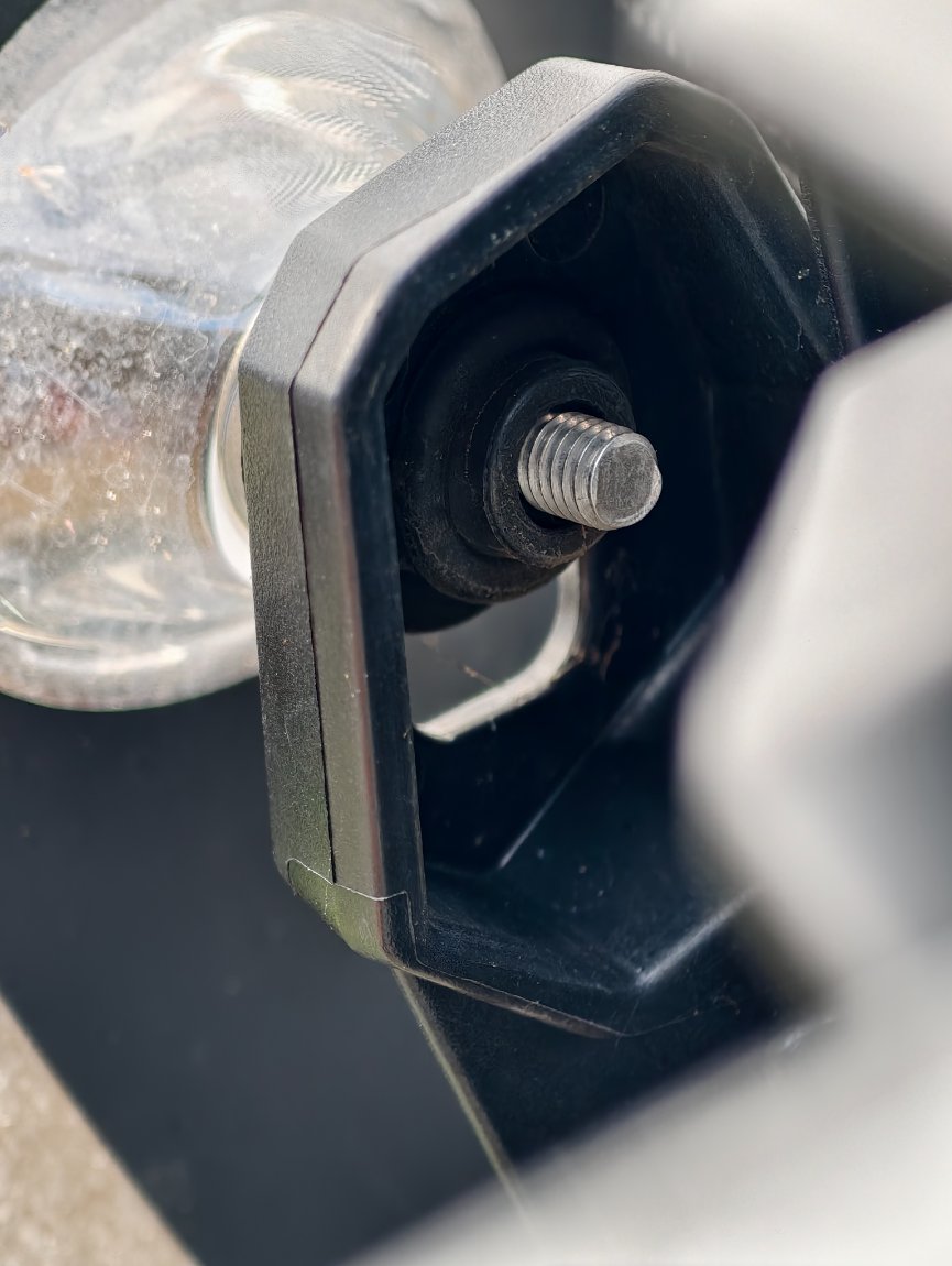

With the front screen banging it sounds like the screen rubber gromits that the screen securing bolts pass through have slipped down from their correct position.
The purpose of the the gromits is to stop vibration and also allow the screen to come off the scooter in case of an accident force on the screen.
The incorrect position will allow the screen to make direct contact with the plastic frame that carries the screen.
It happened to my screen. It's an easy fix yourself. Its just a question of undoing the screen securing bolts, sliding the screen down and off being careful not to loose the gromits. Once this is done its easy to see how the gromits work and their correct intended location.
Reassemble and tighten enough to secure the screen but not enough the compress the gromits out of shaped, as this would affect their purpose.
Here is a photo of the gromit bush in the correct position....the hole that the gromits bush fits in is like and inverted classic key hole.... Put gromit bush into squircle hole and slide up into the slot and then tighten fastener.
If the gromit bush drops down and starts vibrating and banging around in the big hole it will wear out pretty quickly because its made of very soft rubber.
