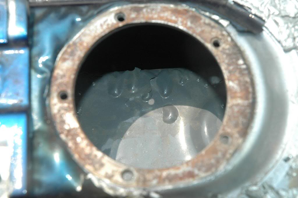

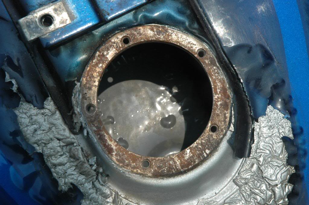

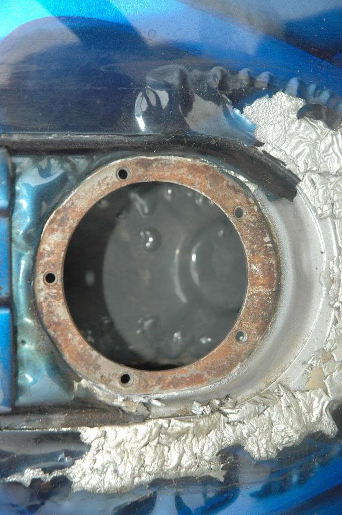

My Harley gas guage gasket leaked and ruined my custom paint job, so what better time to strip to bare frame and redo it all in one go. While not visible through the filler cap, once I removed the guage, I noticed that the stock factory fuel tank lining had began to blister and come off.
Harley approves of E-10, and since I have high compression, I have no choice but to tune the bike to run on Gasohol 95. It has been running on E10 for about two years since petrol 95 became difficult to find.
Now what to do? I have a Kreem tank cleaning and coating kit that claims to be alcohol resistant, but how to remove the blistered factory coating. I know about putting nuts etc into the tank and rotating it, and Richie could shot blast what he can reach, but I am not convinced that this will work.
Maybe hot tank it in a rad shop if they have such a thing here?
Is Thai fuel really E-10 or E-10+++

My tank is steel with a factory lining
Richco Powdercoating can dunk the tank and eat it clean inside and out. I then will coat the inside with "alcohol resistant" Kreem coating from the USA and see what happens.
In any case now that we have good old 95 again that is what I am going to use so another round of carb tuning is in the cards.
