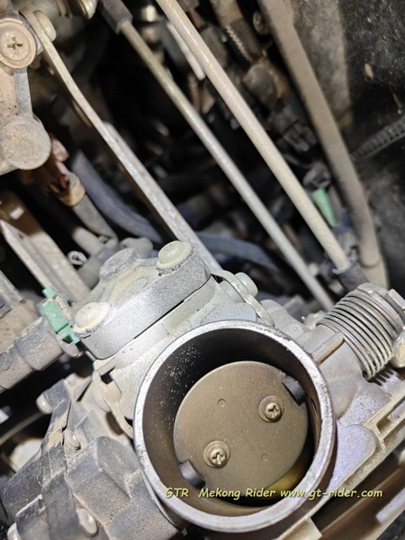

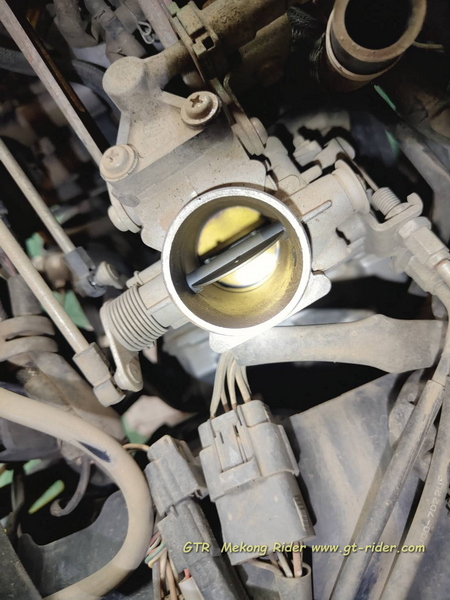

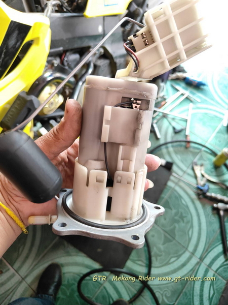

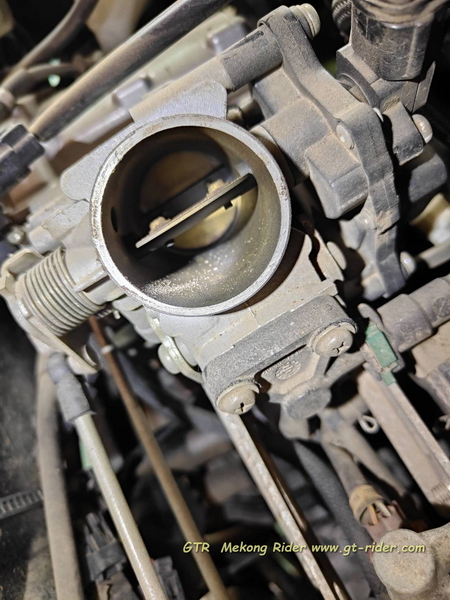

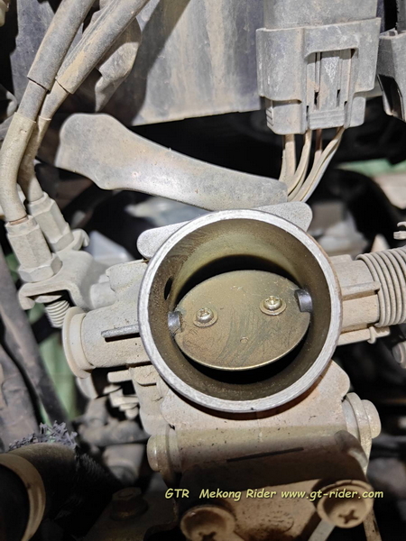

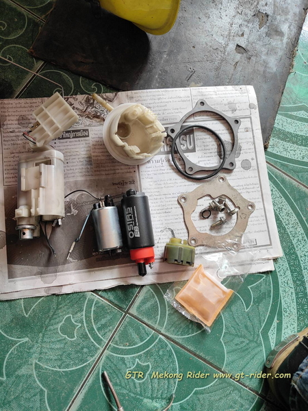

Kong, the V-Strom, Chang, & I all thought maybe a fuel pump issue.

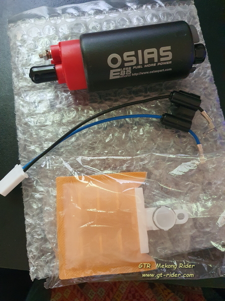

But Kong did not want to strip down the tank until I had another V-Strom fuel pump ready to swap over.
I promptly ordered one from AliExpress for 500 baht, it turned up in 10 days, and it didn't fit. Oh well.
We cleaned the fuel pump and filter.
We replaced oil ring seals & cleaned the fuel filter that was dirty with carbon.
We cleaned the fuel injectors.

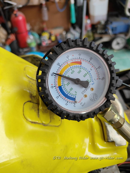

The fuel pump pressure was within spec.
Everything is back together again, but I suspect the problem is not resolved.
