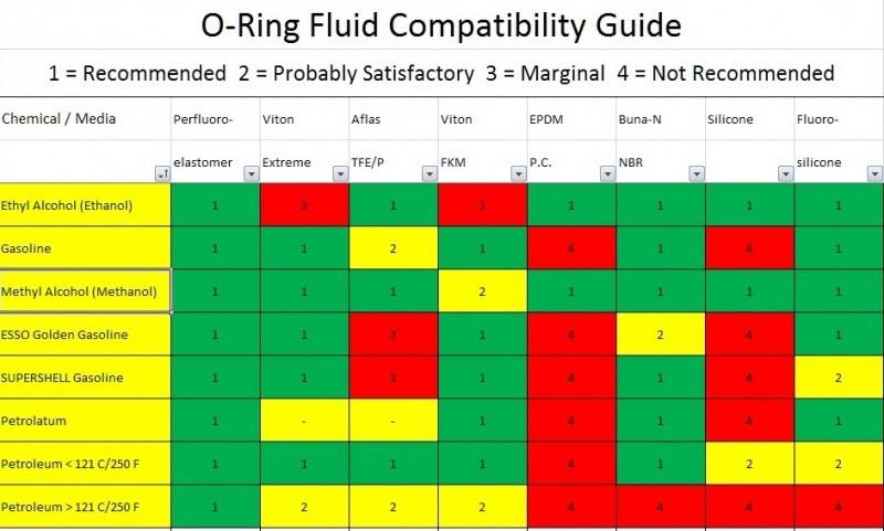

monsterman;283093 wrote: ...... will not run on gasohol even with so called VITON Gasohol friendly carburettor kits ......
According to the attached table, VITON is "marginal" in its compatibility with gasohol fuels (ethanol) while it's fine with petrol. Perhaps these kits are not all they're cracked-up to be. Looks like there are better materials than VITON but finding kits in those materials might be tricky.
The table's not mine - I saw it somewhere & thought it'd be a useful reference.
The table is extracted from the listing in this link http://www.allorings.com/compatibility.htm which is itself based on quite extensive research, I'd imagine.

thanks for the tabkle it will help my research , from chatting with American pals who have fitted kits to older bikes in USa the viton which seems to be the most common synthetic rubber used holdsup reasonably well to USA 10% spec gasohol , but it seems the Thai blend is more corrosive probably got laokhao, chemical waste and somtam in it .
BUNA seems the prefered choice in the classic bike world for upgrades so I will se if I can get some bits for my wife bike in BUNA , but this will be too much for up country Thai shade tree mechanics and farmers to get their heads around .
